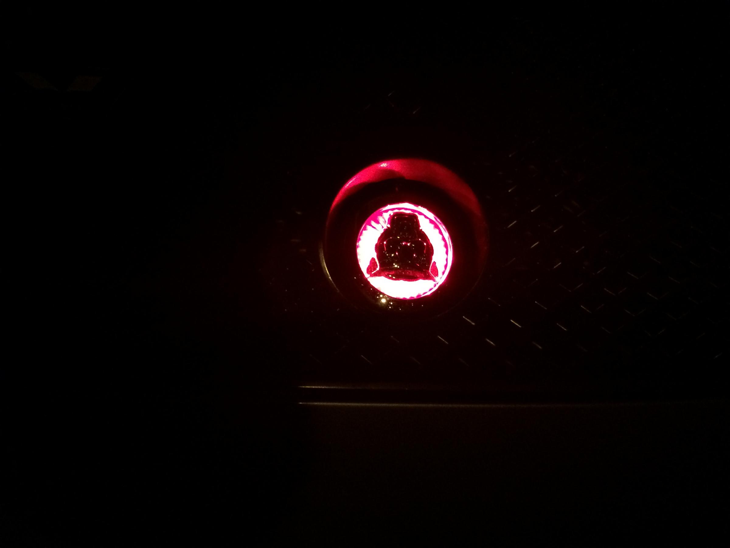

Default Here's mine, I did this in 2013
Not as good in pictures, better in person, I can help out if you are in new york, i can do it for you if you want, just send me your email address @ franckrandria@me.com

sorry the first pic is upside down, dunno why.

The screen you said!! I custom my self, i made a hole on the bumper almost like the XFR 2014 then bought a grill and the surroundding.
The emblem has tocome out, buy LED color of your choice-take the emblem apart, glue or solder the led around the edge then sick the round chrome Jaguar piece on top of the LED, wire it up using the parking light and ur all set.

Thanks! You say LED, is it a pucket, ring, or a certain one that you used. Do you have a link or pic of what type of LED.

I used a strip led from Autozone, cut it and stich it. I got the ones that light up on the side, not the one that lights up on top.
