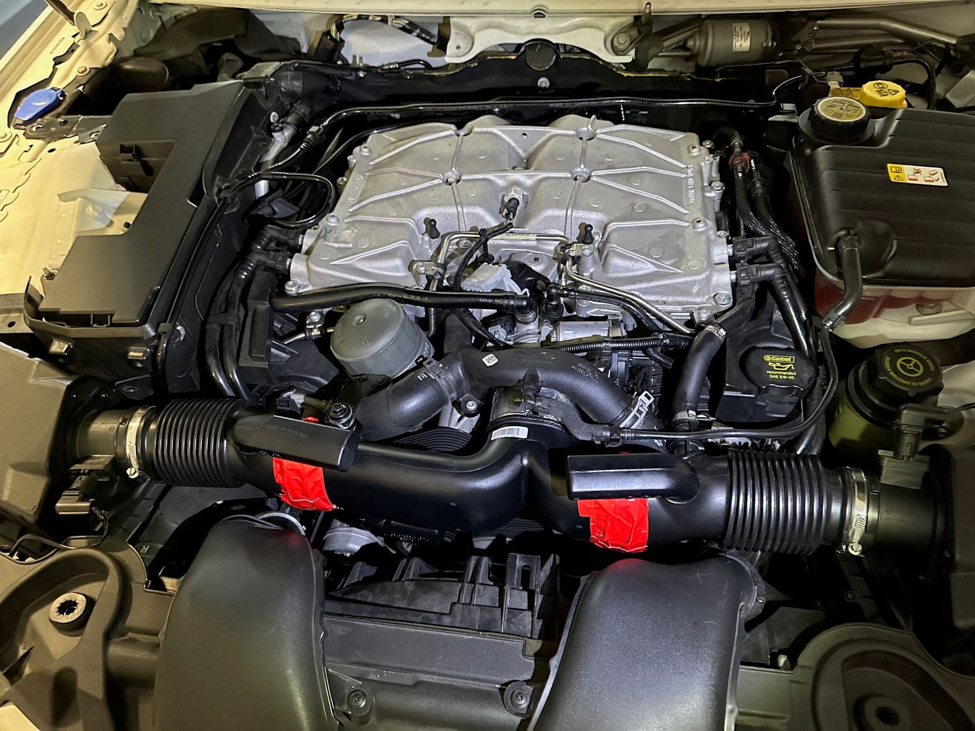

I purchased a smoke machine and two intake bladders to seal both intakes and tested the vehicle injecting the smoke from the passenger side.
I noticed no leaks other then the intake tube itself. Minor leaks coming from both the passenger tube and throttle body connection but a LARGE leak coming from the driver side tube. No amount of torque or reseating can fix it. Visually I can see nothing wrong with the tube. It was purchased May 2022 from a dealer but after I installed it I noticed it was old stock, 2017 mfg date.
I talked to a JLR tech who told me some minor leakage from the intake connection points is normal but it seems my intake is defective, any thoughts?
I also had my purge valve disconnected at the fuel tank side during smoke test and verified the valve is good, with no power its closed.
Smoke test below

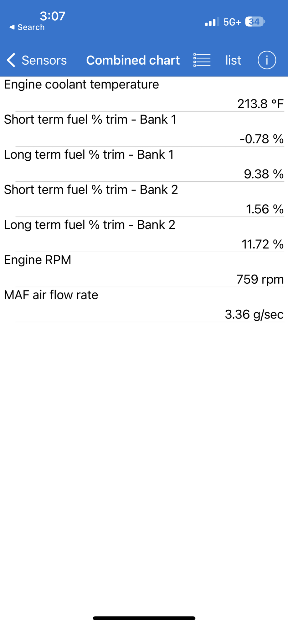

I duct taped the joints and went on a 18 mile test drive.
For the first half I had significant decrease in long term fuel trims, then all of a sudden the went back to the way they were. Not sure if the duct tape got hot and loosed up.
