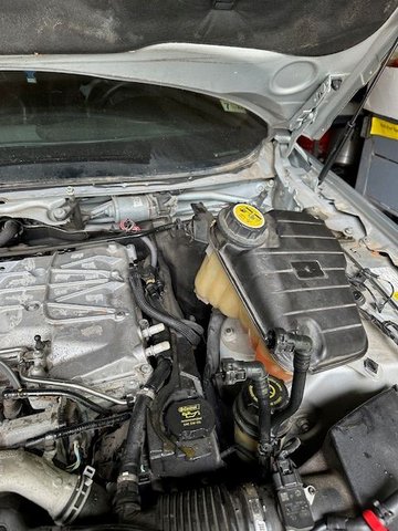

Well, after about a year, I finally decided to take this on. I was all gung-ho when it first happened, then life got in the way—and here I am, a year later, finally trying to tackle it.
I started by removing the plastic around the supercharger and the wiper area. I picked up that puller tool mentioned above, and it made quick work of getting the wipers off. I think someone had removed them before, because they slid off pretty easily.
I lost two of the plastic grommets—they fell somewhere into the engine bay. I’ll for sure need to be more careful with those as I keep going.
Next, I took off the coolant reservoir. Just two bolts, but then it got caught on the sway bar—or whatever that bar is called. When I pulled it out, something broke and dropped again into the engine bay. Additionally, in the attached video, near the end of the vid where I point with my finger, I think I broke a clamp on the coolant reservoir hose. It’s loose, looks broken, and just slides off. The hose basically falls off the nipple when I remove it. I’m not sure what that part is called, but if anyone knows or has a part number, I’d really appreciate it.
I still have the coolant reservoir connected at the bottom; I just moved it out of the way. Seems ok for now but might have to move it later.
I removed the sway bar (or support bar) and the cowling that was underneath it. I just used one of those plastic trim tools to pop up the grommets.
And this is where I’m stuck now. Since I broke that first clamp I messed with, I don’t want to keep making mistakes and break more. So I made a quick video showing where I’m at. The red arrows in the linked video show the hoses I think I need to detach and move aside. I just don’t know how to unclip them—there are four hoses with three different types of clamps. If anyone has any guidance, I’d really appreciate it.
Then I am assuming the plastic thing underneath them needs to go next also. I think this should give me some visibility into where the injectors are.

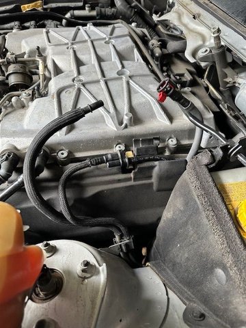

Don't over think it.
The intercooler coolant connectors/lines - you push them in towards the intercooler then press both clips in and pull the fitting off of the aluminium barb which is on the intercooler. I can do it by hand but other people like to use pliers like this:
https://www.lasertools.co.uk/Product...nnector-Pliers
Various cheap alternatives on amazon/ebay.
The other lines (2nd connectors in vid) are low pressure fuel lines I believe. The one with the red insert you pull the red part out and then the connector will slide off the plastic pipe, the other one has a single tab which you press in before pulling. With all of these things its easier if you push them together first.
You will also want to grab some rag, undo one of the metal fuel rail pipes slowly to release pressure - some fuel will come out. IIRC there is a JLR procedure which involved pulling the pump fuse and cranking the engine to use up fuel in the lines but I didn't do that.
Post again if you get stuck, I've done this job very recently and have lots of photos which I can share.

Thanks I was able to get the 4 hosed disconnected.
the intercooler ones spewed coolant which I was ready with a rag but that quickly got overwhelmed and it pretty much went all over the dirt cover thing under the car.
The other 2 fuel ones went ok. I was really trepidatious on the red one till it finally came free. The white one, did just as you mentioned. I pushed in. Pushed on the white spot and it came right out.
My last part of this step is to remove this plastic cover thing. I removed the oil cap and started to lift it out but its sticking at the end closest to the firewall. Any tips here? Seems very stuck and as I tugged pretty hard from a lot of angles doesn't want to come out.
I got a bad feeling that if I somehow I get it out, how the hell am I gonna get it back in the correct position.
Uggg, I'm barely touching the surface here and already having second though on if this is a good idea for me to do.
Anyone know a reasonable mobile mechanic in the Vanc Wa area?
anyways a few pics here below and thanks for the help.

Yes please go back over my previous post? I went all through that.
I posted pictures to show where to grind some rubber off on the backside so you can get those rubber pads in and out easier.
Yes they are hard to remove and watch that your not pulling on anything else. The rubber will flex.
Notice on my pictures that there are some plastic pins (I circled them in red) the covers snap into so first you need to pull up just a little bit to get them off of that. It's just like how the engine cover is attached. The cover will need to be snapped back into those studs when re-installed.
Modify them as shown and they will slide back in easier.
One thing is to make SURE you have the those gas line/vacuum lines on the drivers side of the engine marked! We had a guy that got them hooked up backwards and had all kinds of problems. Yes for some reason Jaguar made the connectors the same.

Ahh yes, thank you. I'll revisit this again tonight but yeah I see what your getting at. I'll start with marking the lines, that's a great tip. Then I'll try my best to unsnap these and report back. Thanks again for the reminder!
Old Jun 4, 2025 | 07:15 PM
jimmy6154's Avatar
Joined: Jun 2024
Posts: 14
Well I gave it a shot and its stuck in there good. Not sure I'm going to be able to pull it out without taking something else apart.
It has a lot of play but I tried reaching in there with my hand, a screwdriver, and it would pull a little and go no further. Then I tried putting it back in place and now it is not seating right.
Honestly I'm about to call it quits here.
Like I said, anyone know a mobile mechanic for jags in the NW? The only few B&M places here won't take the parts I've already ordered and will cost me a gold bar to get this resolves. Prob more then the car is worth at this point.
