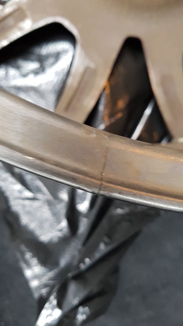

Thanks for the replies all, after some investigation it's a crack in the rim so looks like I need to replace the wheel... Thought a repair might be possible but a quick Google gives some very conflicting advice on whether this is actually a good idea..

Hard to tell from the photo - is that the inner rim with a crack? If it hasn't spread far (eg a half inch or less) it could be repairable. A good alloy welder can fix it stronger than the original and avoid crack spread. But you need a good wheel alloy expert who knows what they are doing
Otherwise yes - new rim. Not cheap
