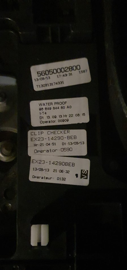

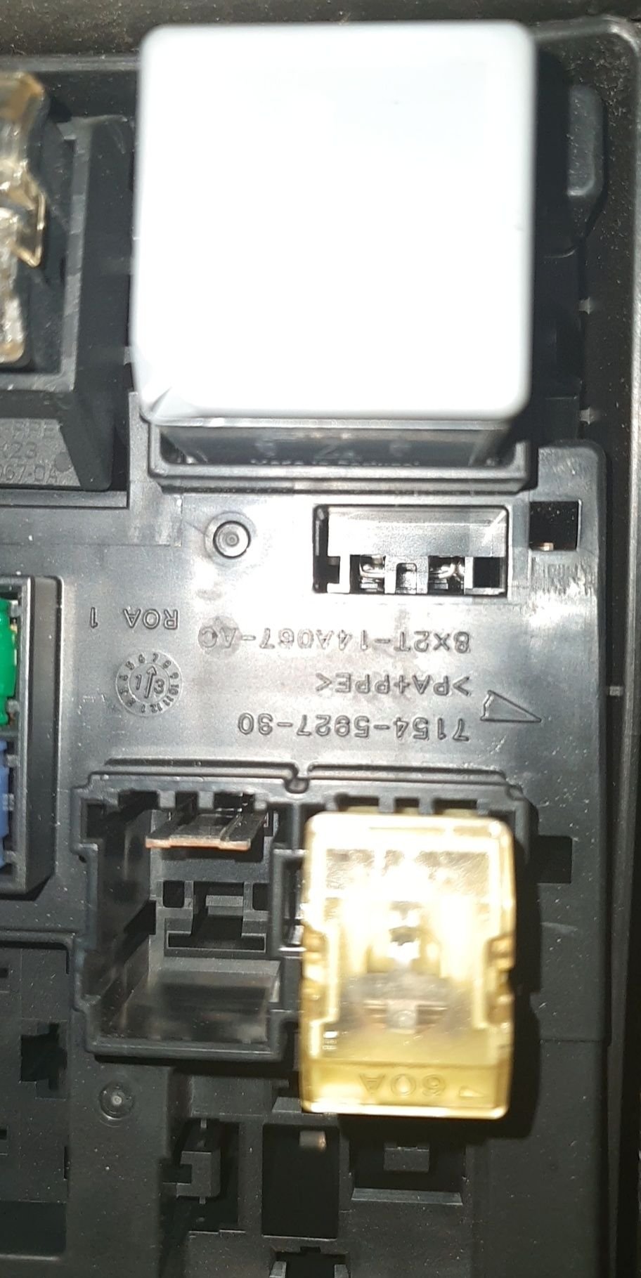

repair or replace cjb (front bcm). Dealer will only replace it to new one. I have a solution to repair it, but you need external programmer for bcm flash. Temporary, keys may be programmed to your old bcm via sdd, but the car will lost them every time battery disconnected. Also windscreen washer will not work with faulty cjb. Only one way is to check this problem - read vin in front cjb, as i told. On my photo there is a faulty one:
btw, did you check all fuses? Especially electric column one.
Sorry, is this the information you're suggesting to check?
Yes I've checked all fuses and they're all fine
