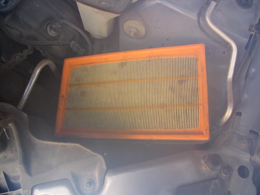

Finally made the change about two months ago. Bought 2 filters and the recahrge kit with the pump bottle for about $95. I kid you not, the only dealer I could find over here in the desert that actually had the filters and kit in stock wanted $271...
They don't look so bad on the top...
Flip them over... Yeah, its time for them to go.
Airbox canister and lid were decently clean, but I cleaned it anyway.
Seat of the pants wise, I detected no difference, as I was expecting. The only numbers I have to back up the benefits of the install are the mileage range numbers as per the center display. When I bough the car in April, range with a full tank was right around 290-295 miles.
Since then, but before I changed the filters, I would see about a 1-3 mile increase in range with every fill up, but I'm sure that's due to the fact of the car was doing mostly city driving before, and now its doing mainly expressway/highway driving since I bought it. At the change out point, I was getting about 310 miles per tank. After one tank with the K&Ns in place, it jumped to 317 miles. As of this writing, its pretty much stabilized around 337.
Condition-wise, I'm working in a sea level country (less than 50 ft ASL), but with very high humidity, and this time of year, temps are always in the 100s. I'll post some numbers January, when the temps and humidity levels are significantly lower.

The "dirt" on the back of the filters is most probably oil vapour deposits. This comes from the clean side of the air intake so does not mean the filters aren't working. Your K&N will look the same after a few miles.

BTW..How many miles on those paper filters?

I'm not sure how many miles the paper filters had on them, but I bought the car with about 53K miles. I did save them, and for sure I'll take a look at what the "dirt" on the other side of the filter is for my own education.
