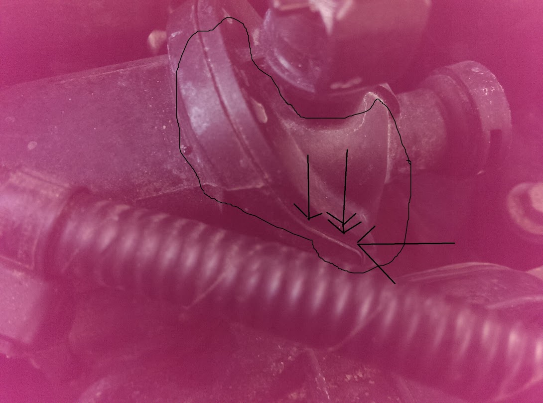

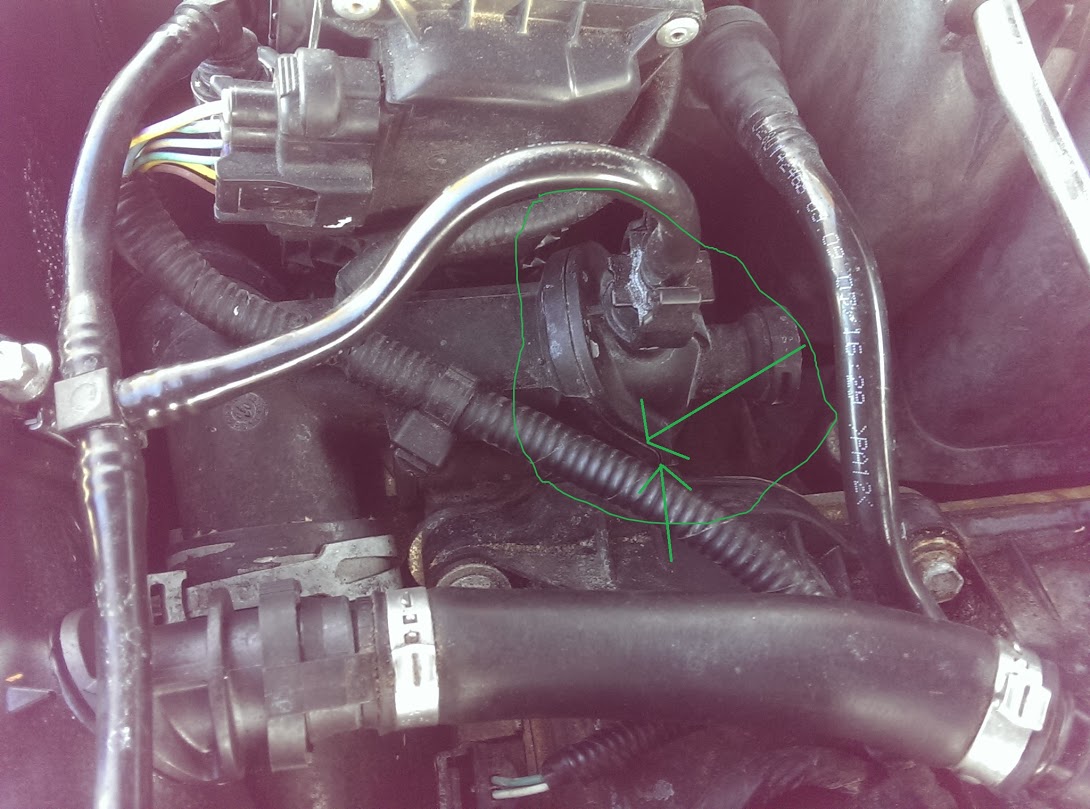

Hey people I'm looking for some assistance my car has been leaking antifreeze from literally three different places which I've been able to fix in my garage with help from this forum. I'm hoping this is the last place it leaks so can anyone help me identify this part and if it something that I should bring to the experts to fix or replace. I just have no idea what the name of the part is, where it leads to, best way to stop the leak etc. From what I could see the leak is right around where the arrows are pointing but there could be another leak on the same piece. Here are a few pics the arrows are pointing to the seal. Thanks in advance

I got my baby back rather quickly. The part I mentioned above was leaking and got replaced, water pump was good to go. I also got a tuneup and the grand total was $1280. My baby is back to purring again
