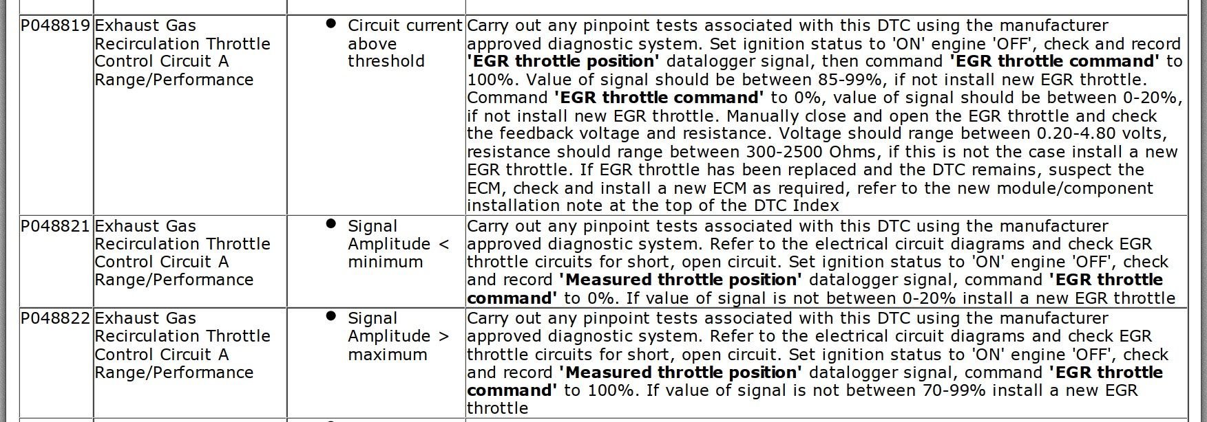

I've no experience of those codes but the following makes me think that if you have no EGR installed and its not been properly "deleted" from the car config it could throw P0488 as its expecting some feedback from the valve about its position.
P2263 seems to be related to the turbo, could be any of: the turbo, vacuum hoses, connectors, cables, sensors and the ECU which could be at fault. Its basically complaining that it's not sensing the amount of air it expected and now its a guessing game as to where the fault really is.
