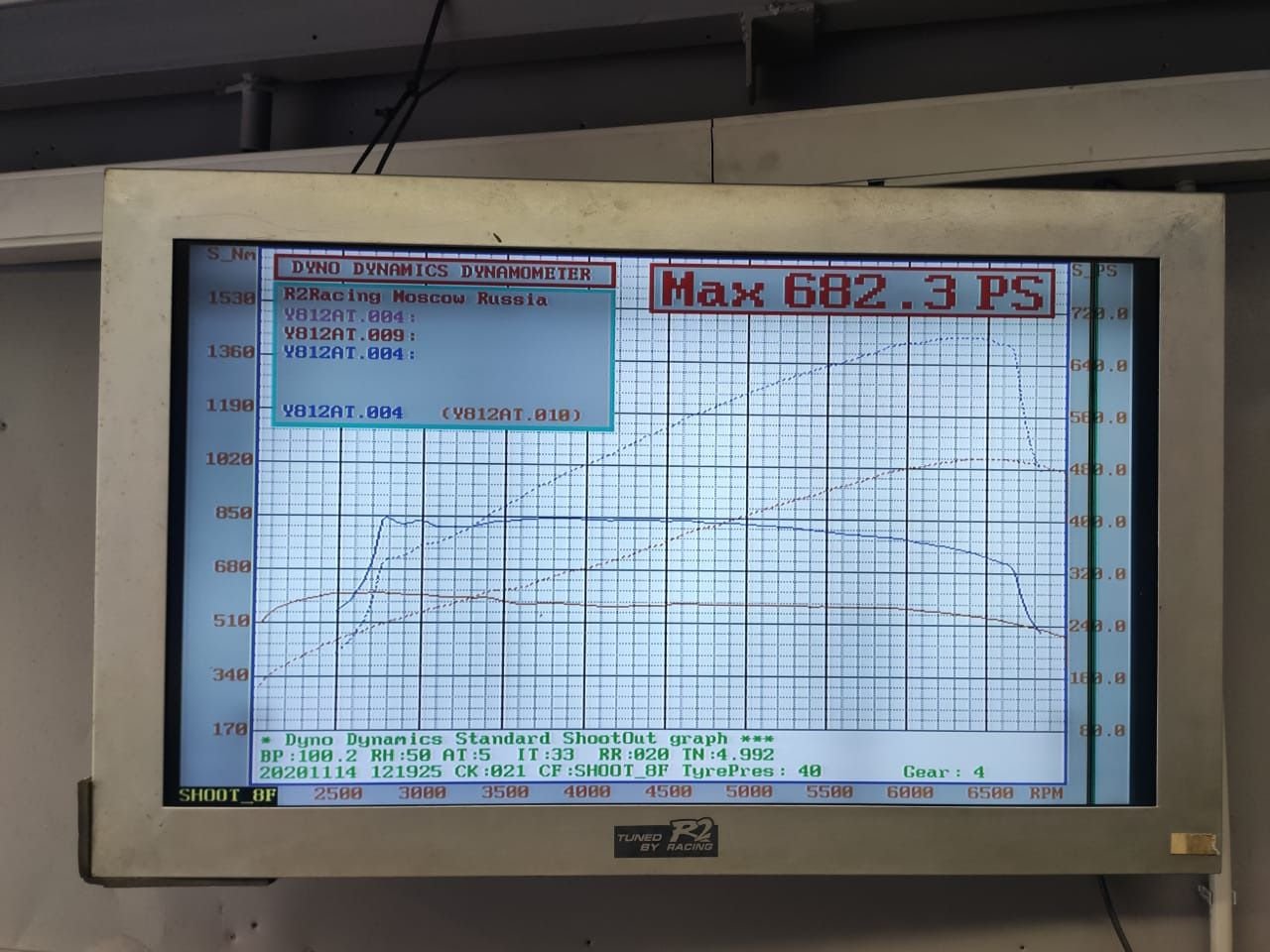

Before: 495hp/650Nm
Afer: 682hp/850NM and it was a torque limiter in a 6hp28 gearbox (now there's none, so there's more, will do a dyno later)
No issues with trans, diff, driveshafts. Only swapped a rubber coupling from a trans to a driveshaft.
Engine behaves pretty good, no issues at all, 80000km on an engine remap and 50000km after a trans remap (which totally transofrmed the way the car drives and delivers power)..
Rev limiter raised to 7300 from 6800, so there's definetely more horsepower)
And im very heavy-footed, using it's power pretty often. However there's big traction problems 0-100 even on a semi-slicks and remapped e-diff (which locks much sooner than in stock).
