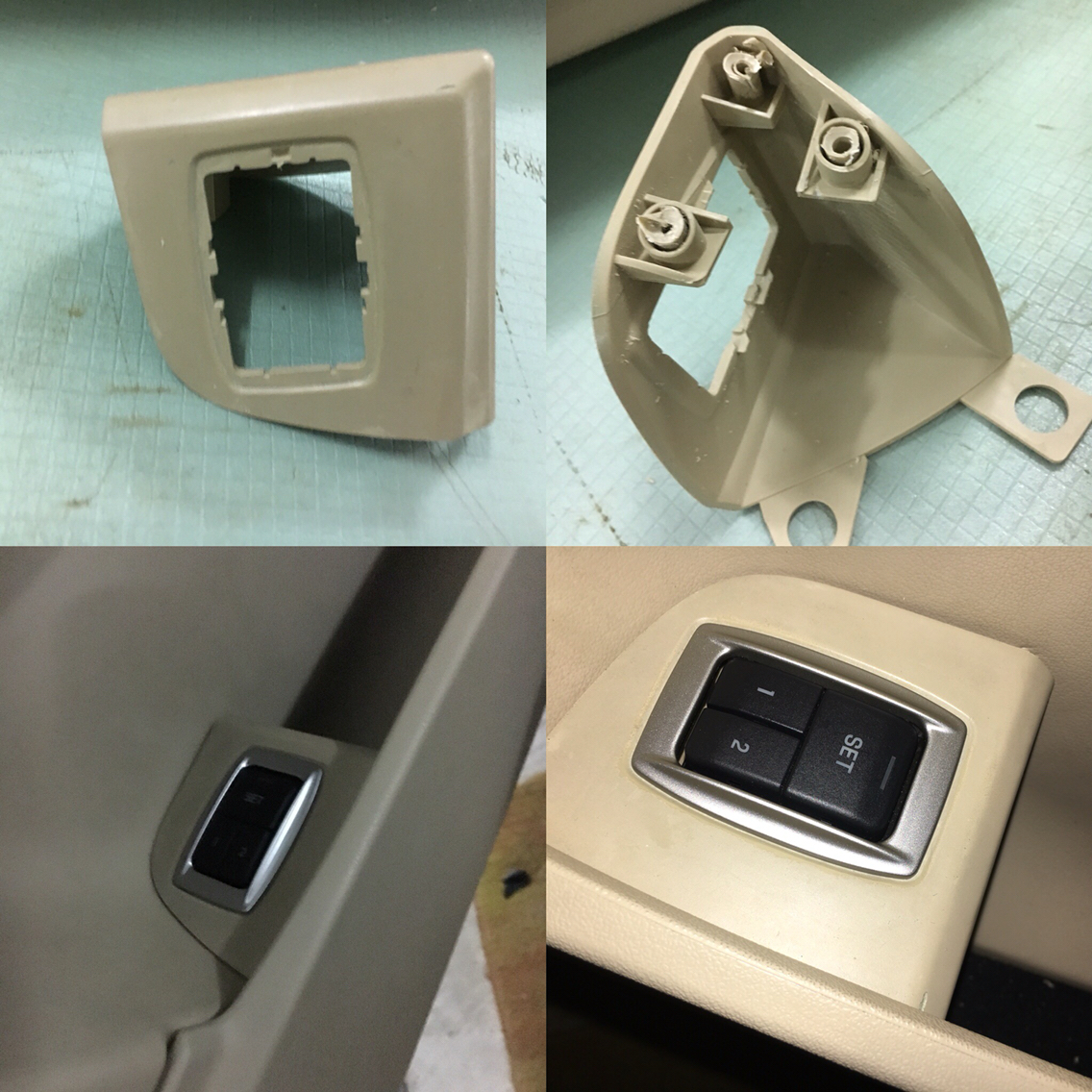

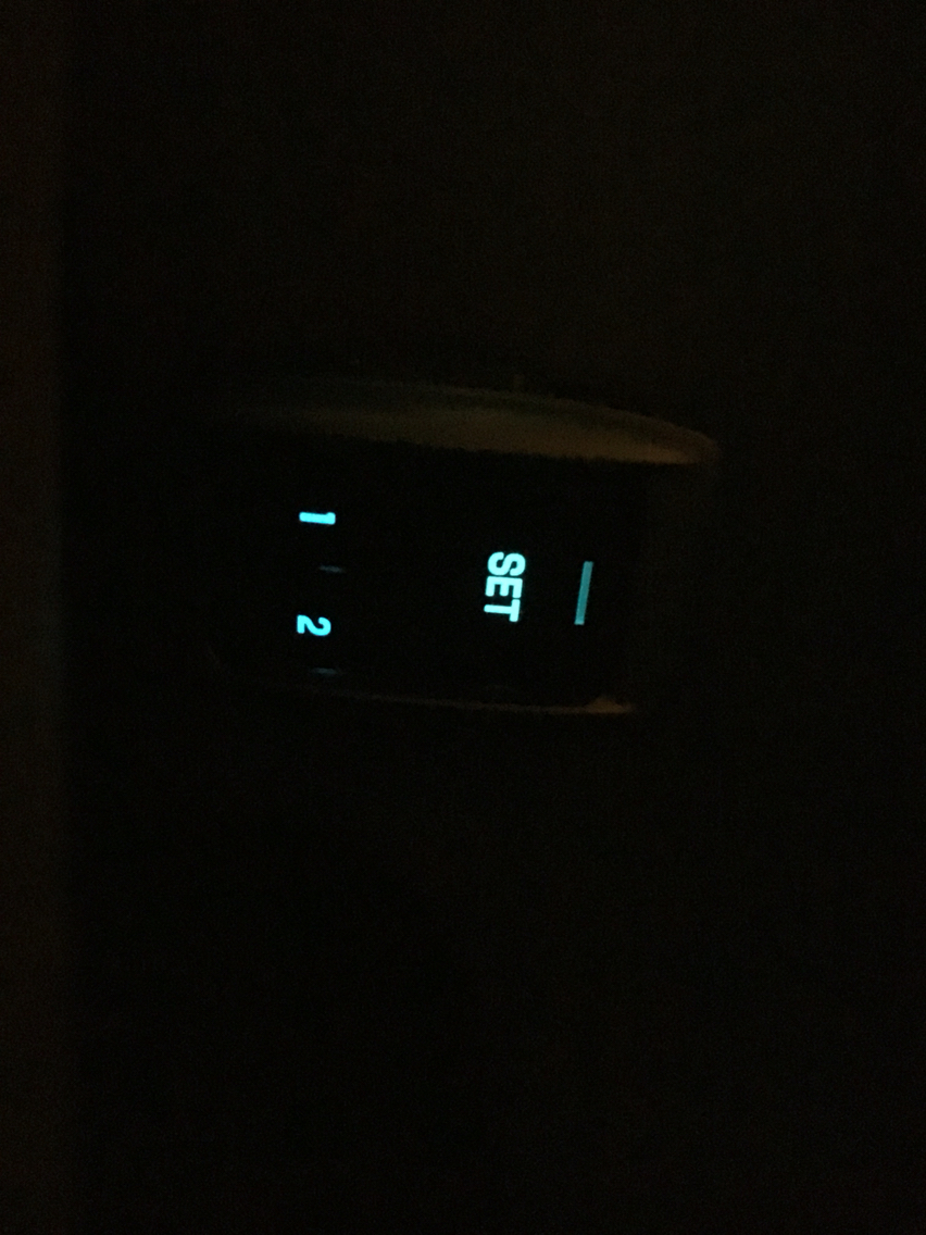

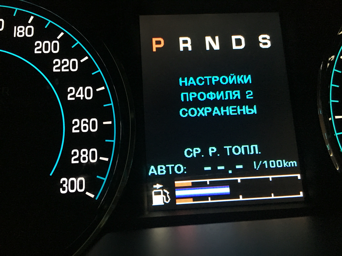

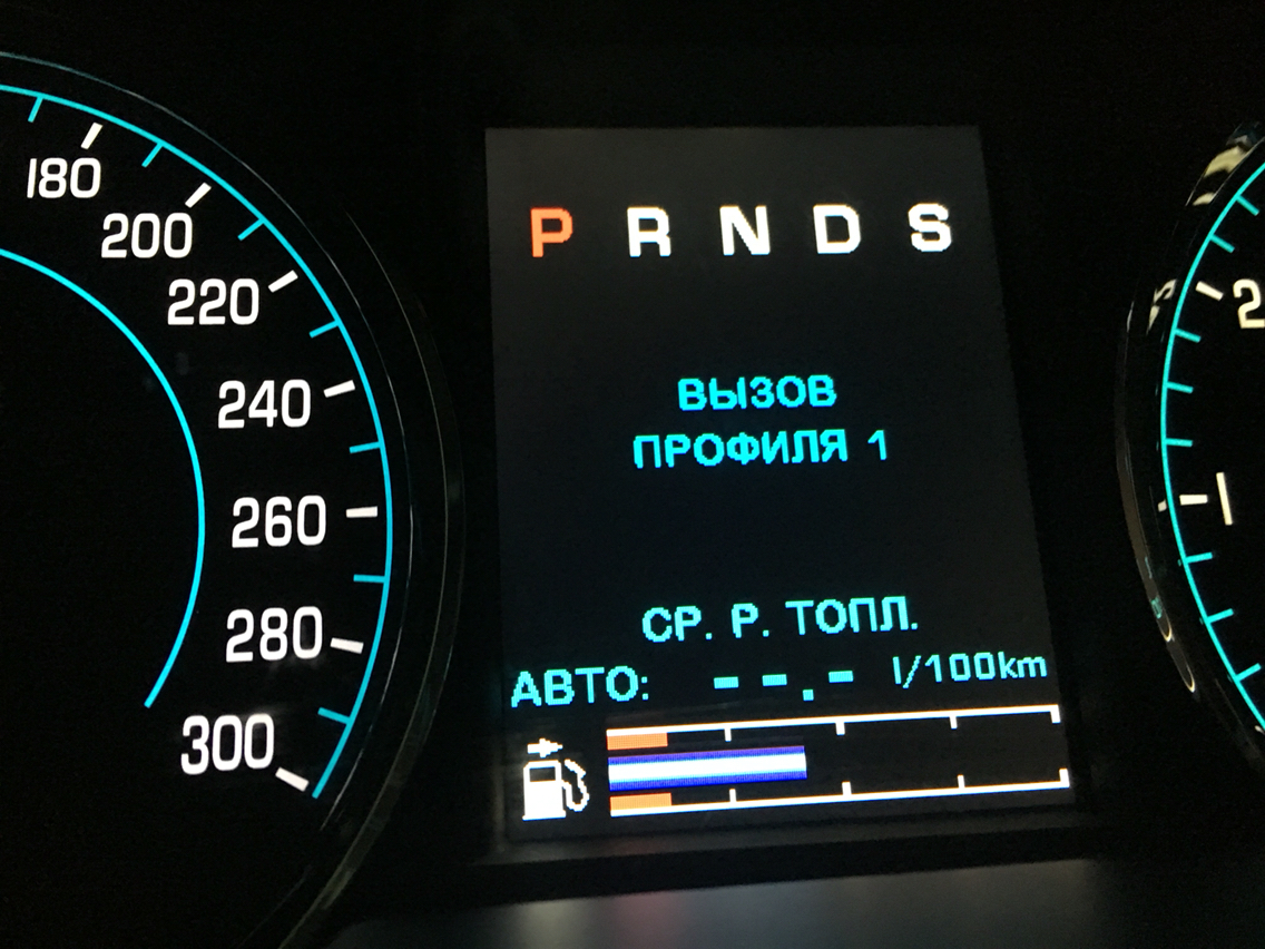

As you all know, I have install the front XFR heated/cooling seats.
A two weeks ago I decide to activate Memory function for driver seat.
As my seats comes with memory module under driver seat, all I need order just to order the Memory knob and bezel
Unfortunately I didn't found the LHD drivers door card with Memory function, so as temporary solution, I cut the hole for connector.
The connector for memory switch is installed from factory as the part of drivers door wiring.
So this mod simple plug&splay without any modification with CCF file and reroute wiring, all necessary wiring already install from factory
As usual some photos:
I think during a few weeks visit company who made seats hauling and order factory like podium for memory seats switch
Keep tuned.

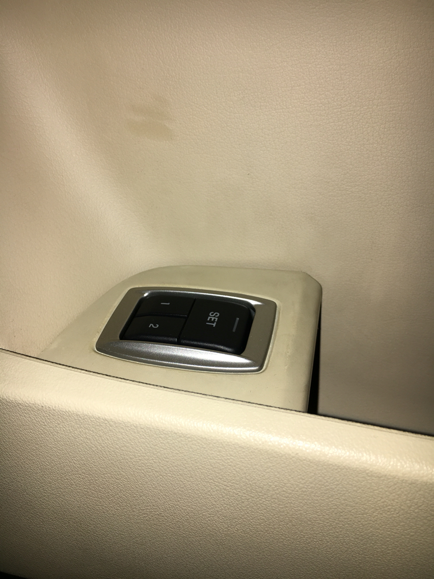

Yesterday got the driver card with memory switch podium for bargain price, the podium was drilled out and installed in mine factory card. So now mine door card has factory look.
Attached Thumbnails Memory Seat Function Retrofit-photo244.jpg   Memory Seat Function Retrofit-photo590.jpg
