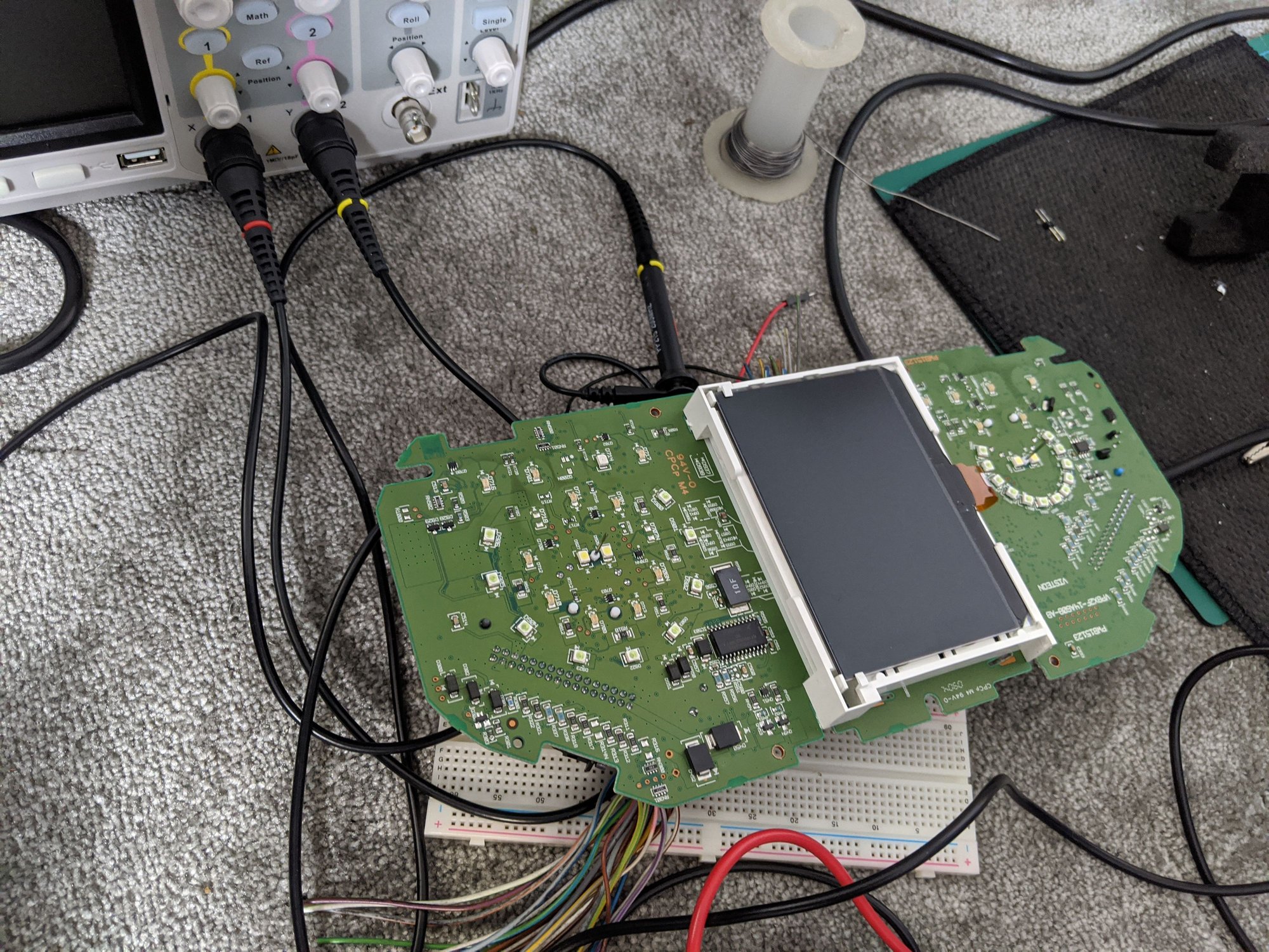

    Surely if it’s just the screen (lcd) that’s goosed, you can just change that?
    If it’s the same as the one in the previous picture, there’s a ribbon connector coming off it.
    It looks like unplug and replace

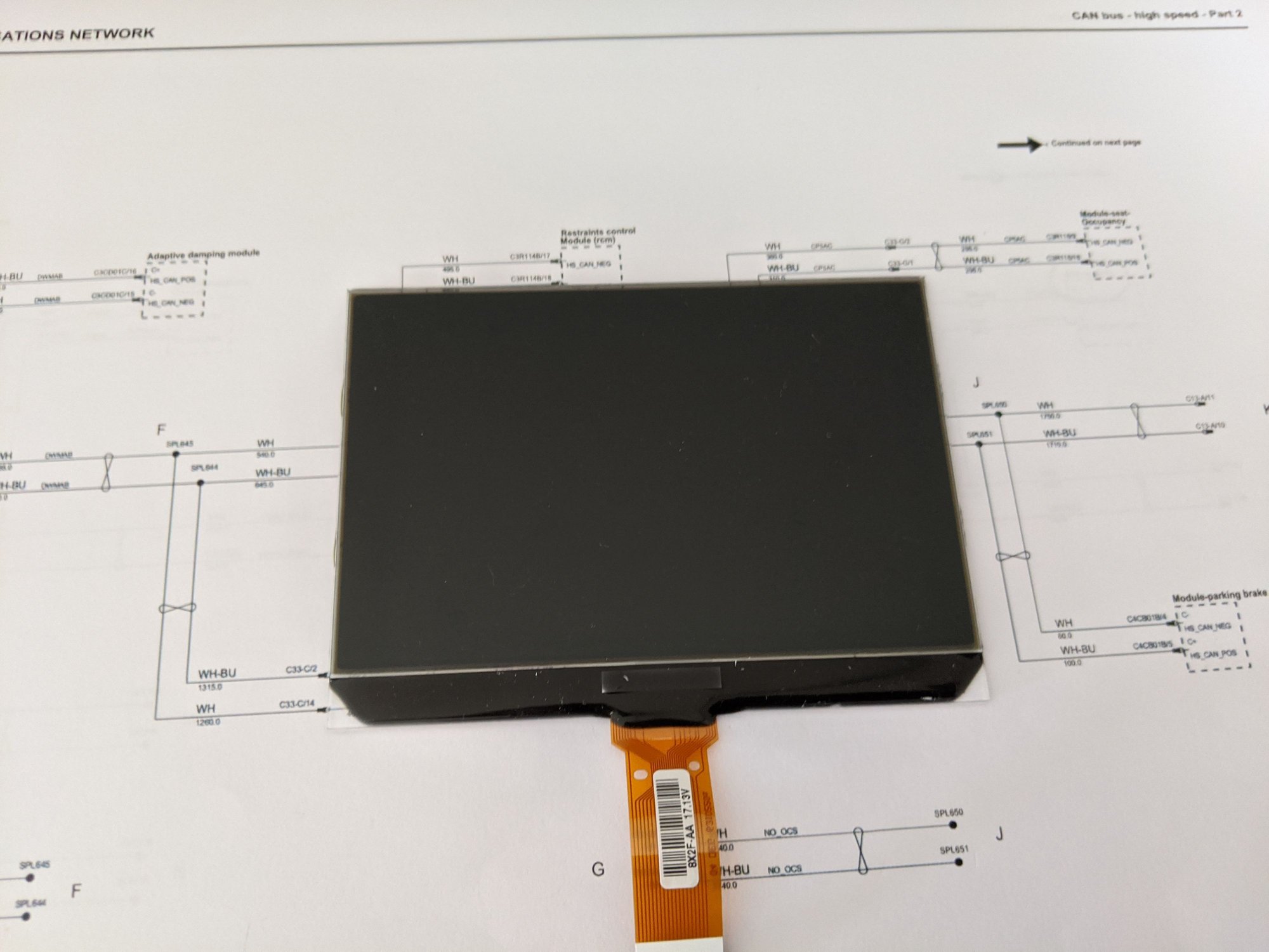

    Yes, exactly. Buy a used one and strip the screen out, its just a screen on a ribbon cable. I'll pull it off later and upload a picture.

    There you go. the screen is just connected with this ribbon cable. You might even find that taking it out and cleaning the contacts might fix it if you live in an area where its very damp a lot of the time, but mostly likely is that its given up the ghost by itself.
    Worst case scenario is that the screen controller is bust however you said its flashing orange and red, so what it sounds like is that its trying to give you two warnings and the back-light is switching from red to amber but the screen isn't working so you have no idea what its trying to tell you.

    Thank you so much! So glad I didn’t jump at the first advice. I do live in very humid area but it’s been coming and going for a while, so I bet it’s busted.
    thanks again. I’m going to check into this in morning. I will let u know outcome!!
