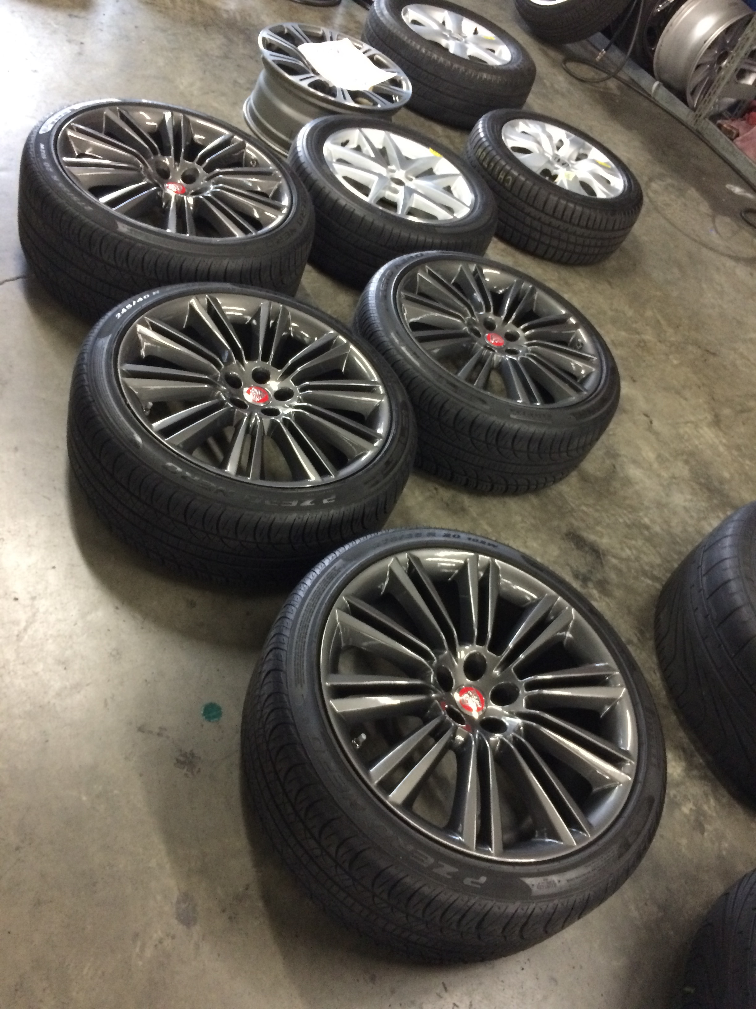

Whats up everyone. The new year is right around the corner and I want to start off 2016 with a bang by putting Michelin PSS on my 20" Kasuga Wheels. What do you guys think is the best size for these wheels? 20x9 20x10
Stock Sizes for my XJL are 245/40/20 and 275/35/20
Thank you for your time.
Johncy

Look up the XFR-S sizes.
From memory 265/35R20 on the front, 295/30R20 on the rear

My 2013 XF scv8 has factory 255/35/20 in front and 285/30/20 in rear.
Makes since you could go up to what Cambo said. Especially if that is the XF RS stock size.
