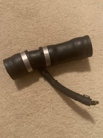

I recently purchased a 2015 Jaguar XF Sport (3.0 L Supercharged with AWD) as is. I was delighted at first, only to be surprised by a low coolant light. I figured the car was low and coolant and added some, which is when I discovered a leak. I took it to my local dealership to get diagnosed (I suspected it was a water pump) and they told me it was actually the thermostat. I purchased an OEM thermostat and A I was working on the car when I noticed there was an o-ring in one of the lower radiator hoses (part #C2Z21608), which I also decided to replace for good measure.

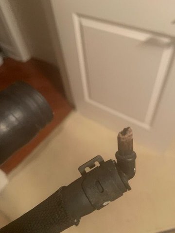

As I was doing this, I also discovered a hose attaching to the top of the thermostat was broken. I want to purchase this part ASAP so I can hopefully drive my drag problem-free. I've attached images of the hose as well as showing the damage done to it. Thank you all for help!

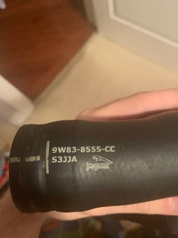

You're in luck 9w83-8555-cc is the jaguar part number, Google parts suppliers in your country. You may find its the same part used in Landover's too.

The Jaguar Part Number for that hose is C2Z28258.
You want to check also the Y-Pipes in the engine's V-alley, those are prone to leaking as well. https://www.jaguarforums.com/forum/x...-c-awd-239499/ post 4 has a shopping list that should match your car.

I tried that already and could only find it on an obscure part website. I was looking for the Jaguar-Land Rover part number.

This is exactly what I needed, thank you Chris!
