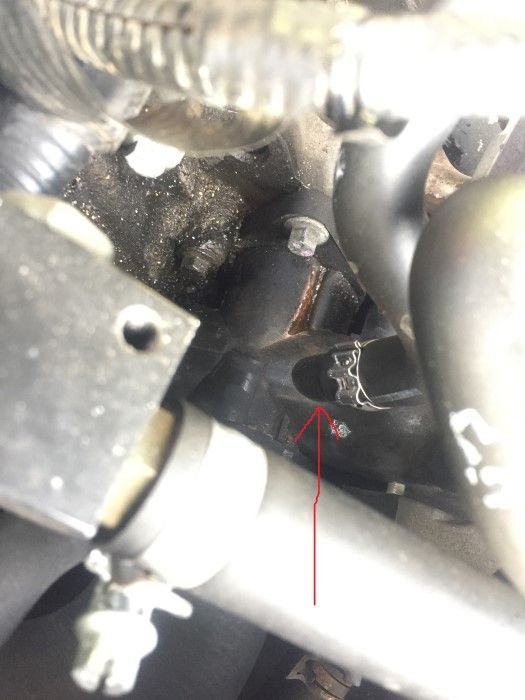

I currently have a coolant leak on my thermostat housing at the base of one of the pipes that feed the EGR/Throttle body. Check the whole housing which is made entirely of plastic as it tends to break or crack
I'm not sure if your car is a supercharged version. If you do then I believe there is a hose in the valley of the V of the engine that is prone to leaking. If that is leaking slowly then you may not see any visible signs of coolant leak. If it's leaking badly then you may see coolant leaking down the back of the engine.
My leak is as shown in the image below:
Thermostat housing coolant leak.

Exactly where my 04 was leaking coolant from.

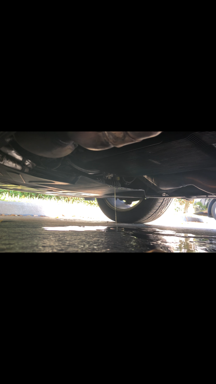

Took look under the jag to see if I could trace the leak and all I saw was a trace coming down from the driver side of the engine by to the catalytic converter, I took a look also taking apart the throttle body and did not see much. it appears to be the base of the thermostat assembly but it is hard to say, there is a hose that connects to the throttle body that goes further in the top of the engine, did not see much further. I added more coolant fluid and no leaks as long as I do not turn the engine on.
At this point I would have to take it to the mechanic tomorrow.
You can see how it is dripping after I started the car

Be brave you can do it if you try.
The rest of us do, saves you a lot of cash..

That's not a leak, its a flood.
Sorry to hear about your issues.
But 226,000 miles before hand is pretty good.
Better get busy fixing, or dig deep into your wallet!!!!!!!!!!!!!!!

Mine only leaks from the thermostat housing when the engine is running and when under pressure. When the car is cold or left to sit then there is no leak. And when it does leak it runs down the side and front of the engine.
Yours is quite a major leak if the fluid is coming out that much.
