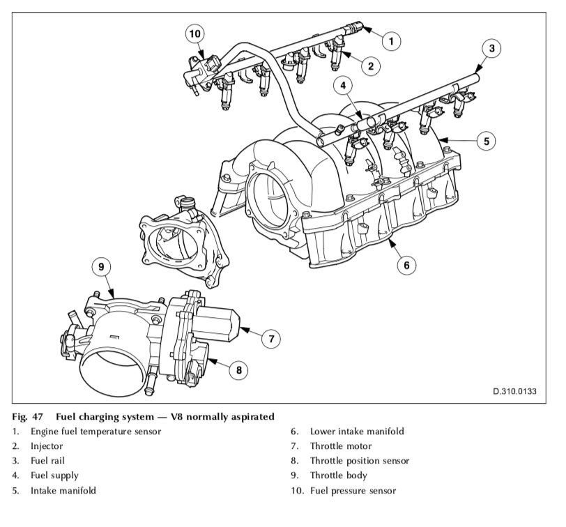

Throttle body return hose 4.2L part AJ811763
Inlet manifold off and see the Throttle body return hose
4.2L intake manifold diagram guide for the removal process
