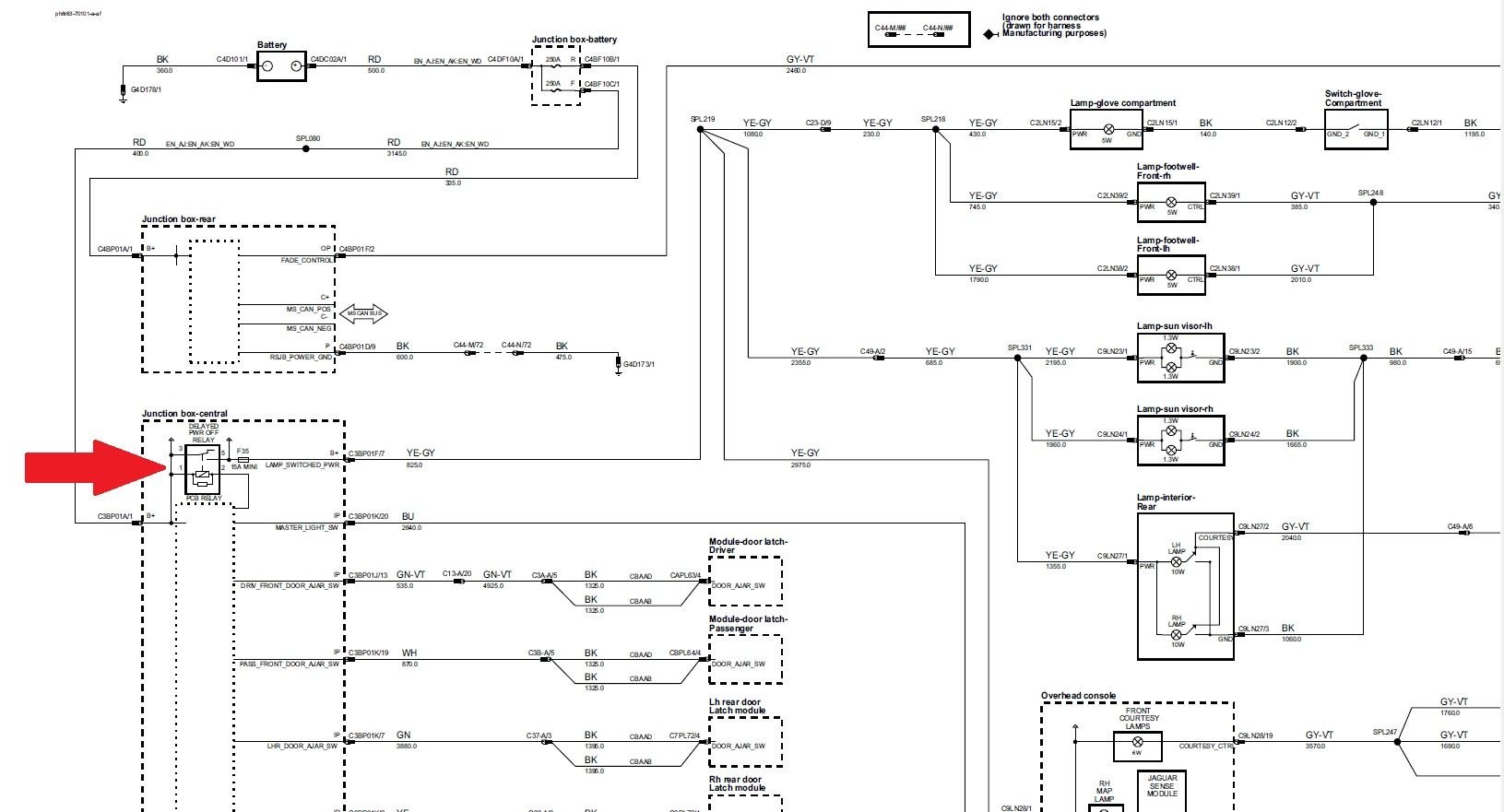

Ive had my jag for a minute now just recently my interior lights and my glove box stopped working. Ive searched in the forums for some answer but havent gotten anything clear i know theres a short somewhere because the fuse went out as son as i replaced it. If anybody could lead in the right direction or knows where to look for a short or has actually solved this issue, please let me know thanks guys

I thought this was going to be a BPM (Body Processor Module) issue as checking the fuse didn't fix it. However, according the Electrical Schematics there's a Delayed Power Off Relay located in the Central Junction Box. A failure of this is a possible cause of the issue.
The schematics never look very clear in forum posts but here's a section of the relevant page:
If it's not this, a diagnostics session with Jaguar SDD could show relevant codes to help troubleshooting.
