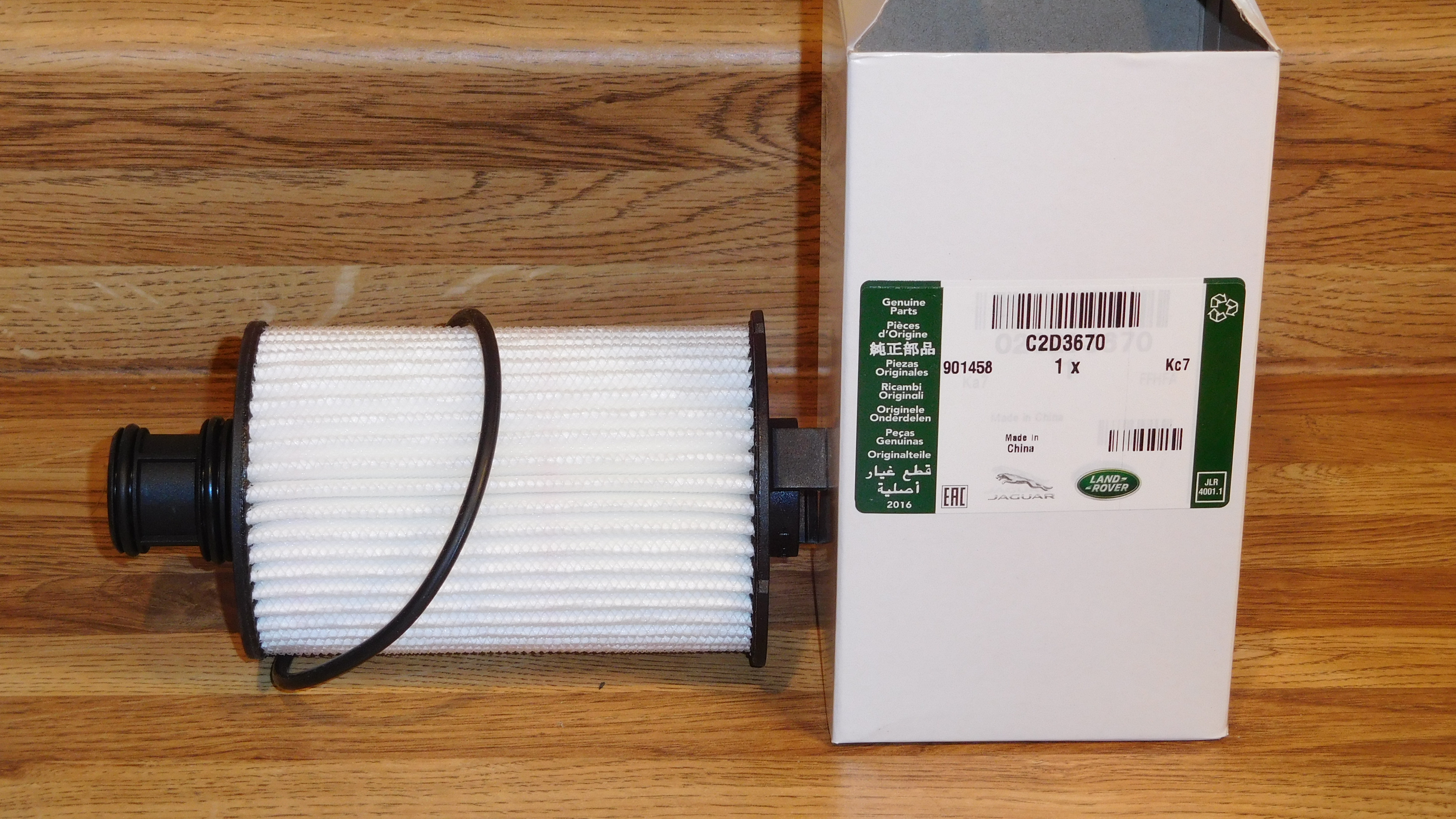

I just filled both on my 2011 5.0L XF Premium with the Pennzoil oil made from natural gas. So far so good.
And yes, the oil filter cartridge looks like what you would find on an E-Type, but you won't find it on my 1965 Series 1 4.2L Roadster because I converted it to a spin on filter.

There's no need to pay $49 for an oil filter. I just bought a Jaguar OEM one from an on-line Jaguar parts dealer for $15 ($18 shipped to me). There are apparently two different types of oil filters for the 5.0 NA as they changed at some point. Based on my VIN, it is a paper filter cartridge that goes inside a plastic canister like on German cars.

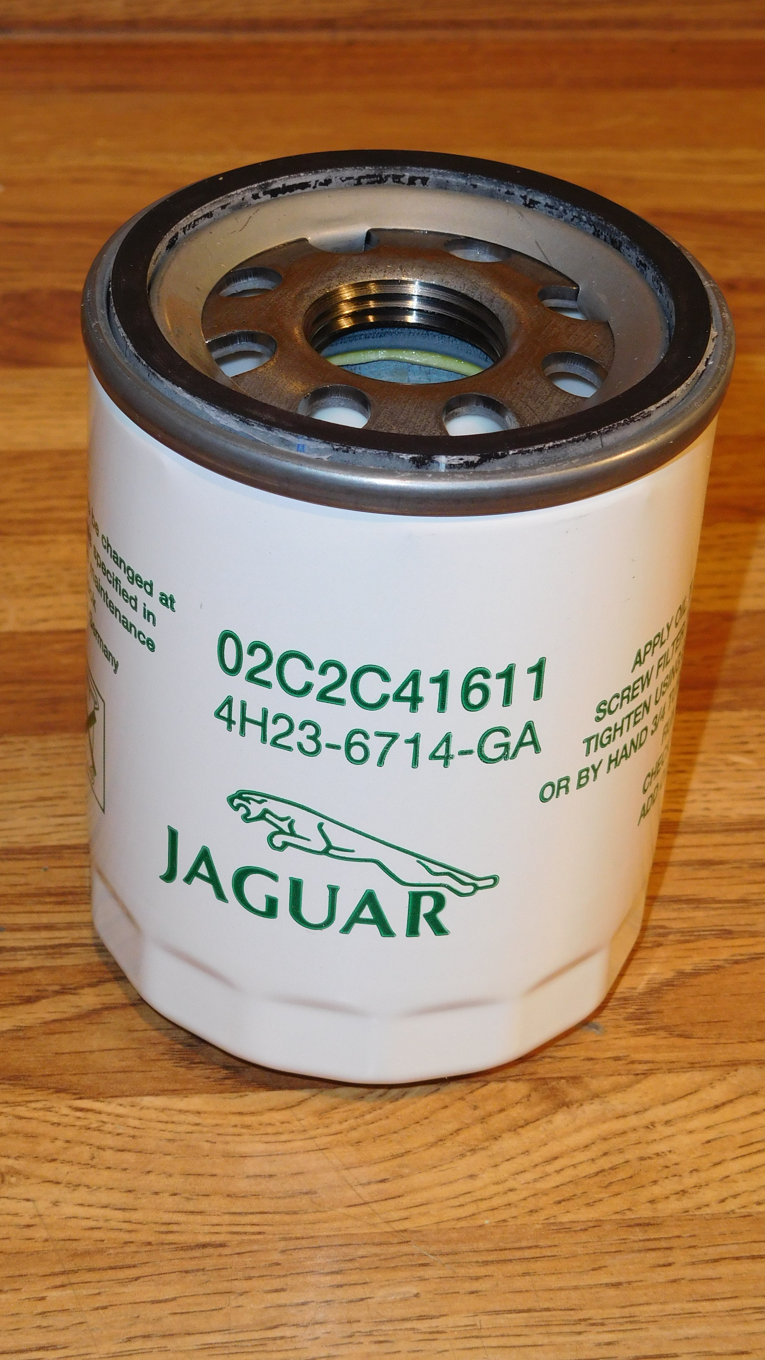

There are two different types of oil filters for an XF 5.0.
The first one is a one-piece spin-on type, part # C2C61411, and the other is a paper/plastic insert that goes into a plastic canister, part #C2D3670. The correct one for your car is determined by VIN. I ordered an oil filter from a Jaguar dealer based on year and engine type and got the wrong one initially. They then sent me the correct one based on my VIN. You can see the difference in the photos below.
