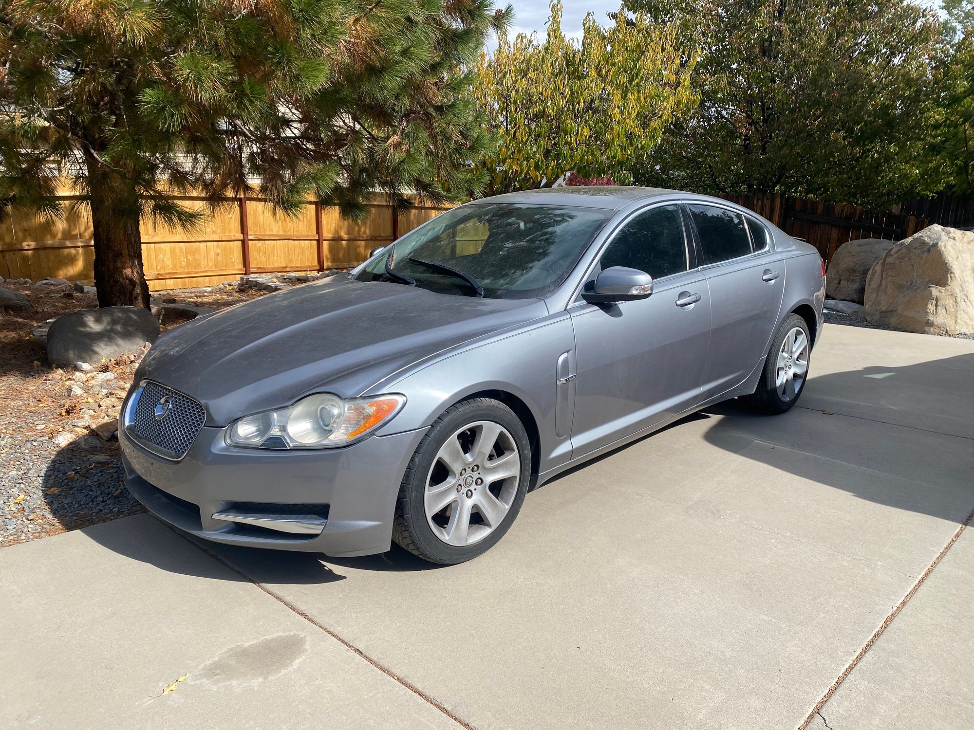

Hi All!
I’m looking for a little wisdom from the collective.
A couple of weeks ago I bought a decent looking 2009 XF at an auction. This means I don’t know any of the history of this vehicle. Since it’s not running, my wife named it Paper Weight.
I’ve done some snooping around under the hood and found at least one pressing problem. When I removed the plugs and cranked it over, water shoots out from the two center plugs on the driver’s side. This seems to indicate a blown head gasket. Fortunately, there’s no coolant in the oil.
Interestingly enough, the coolant overflow bottle had been recently replaced, with the old one sitting in the trunk…
Are head gasket failures common? Or could this be something more serious, like a cracked head? What’s the common cost for a head gasket replacement, if I don’t do it myself.
I’m trying to evaluate this project, if it’s worth fixing, or if it should simply be parted out.
Erik

So, based on the advice I’ve got from the collective wisdom is that this is not a car worth my time to fix.
I posted it on Ebay, item no. 185112931698.
Let me know if anyone here has an interest in a project/parts car (located in Reno).
Erik
