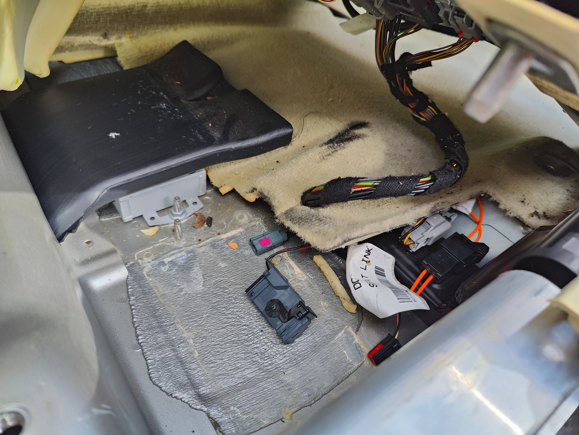

I've owned my 2011 XF 5.0 V8 for over three years now and I had the electrical issue from day one. Did ton of service on the car including a new generator and battery but nothing seemed to fix the issue. Ended buying one of those portable battery starters to not risk getting stuck somewhere. The car rarely managed to sit for more than a week without getting start-up issues, I could easily distinguish when the battery started to have a low charge on start-ups..
But now... the car has been sitting for multiple weeks, multiple times without showing any signs of a low battery charge and all because I fixed another issue on the car which seems to have sorted out the battery drain as well, lucky me! 😇

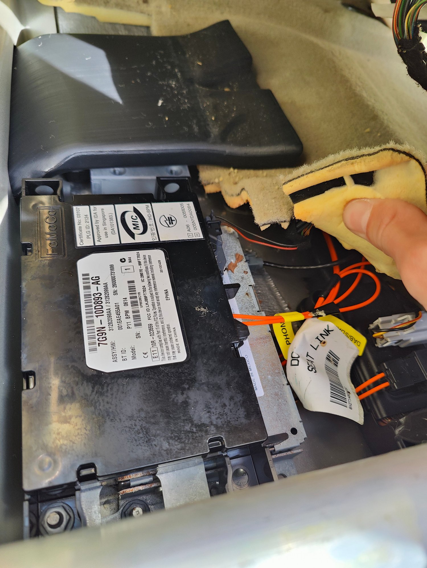

So here's what happened.. my infotainmentsystem started lagging on start-up, the computer kept rebooting for several minutes before finally booting up like normal, and this happened everytime I started the car.. why I had to find a fix for it.
The FIX:

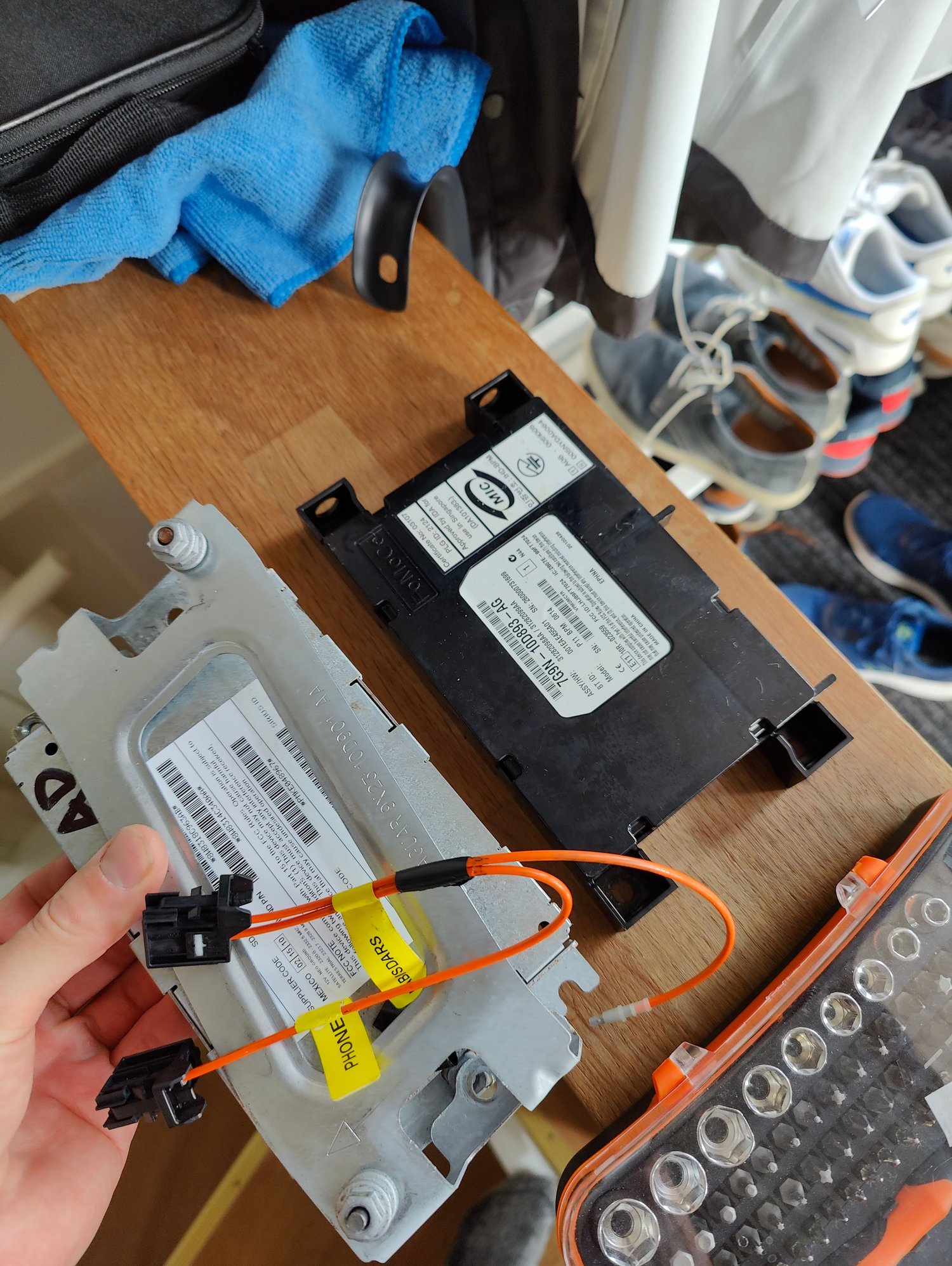

I removed the driver's seat, fairly simple process, there's multiple videos online. And then I removed the Bluetooth-module and the Satcom-module, they are plugged in one after the other via a fiber optical cable, so I just had to remove those two modules out of the loop. No extra equipment needed. This fixed the infotainment system, no longer lagging on start-up and surprisingly doesn't seem to drain the car battery anymore!

[QUOTE=kkurulak;2817911] I did not replace the units, the bluetooth was already not working when I bought the car. I bought the car in the US and brought it back home so didn't have any use for the satcom unit either.
There were small amounts of corrosion on the satcom-module that sits closest to to the floor. Can't recall how the pins looked.
