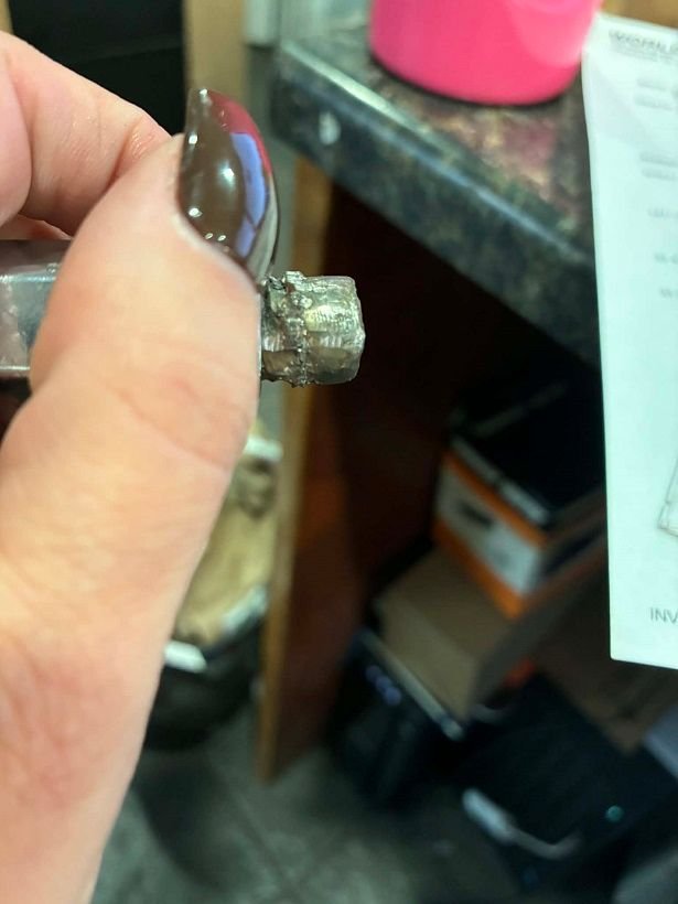

You have to love these things to put up with them...At this point (and I've been wrenching on brit iron (and fibreglass) since 1980), owners that care end up dealing with the sins of previous botched and 'just get it running' hack jobs.
Remains of broken stud that was hack-welded into the rear hub rather than doing the job properly and replacing the hub when the jackass wrench broke it.
A couple of suggestion's?
All wheel lugs are available in the after market. Forget Jaguar. Just get the measurements of the wheel stud and go shopping. I have replaced several Jaguar wheel studs and each time I was told the entire hub must be swapped out. Well maybe but I never have?

Yes the SS caps on the lug nuts are a well known and are a VERY long winded problem. They have used these types of lug nuts for over 20 years. They are an accident waiting to happen and the first thing I do with a Jaguar is replace all of them with solid versions. SS is the best but the solid metal ones last too. If you doubt this please do some searches as we have dozens of threads about their failures.
At least this is one Jaguar problem that can be fixed permanently.

I know why they think they have to use impact guns to put wheels on, but there is a torque value, and it doesn't take that much longer to spin the nuts on by hand, then torque to spec, and move on. Over-torquing breaks bolts...which I can almost say is what some previous wrench monkey did and then tried to cover up. Problem fixed, on to the next (gremlins in the map lights...) crisis.
The next owner will have a sorted ride, that's for sure...lol.
