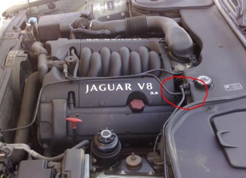

Are your coolant pipes connected to the header tank as shown on the picture?

Thanks for all the replies, I did confirm my hoses are crossed correctly

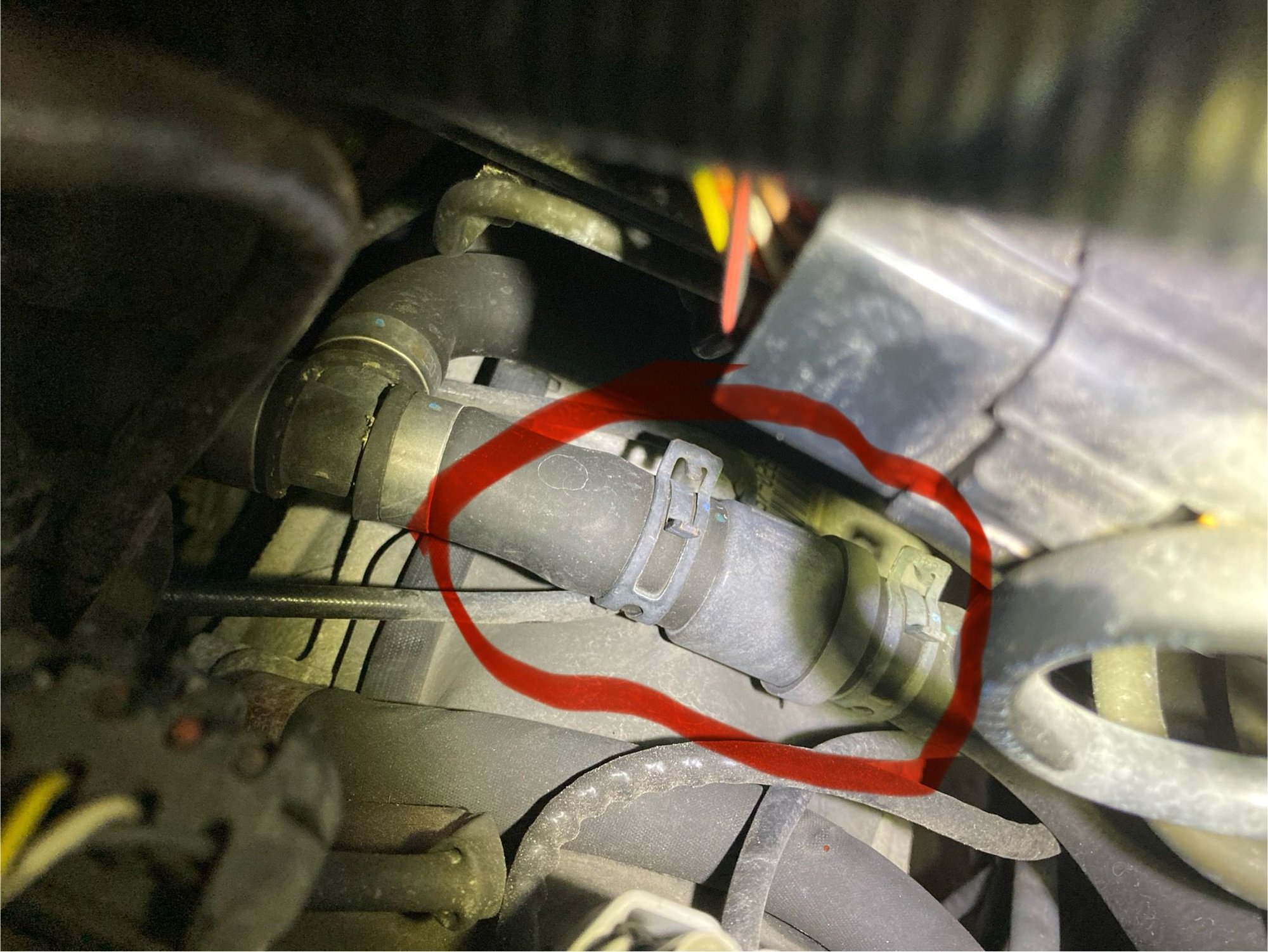

Below the throttle body on top of the transmission is this plastic one way coolant valve. It’s part of the octopus hose. They develop cracks, slowly leak coolant on top of the hot transmission and can evaporate the coolant prior to hitting the ground.

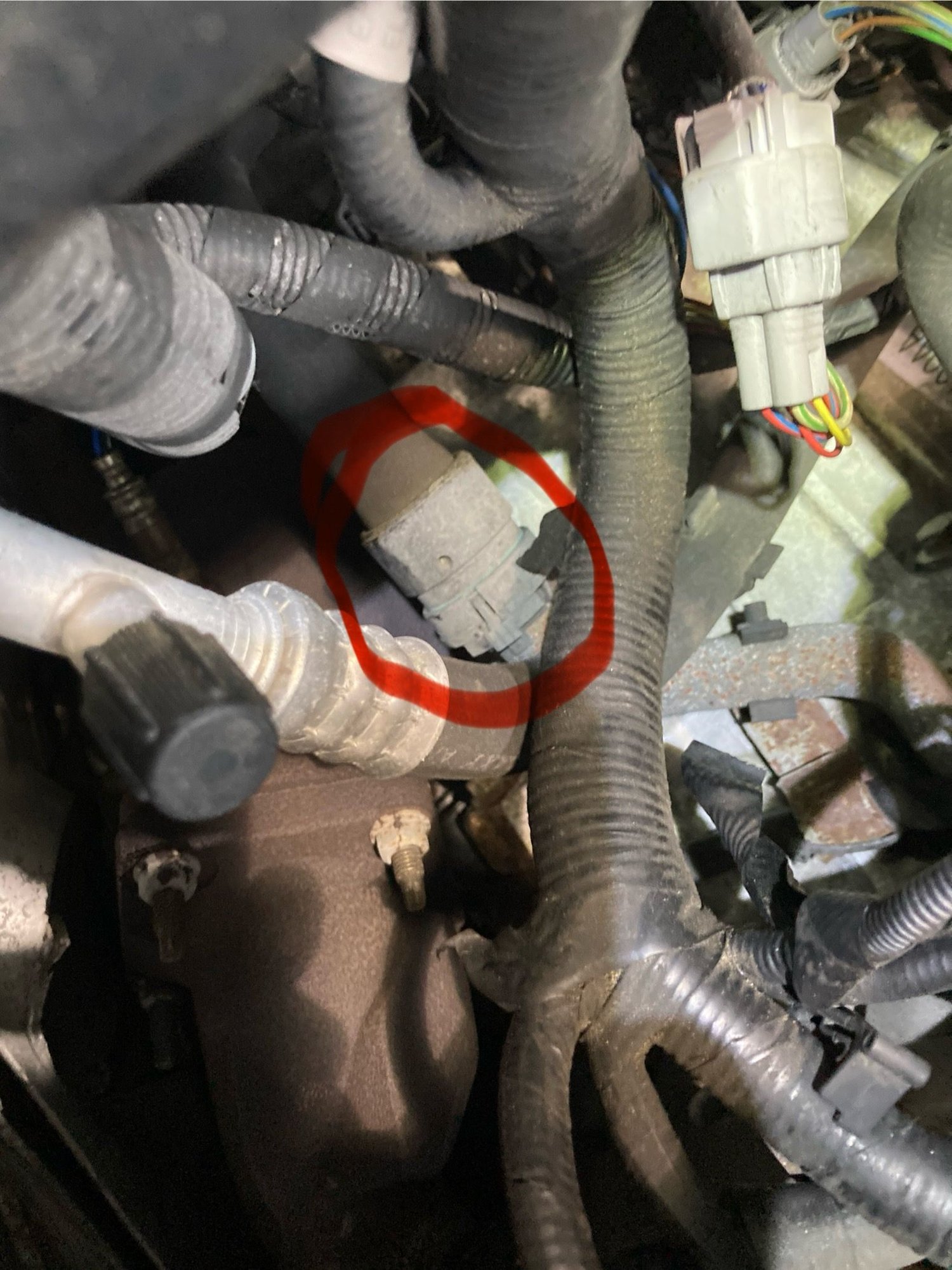

On the passenger side of the engine bay is this quick coupler. It to is also part of the octopus hose. It can crack and drip coolant on top of the passenger side catalytic converter and evaporate the coolant before hitting the ground.

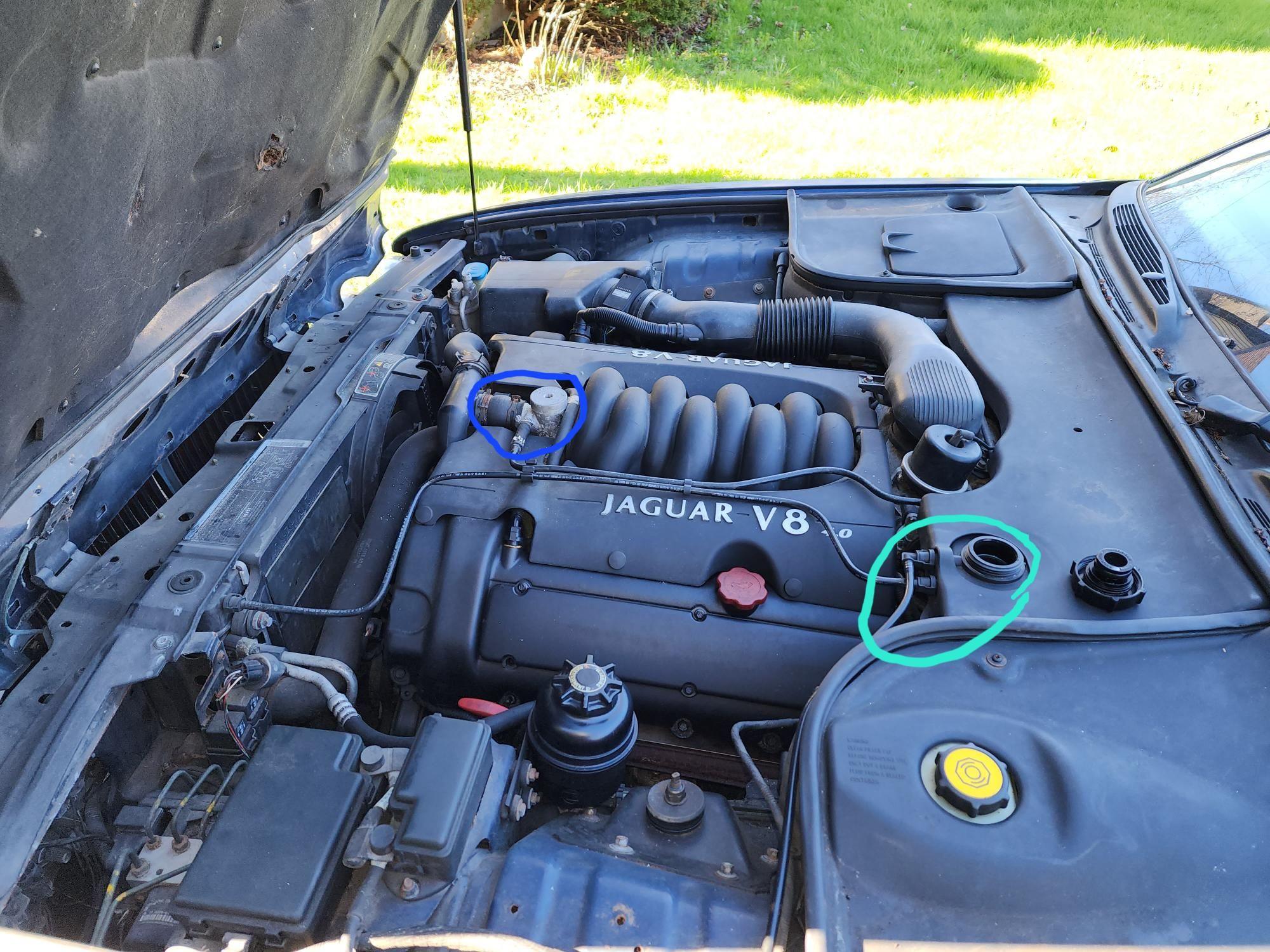

There is a plastic (what a surprise) 3 way tee on the drivers side of the engine below the cable side of the throttle body. They can also crack and drip coolant.
