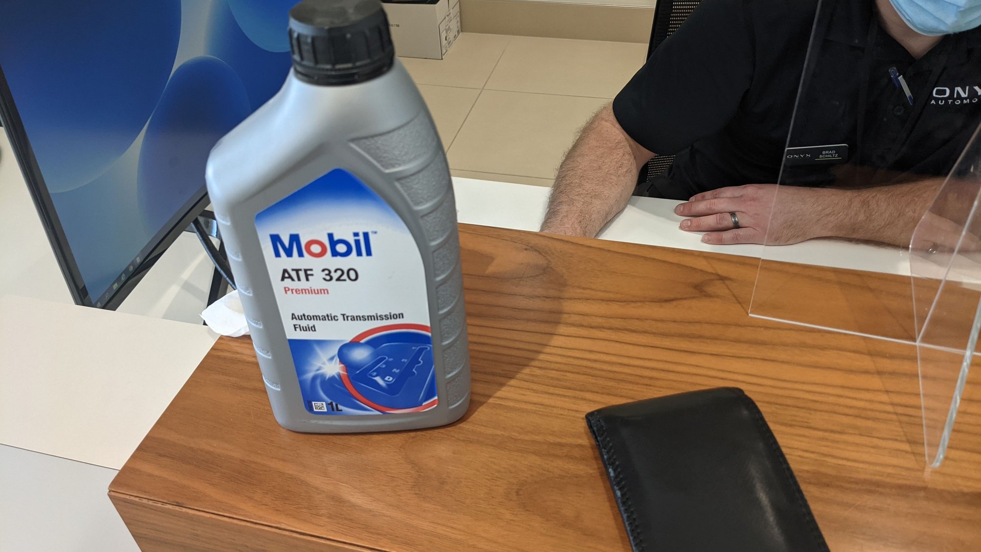

At this point I suspected that changing the fluid would be the next step. In the owner's manual, Jaguar calls for Mobil ATF 320. This did not seem to be readily available in US, not on Ebay nor Amazon. I called the dealer, who said he had 5 quarts on his shelf under the Jaguar part number, at $35/quart.

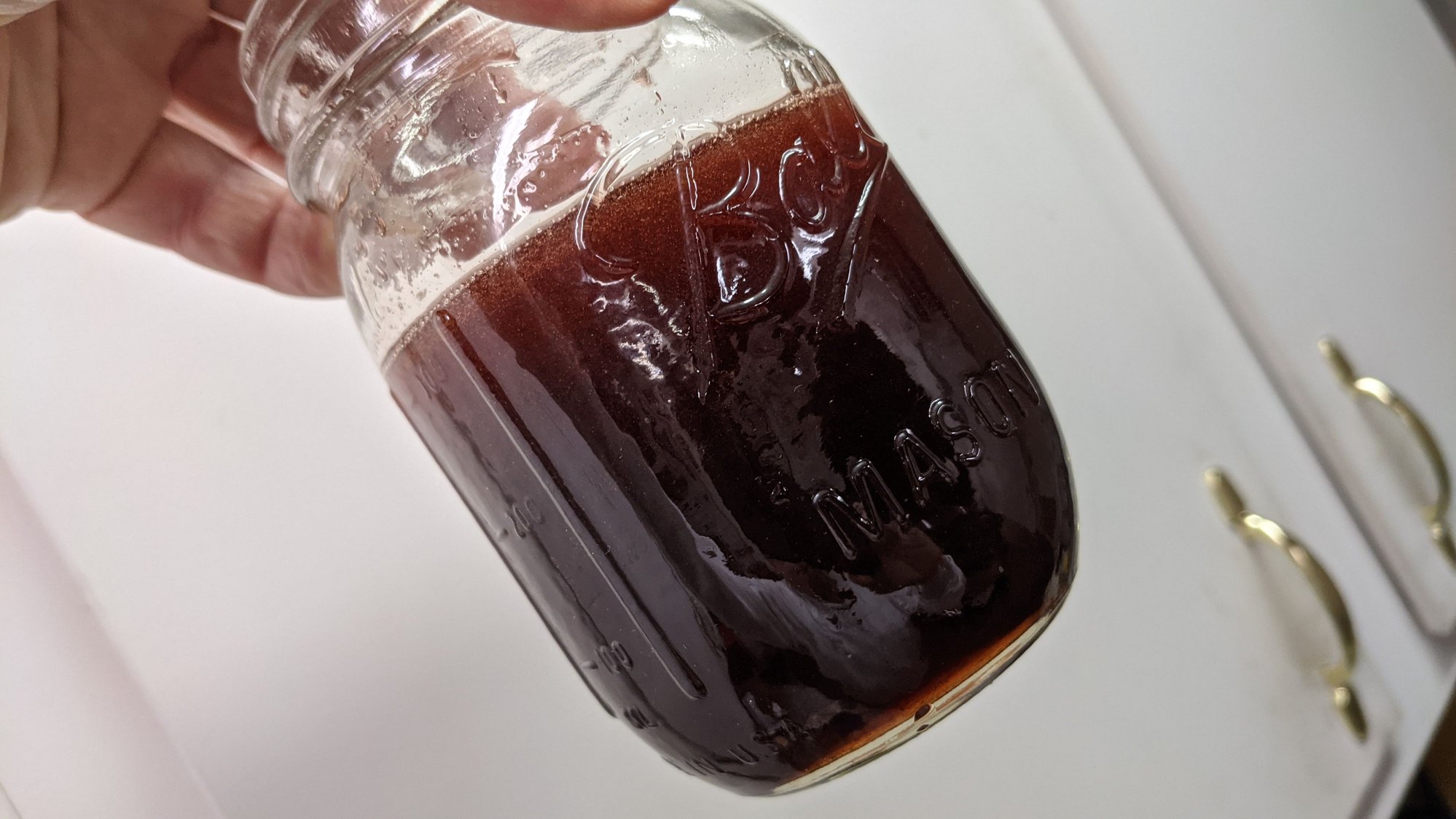

Note the lighter color of fluid that has stratified to the top. Not sure what this is.
I was surprised to see a type of a slime on the inside of the reservoir once drained. I would have thought that the high number of detergents in the fluid would have kept them in suspension.

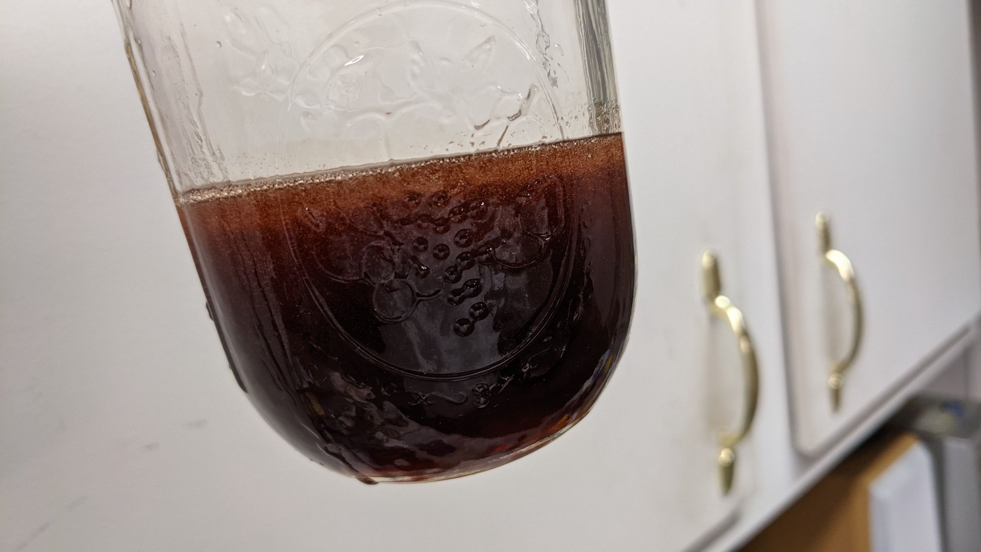

This is the second extraction of fluid from the reservoir. It contains some new fluid mixed with old. The lighter color at the top is a lot less visible.

Thanks leadfoot4 for your reply! Here is the part number I got first, but was surprised when the jug was actually Mobil 320:
https://www.ebay.com/itm/Genuine-Jag...wAAOSw0wte~P0j
Just for grins, what color is the Mobil fluid? The oil that I got from the dealer was green.
Leadfoot4, it is a dark red as shown in the photo. Much darker and much thicker than Dexron. Hope this helps.
