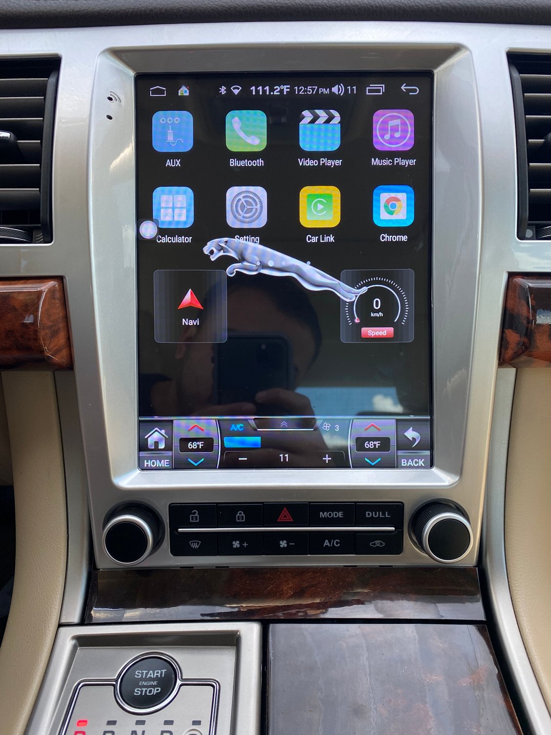

Well I found my problem. I connected the ICM into the blue box and the sound started to work perfectly. Was pretty much plug and play.. Any questions just ask!

Default the actual interface preferences(F vs C, language, etc.) seemed to be fixed.
Is this true per jrx813? Can someone, anyone help me with this? The selection in the settings does nothing for me. Everything just reads celsius. Please, if anyone knows hoe to solve this let me know.

Idk man mine was as simple as changing it in the settings so you might have a defected set. Don’t put that past these…
Thanks, I have 2 units. A 12 inch for my XK and a 7 Inch for the XF (used in my XK). Sellers all say it's a known defect and not a simple fix on both the XF and XK units. What they don't say is where the problem is. Is it that the blue box or the Canbus box are reading the OEM settings? Mine were set to Fahrenheit and rechecked. Or are Celsius/ Fahrenheit embedded in the code of the Android unit? So how yours is working is a mystery to me when they tell me and others it's a known defect. Appreciate your response.

No problemo Ive noticed the same thing in these threads where someone's works and others don't for no reason besides... yes haha but what i can tell you i did do was connect the ICM into the blue box and looped both the touch screen and the other one(forgot what it was called) and that was pretty much it. The canbus i got was for the xf 12-15 I think it said on it (and I have a xf 2011) but other than my above issue everything seemed pretty plug and play..

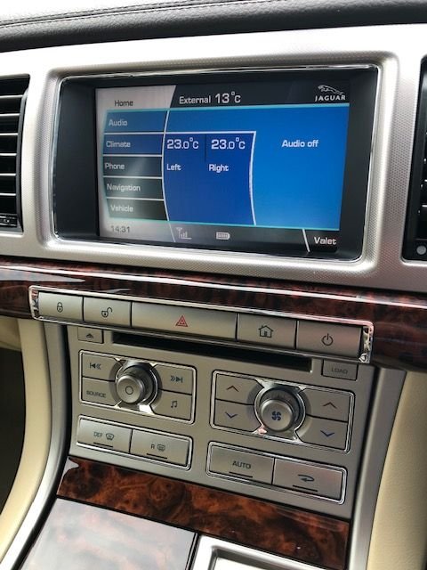

I know these things ultimately come down to personal taste and preference but I like the beautifully crafted look on my 2008 XF. I've gone down a different path and are having apple car play etc installed into the car on 30 Sptember, but retaining the original appearance. The large screen set up of course is a great feature and my 2020 Volvo S90 T6 sport has a large screen and is great to use. But when I get into my Jag I still love the "crafted look".
Graeme
I like the crafted look.
Graeme
I have the same layout but as far as i can tell car play is only for facelift models.
