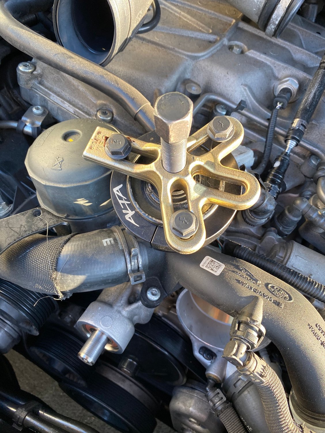

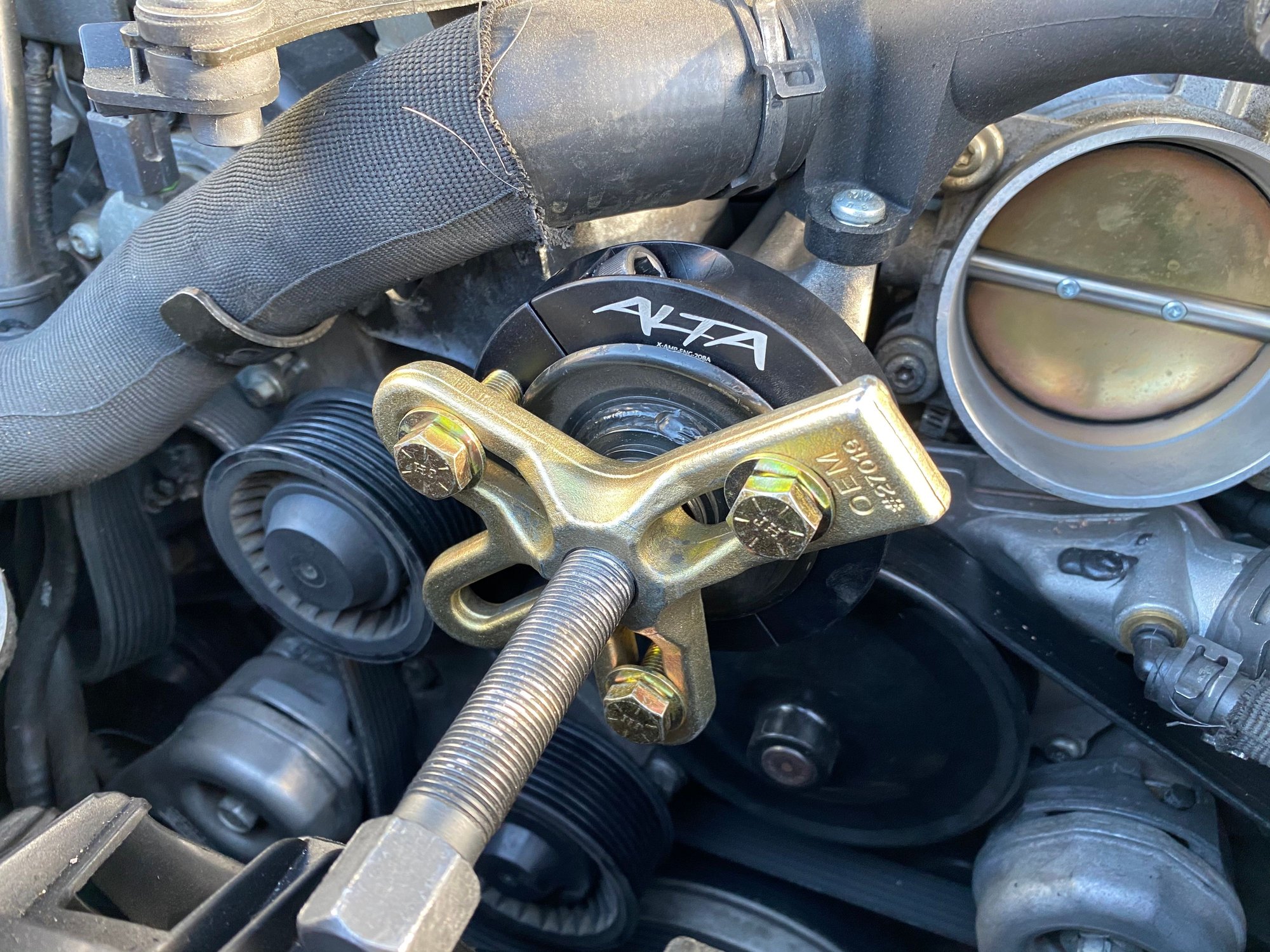

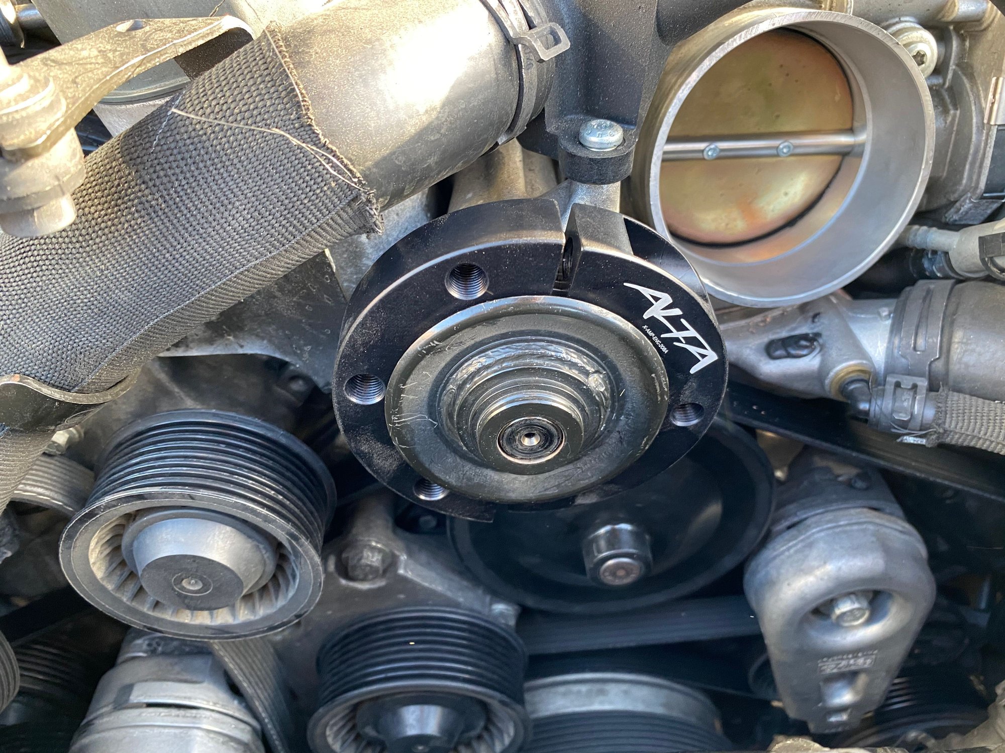

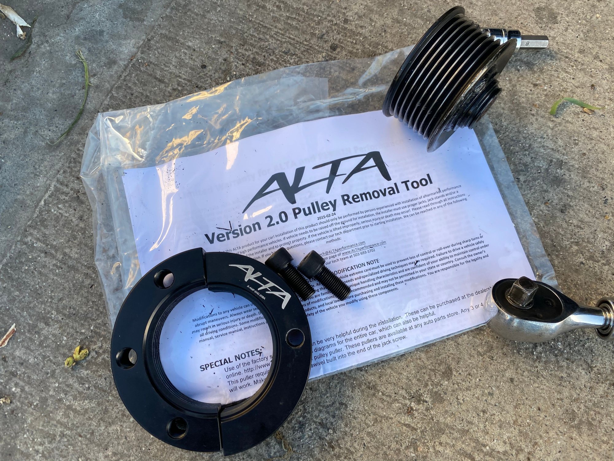

I just upgraded my supercharger pulley last week, took about 30 minutes in total. I have a 2013 XF Supercharged (5.0). I used a tool from a Company called ALTA. Part number is ENG-208. Cost me $65 from eBay, very easy to use. I rented a Harmonic Balancer pulley from Autozone and it fit perfectly. The pulley came off undamaged. Heated the pulley with a Plumbers torch for about 2 minutes, slide right on with no issues. Ill add some pictures of the setup and tool. Both my tune and Pulley are from VelocityAP, makes a huge difference

Hello Swilmer52,
I noticed that you have some water on the engine in the pic after the pulley has been installed and I was wondering if there was some reason for that?
also, just to be clear, did you only heat the replacement pulley before install, or did you need to heat the original pulley before using the removal tool?
I'm interested in all the steps related to the pulling and installing that were necessary if you have time to detail. I have had a pulley in my toolbox for a couple years now and just never got around to it. SInce I am home now, I have time and need a distraction from the TV news...

I only heated the replacement pulley, the stock pulley did not require any heat for the removal. I had a bottle of ice cold water so the replacement pulley would contract due to the instant cooling of the cold water on the heated pulley which will cause it to set onto the shaft of the supercharger. I also used the cold water to keep the rest of the supercharger cool to prevent the heat from the pulley spreading and damaging any seals, just incase. Im located in Southern California, Im willing to loan the tool. Just pay the shipping both ways.
