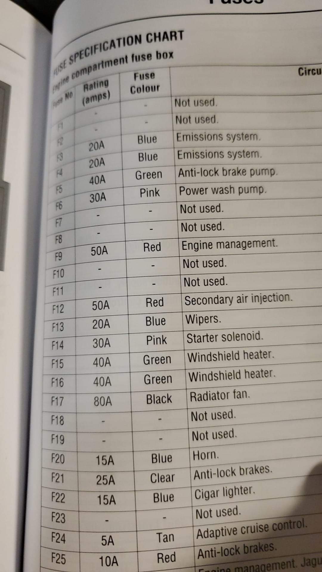

One other thing. Mine does not, nor ever had the 80 amp fuse that says radiator fan (f17) Is that only on certain models?
