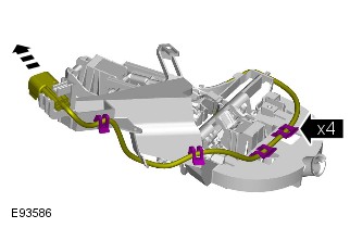

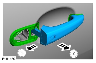

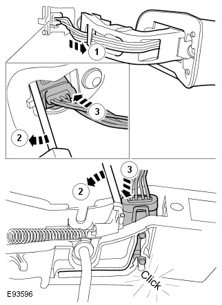

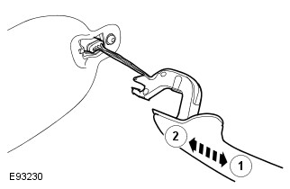

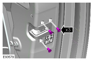

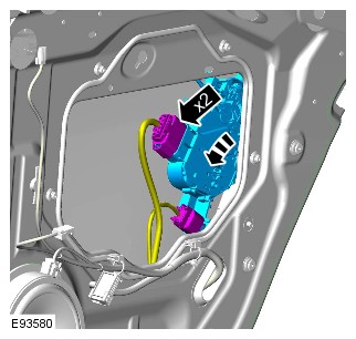

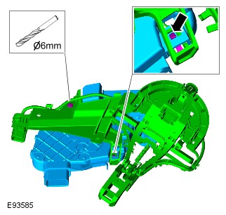

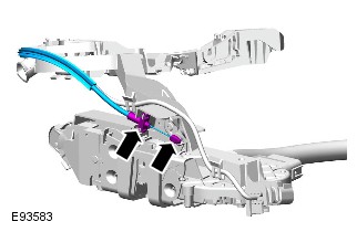

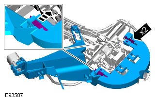

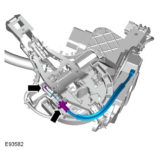

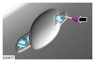

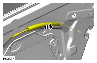

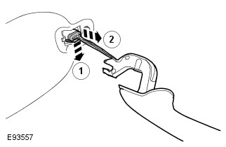

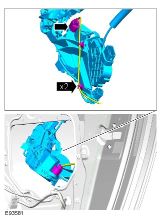

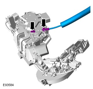

Yep, done a few of these.
Window and regulator need to come out.
The exterior door handle also needs to come out as well.
Once out, there is a plastic cage/bracket that is connected to the latch. There is a rivet that you'll need to drill out and replace.
I suggest getting some body shop tape ( Green ) to tape off areas around the exterior door latch to prevent scratches.
NOTE:
Remove the screw sufficiently, only to release the component.
Torque: 4 Nm
NOTE:
Some variation in the illustrations may occur, but the essential information is always correct.
CAUTION:
Take extra care not to damage the wiring harnesses.
NOTE:
Secure the connection in the service position.
Installation
  1. CAUTION:
    Make sure that the wiring harnesses are correctly located.
    To install, reverse the removal procedure.
Torque: 3 Nm
Torque: 7 Nm
CAUTION:
Note of the routing of the wiring harnesses.
NOTE:
Do not disassemble further if the component is removed for access only.
  • Drill out the rivet.
  • Release the clip.
CAUTION:
