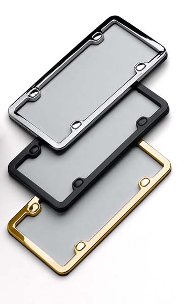

I bought a chrome license plate frame from Altec Products (see photo below or link) that is very high quality but requires four screws.
So I marked the locations for two bottom holes (using my plate as a template) and then drilled into the trunk lid. Then I used a die (think that's what it's called) to make the holes threaded so I could use machine screws. I also threaded the plastic screw anchors on top that came with the car so I could use the same size and type of stainless steel screws for all four locations. I think the screws I used are #8, and the hole was 5/32".
This method holds the plate and frame on very firmly, and since the frame is fairly wide, I use the bottom of the frame as a handle to close the trunk rather than getting my hands all over the trunk lid.
