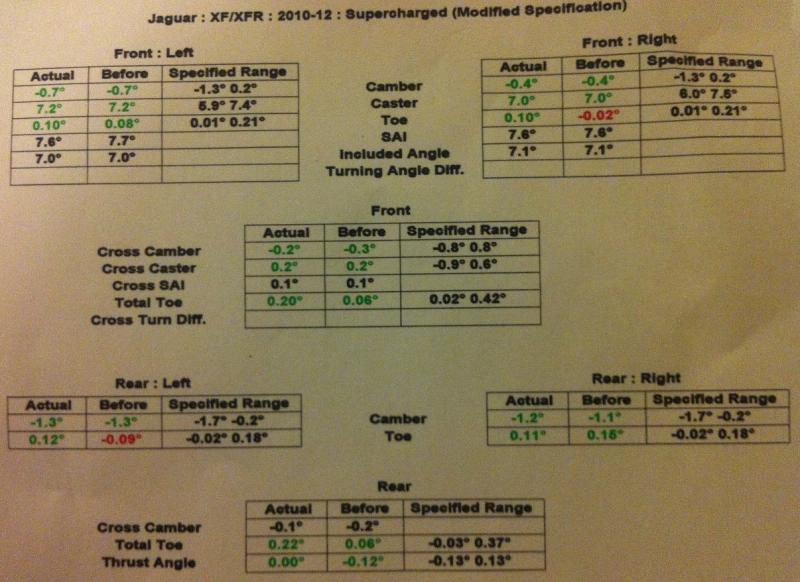

Got the car back last night - all work completed apparently successfully and no charge for anything! All hail, the Platinum Warranty.
Jagular - you win, sort of. The alignment was largely in spec, but the toe on the front right and left rear was a little out. I don't know if that could affect wear on the inside of the right rear, but I guess it could. For general info, pic of the before/after print out below, with specs for the XFR/Supercharged.

Front toe equalizes while driving. The static numbers are measured relative to static spec but when on the move the rack slides over to equalize the toe. Not so at the rear. The left toe out would tend to pull the rear of the car to the left. Turning the steering wheel to counter this would quite probably result in the car appearing to steer straight but all four tires would be dragging to some extent as the car would tend to crab left. These effects would be small for such small amiunts of out of spec but over time could show up as uneven tire wear.

Do you have a reference for this statement? I used to align cars for a living and have never heard this. Please share with us where you learned this.
To the OP: I was going to say that the camber is usually not adjustable in the rear. Your wear looked like toe. It is the diff between the two rear toes that counts.

[QUOTE=MK 82;461183]Do you have a reference for this statement? I used to align cars for a living and have never heard this. Please share with us where you learned this.
Since the front wheels are free to pivot unless you hold the steering wheel it is self evident that the toe divides equally between the front wheels when the car moves. Caster ensures that this will occur.
When you aligned cars for a living you will recall the importance of ensuring that the steering wheel was centered before you commenced any measurement or adjustment. If you did not then the steering wheel would be off center as the car was driven. Then imagine centering the steering wheel but aligning the toe differently left to right. You will see that when the car moves the caster will force the wheels to trail straight and the steering wheel will be off center.
Since the rear wheels do not pivot any toe setting is locked in and can develop a thrust. This is why wear from incorrect toe always looks equal on front tires but can differ on rear tires. Uneven wear on front tires is due to incorrect camber. I discount uneven tire wear from driving habits and suspension design which is not due to incorrect alignment.
