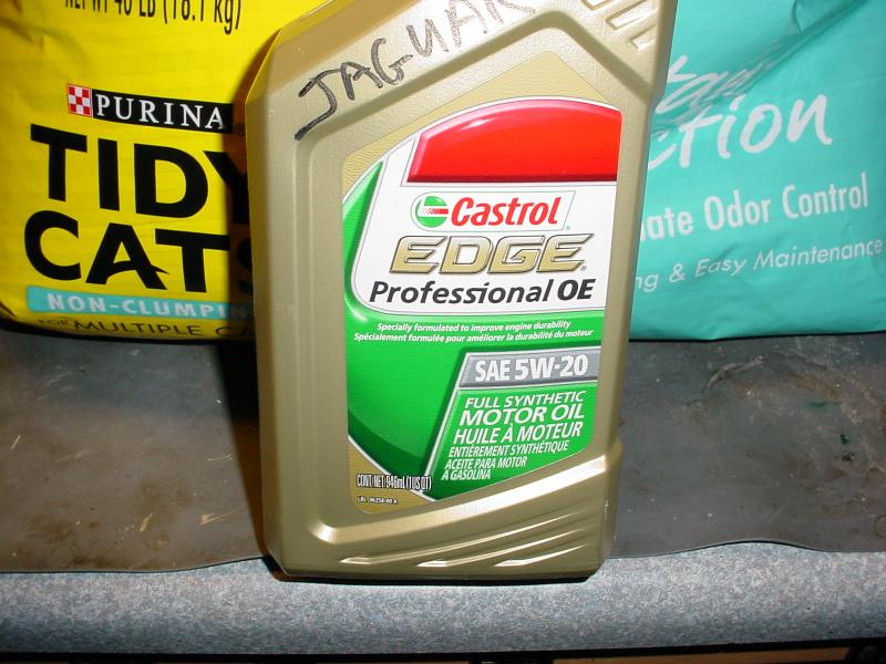

This is the only OIL Jaguar recommends and it is only available at the dealer..
Attached Thumbnails Regular Oil vs Synthetic Oil-mvc-004f-26_zps2f6056ec.jpg

Old May 23, 2013 | 09:15 PM
DPK's Avatar
DPK
Joined: Apr 2013
Posts: 3,115
Likes: 533
From: OKC, OK
Originally Posted by hlgeorge
Castrol Syntec in my Jaguars!
How do you do that Lew?..I mean, I know you have a 12 and is under warranty..How do you change oil with other than what Jaguar Recommends without voiding their warranty and do you do it yourself?, Because from what I know, the dealer has the pumps to suck it out as there is no drain plug per se, that will get it all out.....Just curious
