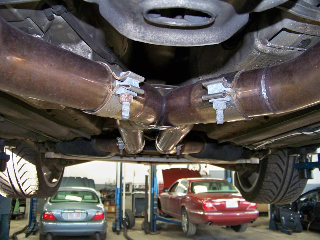

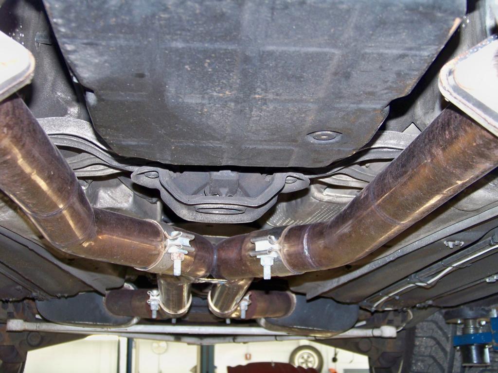

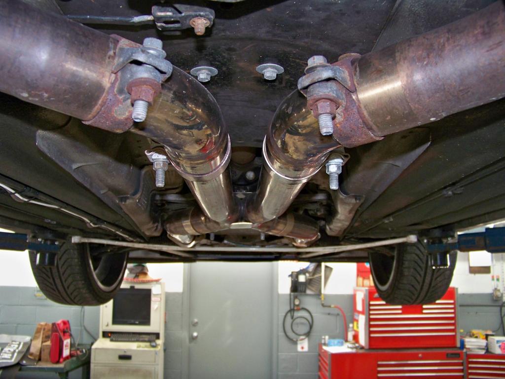

Here is a couple of pictures of the X Pipe I had made for my car. I purchased the Pypes narrow tunnel pipe & stainless steel pipes for the back & Nameless Performance front pipes with flanges to mate up with the Nameless track down pipes. It was made as a direct bolt in replacement for the Arden center section we took out. The X Pipe took about 12 hours to fabricate but was well worth it.
Did you remove Cats on this beast ? Or high flow cats ? Thanks

I have Nameless track pipes, no catalysts.
