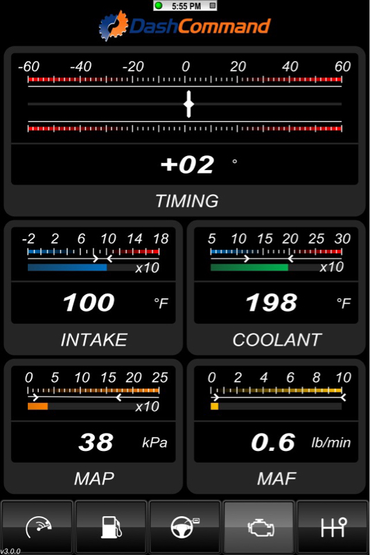

I took the TCP intake off, put stock on and just came back from a cruise and the Intake temp stayed around 97 and under boost it dropped, then coming off throttle it would go up. But pretty steady at 97. So I parked and it reached 104. This was with stock intake. I will put the TCP intake on tomorrow and do the same thing. We will see if stock is better and if the intake temp is higher.
Attached Thumbnails Removing Cats-image-961582354.jpg   Removing Cats-image-349811396.jpg

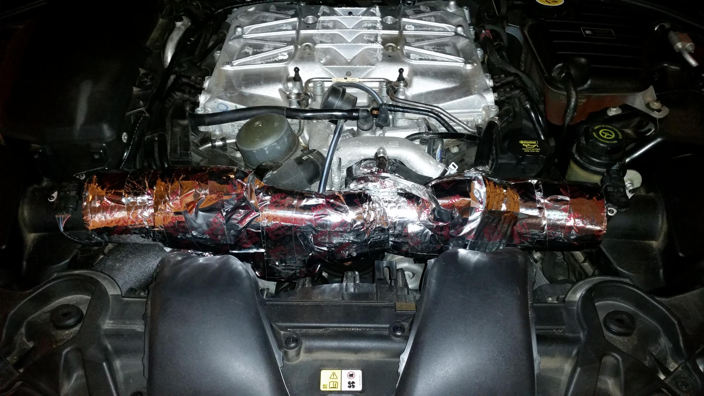

Well I just insulated the entire intake from air boxes to TB with this stuff that I had laying around. Reflectix 16 in. x 100 ft. Double Reflective Insulation with Staple Tab-ST16100 - The Home Depot
It is not the best but better than nothing and it didn't take very long to due.
The results are it does work but not when you are driving. I did not notice a change from last night at a constant 50 mph the temps were the same. I did however notice a difference when idle. The temps did not increase near as fast so that tells me the insulation was working. Also i drove with the engine cover on and off and did not notice a difference in temperature.
So now I am wondering what is causing the high intake temps maybe it is the intercooler piping? As said above they are very close to each other and they do run near some radiator hoses in areas that probably do not get a lot of air flow. Also is the small radiator on the lower passenger side intake for the intercooler?
I know supercharged engines will have higher temperatures and if the intake after driving around for an hour is 85° yet the intake temp measured by the computer is 106° where exactly is the computer measuring the temperature?

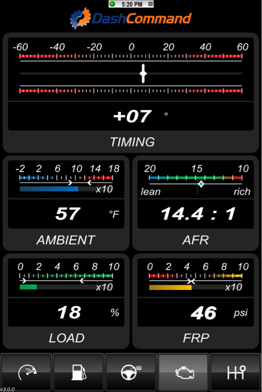

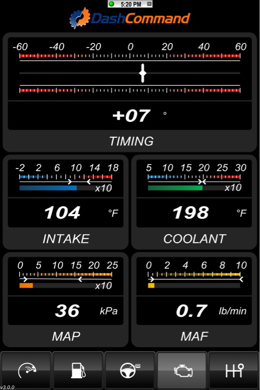

Results are in. I installed the TCP aluminum intake and followed the same procedure. The car when on steady throttle stayed around 91, which is 6 degrees better than the stock intake and when parked, it sat at 100 vs 104 with stock. This could all be due to the weather, temps are in the 50,s as you can see with both tests. So in cooler weather the aluminum TCP wins this battle. I will be very curious when the weather here reaches 100 degrees if the outcome is the same. I did also notice that I averaged about 2 psi more VAC as well.
Attached Thumbnails Removing Cats-image-2224457763.jpg   Removing Cats-image-1725543515.jpg

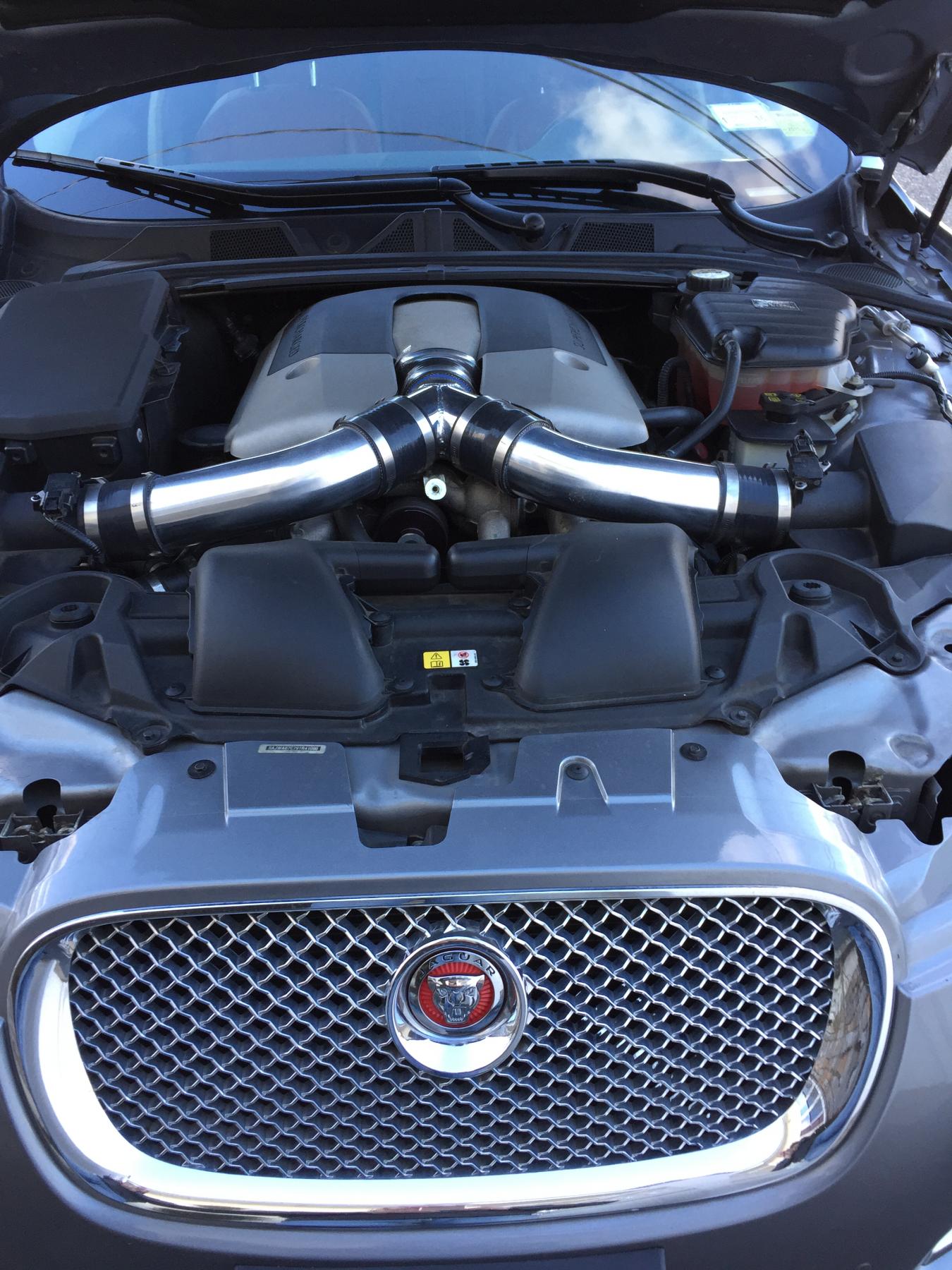

TCP just started offering a 5L intake for all those 5L guys. I think that's is the first 5L intake on the market at the moment.
Shout out to Blackcoog!
TCP Intake
