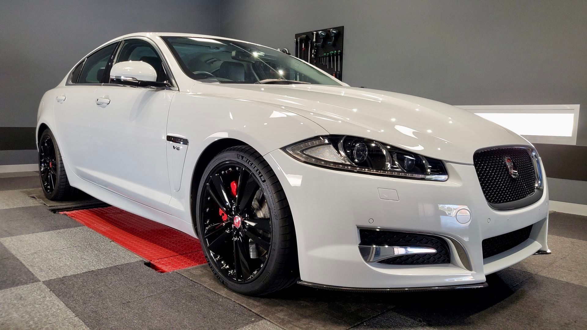

Hi All, I have a 2015 (x250 facelift) XF 3.0L SV6. I am wishing to replace factory 20" Kalimnos wheels, for a change. The factory wheels are 20"x8.5" ET49 for all 4 wheels, I run 255/35ZR20 Michelin PS4S tyres on them. I am looking to change the offsets. Most people achieve this by adding spacers, but, seeing I am buying new wheels I am thinking about just buying wheels with the necessary offsets. So I am thinking 20"x8.5"ET 34 on the front and 20"x8.5" ET 29 on the back. I intend to use the same tyres. In changing the offsets, do I have to worry about anything else such as new lug nuts or wheel studs?

Those offsets should work nicely, same effect as 15 mm spacers on the front and 20 mm spacers on the rear.
No need to worry about studs or nuts as they are not effected by changing the offsets.
But two things to consider:
1. Whatever wheels you get may not use the uncommon Jag OEM "mag seat" (flat washer) nuts and may use the much more common "acorn" or "bulge" nuts instead. OK if the wheels come with nuts but it will cost you extra for new nuts if they do not.
2. If the new wheels use mag seat nuts then consider ditching the crappy OEM nuts which are prone to break and get solid one piece nuts instead.

Hmm I’m now thinking I should do ET29 all the way round to enable rotation. I measured what the distance is for the current tyre walls to be flush with the panels and it’s 20mm in front 25mm in the rear.

Seems unusual to get different offsets that are so close as you can't rotate. If you're doing that I'd get staggered and put 9.5 or 10inch on rear and 8.5 on front
Also depending on wheel company you may not be able to specify precise offsets so you may have to use spacers and a different offset to get the look you want
Some 20inch wheels look great but bend easily. Do your research on the company!
I put Rohana RF2 on my 2010 XF SC 5+ years ago and been v happy with them. Without spacers. But the rear hubs of the XF SC and XFR have a different offset than yours
Of course goes without saying, you need to get the 5x108 bolt pattern for it to work. And I'd strongly encourage hub centric (might need hub rings to match the hub size on the XF). Otherwise the wheel is centered by the bolts rather than held true by the hub. And it can easily misalign

Yes I think I’ll do ET29 all around. Although I’m not sure my tyres have ever been rotated by the dealer over the last 6 years. Am probably going to get custom wheels, I think they get them in with the correct PCD 5x108 and then machine the centre bore 63.4mm and the offset to customise. They are so cheap compared to the factory wheels (which are about $6K) I’m almost thinking they are disposable. If one bends just buy another one for $600. I’m likely to put the factory ones back on at some point. Just feeling its nice to have a change at the moment. As the new wheels are likely to be more open I’m making the brakes more visible, so will probably upgrade those as well. The rear brakes are embarrassing.

Problem with going staggered is the OP wants to swap all four of his existing tyres over - all MPS4S 255/35ZR20.
These may be a little skinny for 9.5" or 10" rear wheels.
If I were the OP I would also consider going staggered with 10" rears and 8.5" fronts, and get a new set of rear tyres to suit, say 285/30ZR20 (same as XFR spec).
That way he would have the looks and stance he's after plus more rear traction and grip and a spare pair of front tyres to boot!
I did that with my old XFS, using Coventry Whitley "hyper silver" wheels, see here: https://www.coventrywheels.com/Jagua...-rims-whitley/
(scroll down a ways for the different sizes and offsets).
Here's a pic:
