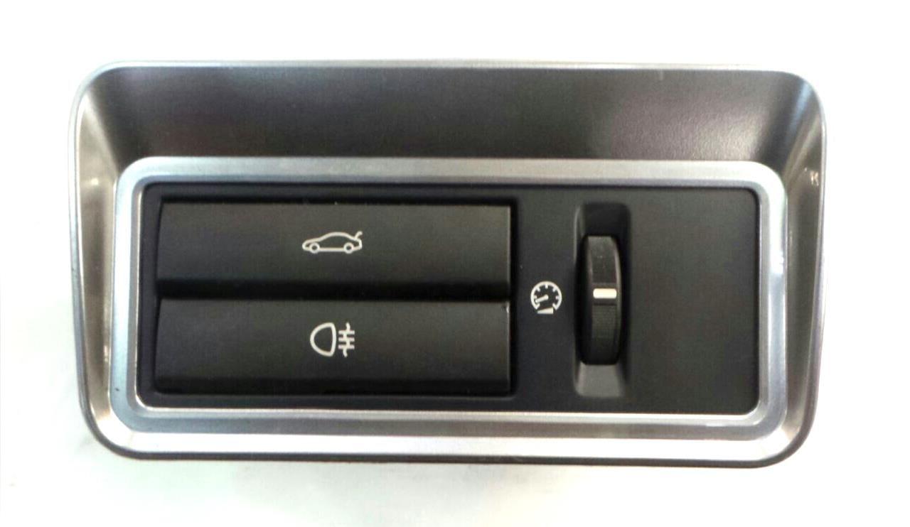

wait what?
down the left hand side almost under the dash should be a switchpanel that looks like this:
and again here, down the left hand side, in silver here.
