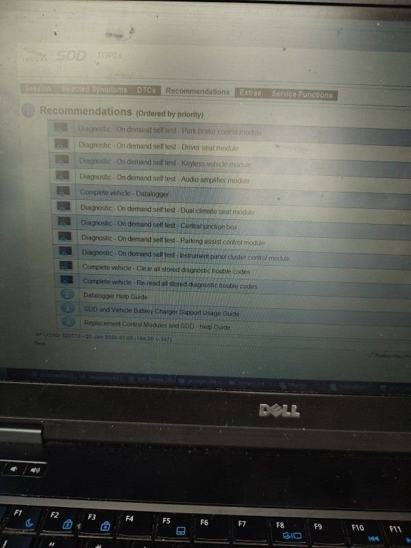

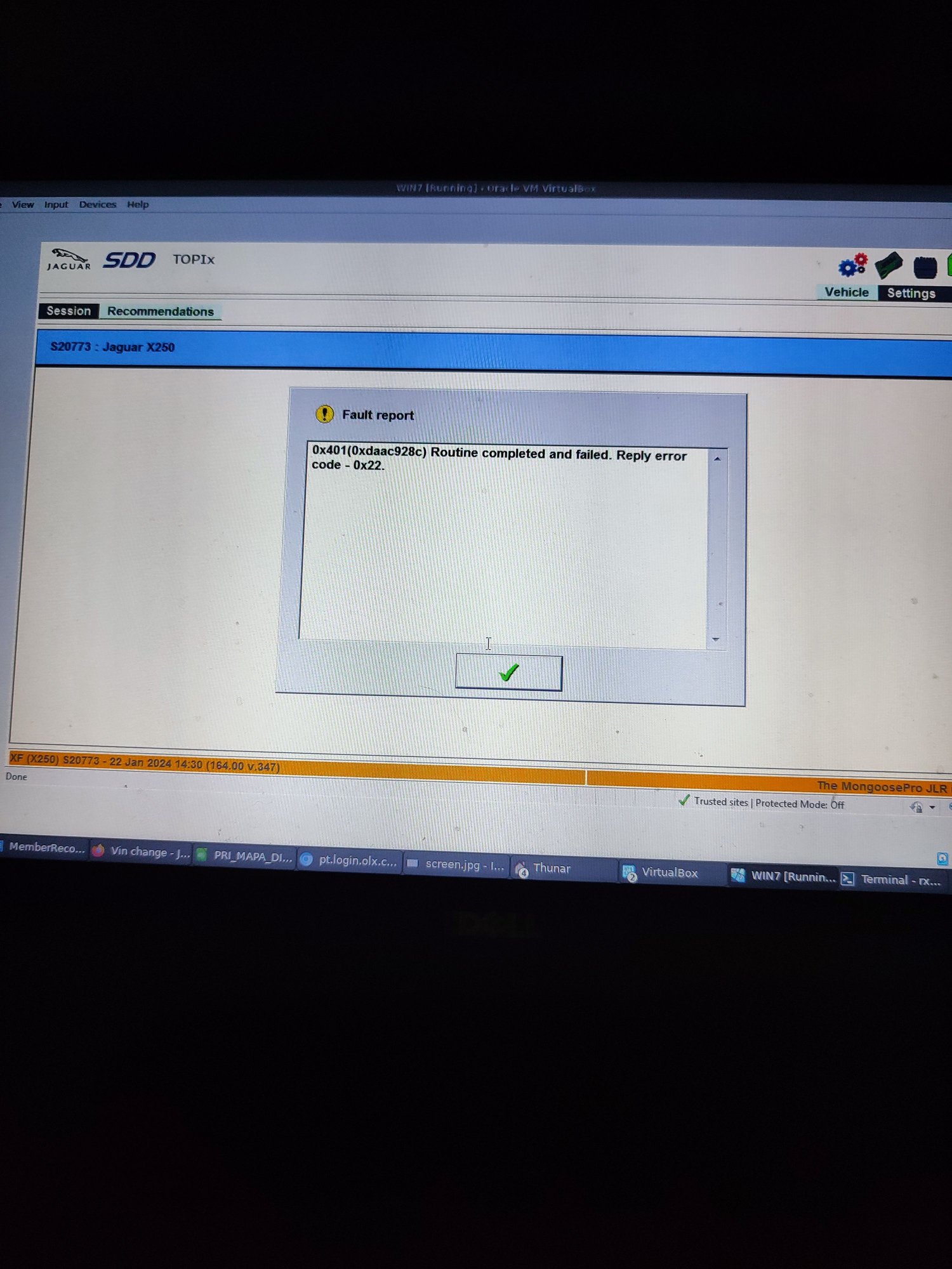

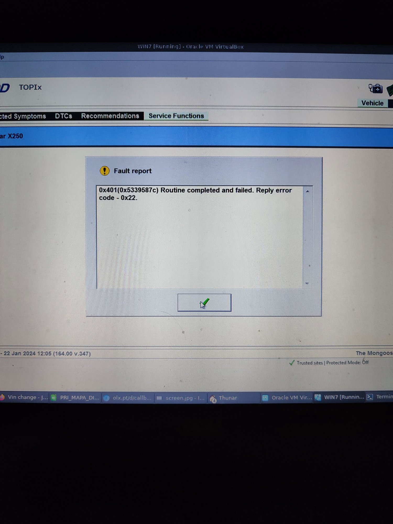

Hi!
After having some issues with the old mbcm, I replaced this module and the previous issues are gone. The problem now is that I'm unable to configure the "new" one as a new module. After running the "new module auxiliary junction box" it runs into errors at the end, and doesn't let SDD to finish (routine completed and failed - 0x401). It gives the above screenshots. This must be done to rewrite the current vin into this new module, otherwise the car will not start (vehicle identification number) because it has the previous vin set on it .
I already tried, other modules updates, battery reset, etc and I am a kind of lost...
Some help would be appreciated.
Thank you!

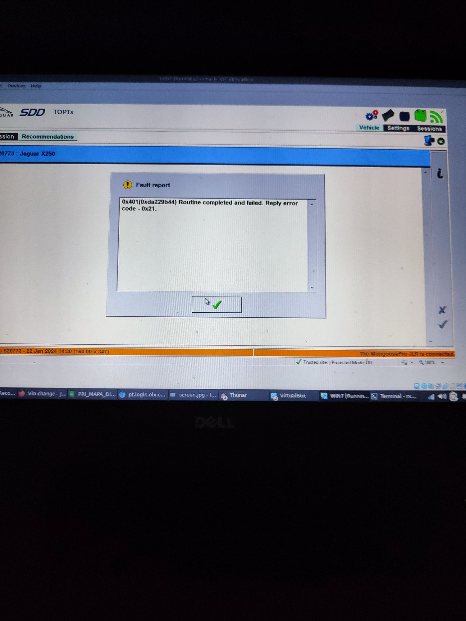

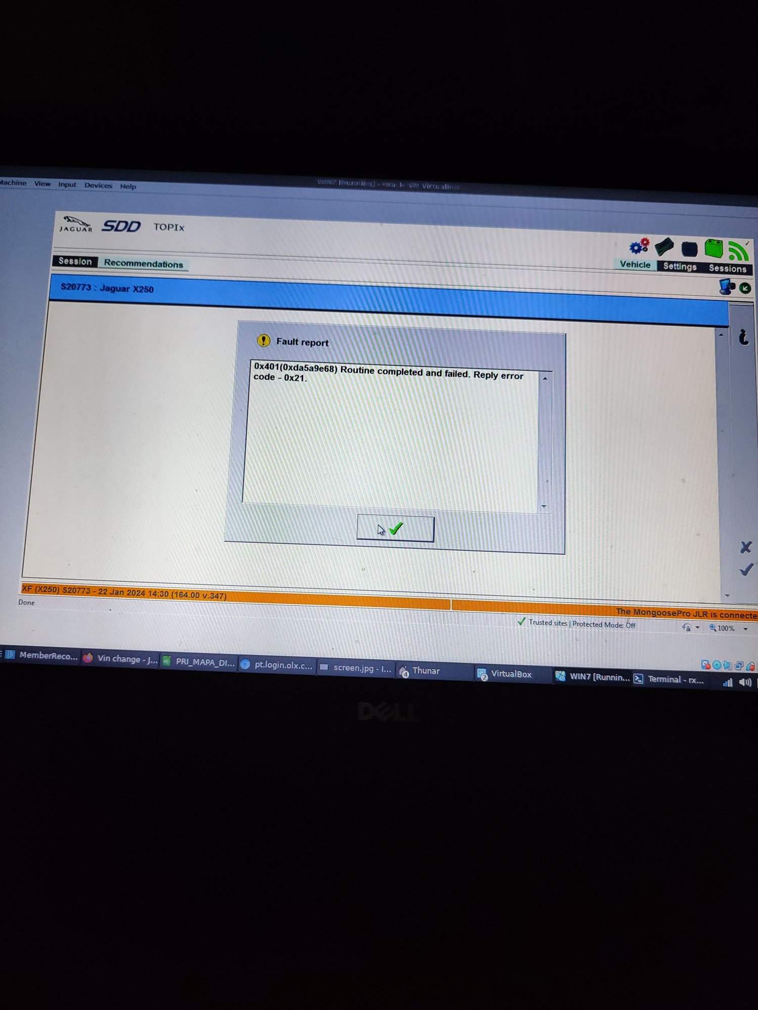

0x0401 is a security init for a steering column lock module or a PCM.
0x22 = answer from these that "Condtions are not correct"
0x21 = answer from these that "Busy,repeat request"
There's no way that SDD would overwirte a VIN in a FSJB or RSJB, however, if the security related stuff would pass, it would be allowed to start a vehicle even with a wrong VIN in these.
