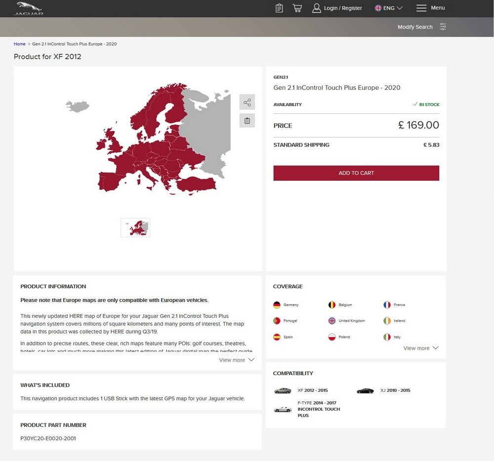

Morning all first time member looking for help, I have a jaguar XF 2011 model with the 2012 facelift, I have been trying to do a map update with usb flash drive, everything was going fine upto 85% until I put the car into the garage and they disconnected the battery, I had to restart the upgrade from the beginning and now it won't go above 45% does anyone have any ideas of how I can reset the maps to the original to try again or any other solutions to the problem, thanks in anticipation bill

Hi Graham yes I am using an OEM update thanks for your response

something that came to my mind - it could also be that the USB stick itself has an issue. Since you ordered it through official channels you may want to try to get a free replacement before trowing expensive parts at your car.
