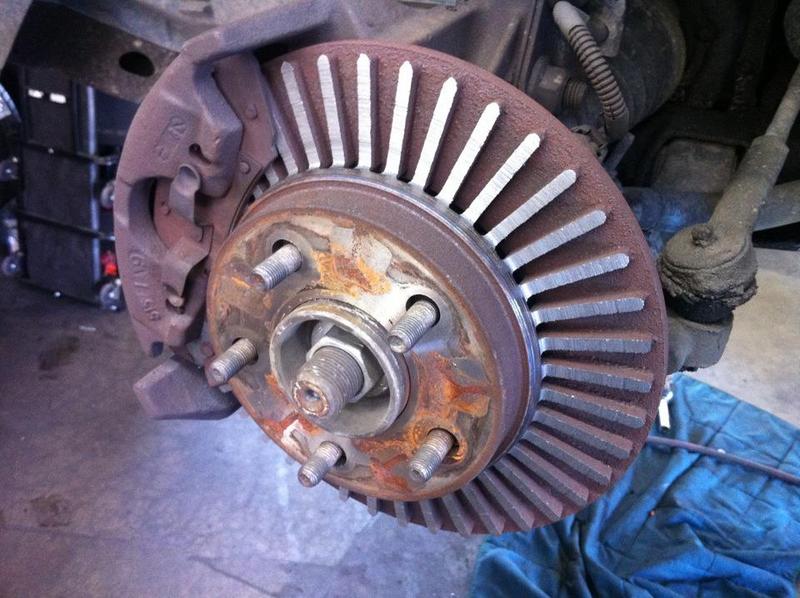

Old Nov 19, 2013 | 11:28 AM
Mikey's Avatar
Joined: Oct 2009
Posts: 11,057
Likes: 2,272
From: Perth Ontario Canada
Originally Posted by JagV8
MoT tester looks at brake pad thickness but not really at disc (rotor) thickness because they'd need a gauge and probably have to remove the wheels. They do look for any obvious cracks etc in the discs. They check braking efficiency but worn discs would probably pass until well under the min thickness.
Braking efficiency is not affected by rotor thickness. A disk is a disk
I suppose discs would eventually wear so thin they might shatter or the pistons would leak or not brake or whatever, but not at just below min thickness.
These cars came into a shop with only a complaint of 'unusual noise'. I'm not suggesting that anyone keep similar rotors in service.
