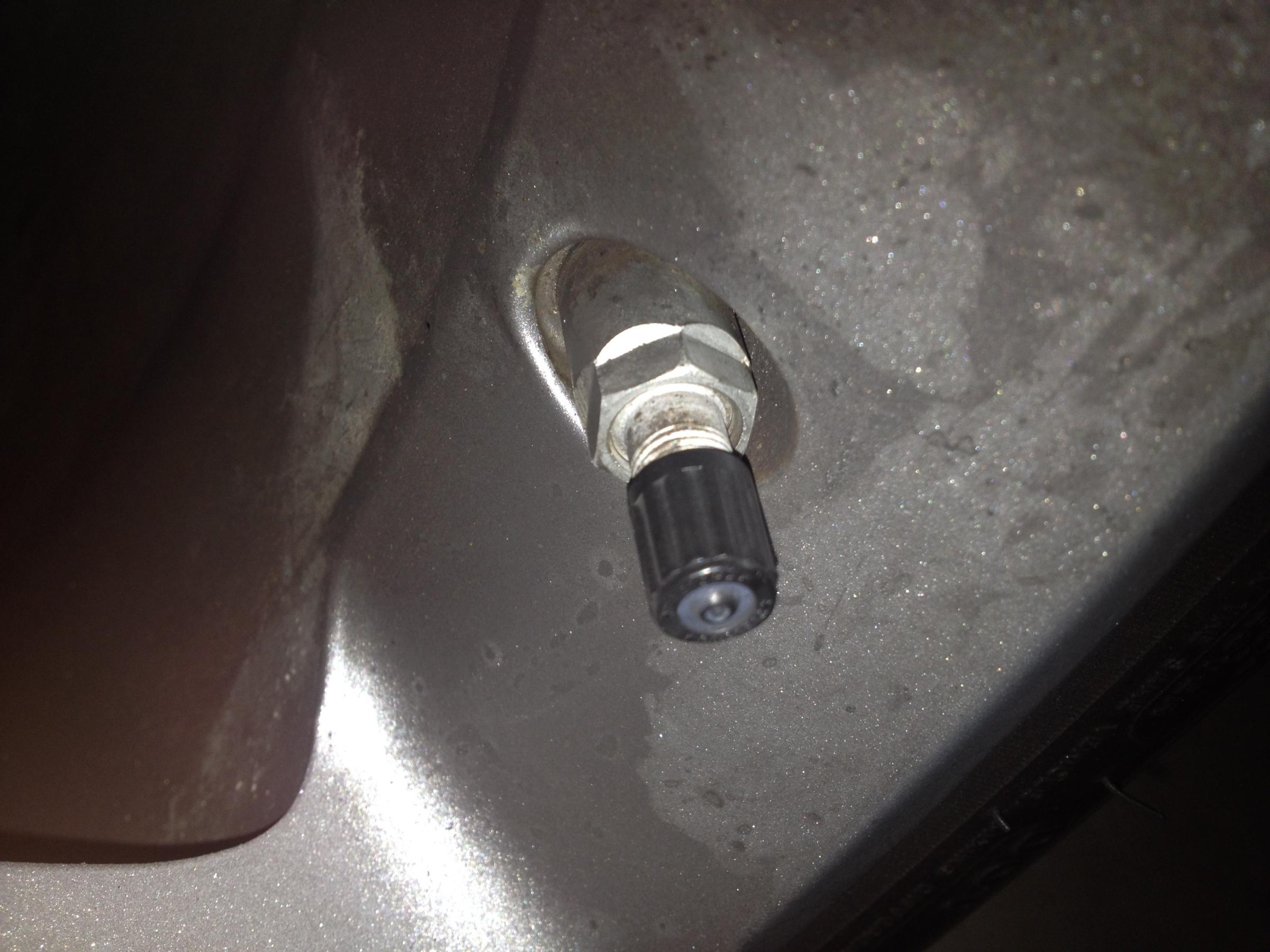

The TPMS sensors are bare metal, not anodized so I guess at some point they have been changed. The car came with new tires so is it possible when changing the rubber the tech has messed them up somehow? They don't look new enough to have been changed with the most recent tire change.

The TPMS issues you are experiencing could well be from non OEM spec valve stems. It is very easy for an incompetent tire shop to damage all four sensors. There are required techniques for fitting and removing tires from wheels equipped with TPMS valve stems.
Can you post a photo of one of the valve stems showing the nut securing it into the wheel?

That looks like the updated one, which is good. They added a taller nut to support the valve stem better.
