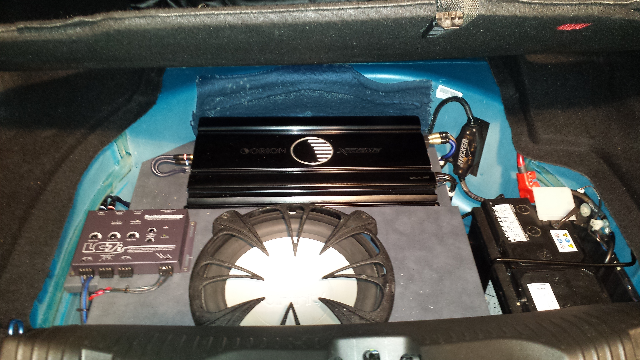

From a thread I posted in about 6 months ago...
Totally worth it!
Attached Thumbnails Subwoofer in Spare Tire Well-sfasd-045.jpg   Subwoofer in Spare Tire Well-sfasd-049.jpg   Subwoofer in Spare Tire Well-jagapr2013-007.jpg   Subwoofer in Spare Tire Well-jagapr2013-014.jpg
Totally worth it!
What size woofer and how much power is your amp putting out? Do you ever put the spare in on trips?
It's a 12" Treo Engineering RSX in a 1.5 cubic foot sealed box. It's getting about 500 watts rms via a Treo RSX 1600 monoblock. I used a simple PAC LOC with remote turn-on to wake the amp up when getting fed the oem speaker-level subwoofer signal.
I never put the spare back. I have AAA and I rarely go more than 50 miles from home.

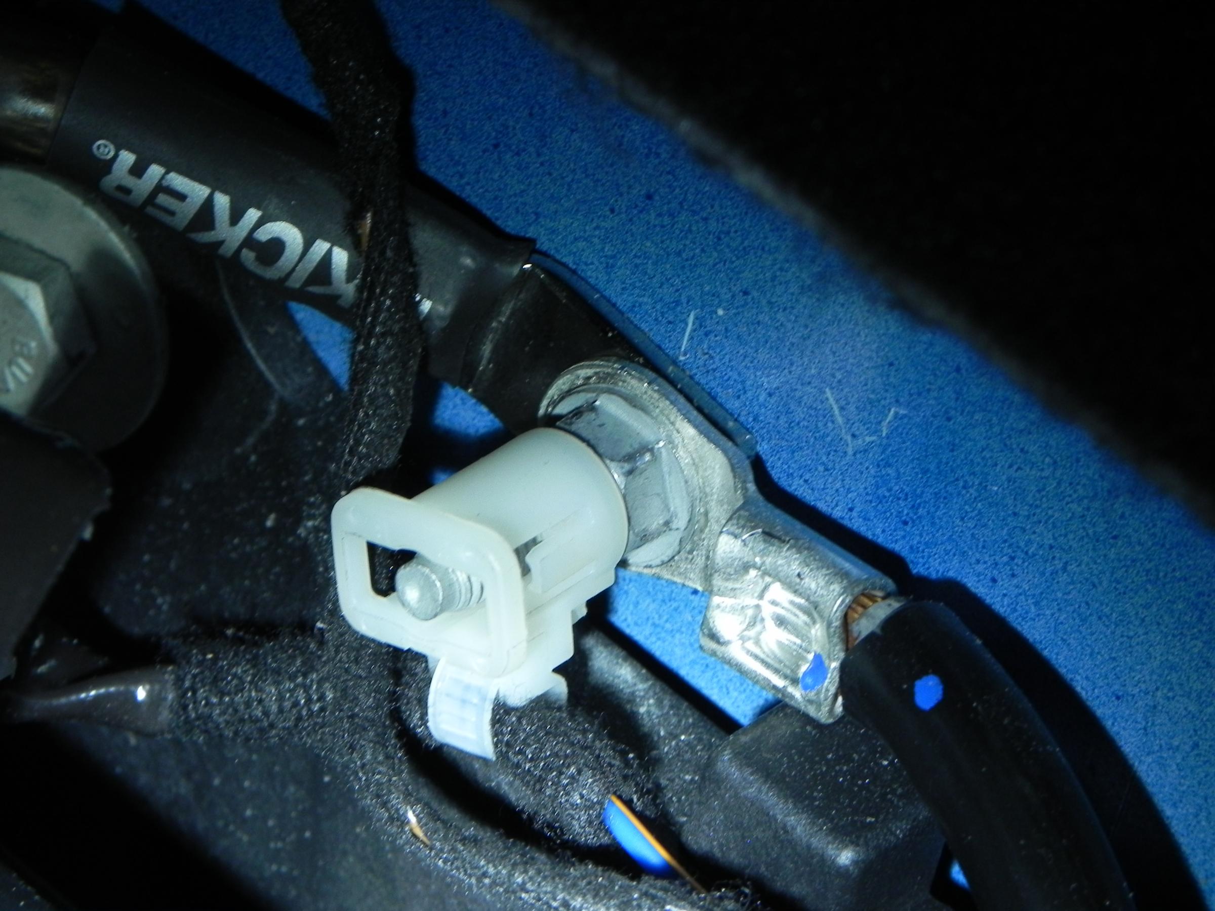

The box I made is 24x14x8 outside dimensions. Using 3/4" MDF, you'll end up with about 1.0 to 1.1 cubic feet of internal space. That is enough for some 12" woofers and almost too big for many 10" woofers. The biggest limiting factor is the mounting depth of 6.5". You could make it taller and less deep, but know that the whole box, including any grill, would need to be under 10" (the depth of the well).
I made a shelf for the amp that's 14"x11" that I attached with brackets and cut the back corners off with a jig saw to make fit. In my install, I mounted a 1 farad capacitor under the shelf, but it isn't necessary unless you are using a very high power amp (over 500w) that isn't Class D (Class D are digital and much more efficient - almost all new mono amps are digital). Make sure to get an amp that has speaker level inputs and can turn on with the signal from the speaker wires, so that you don't need any outboard signal processor like I have. If you want something that works very well for this and has the Accubass technology to help with the bass response rolloff, there is a two channel version of my processor called the LC2. It would be perfect for this application, but takes a little more wiring to get done. Here is a link to the product AudioControl LC2i 2-channel line output converter for adding amps to your factory system at Crutchfield.com
To wire the amp, just use 8 gauge power and ground if you're under or around 500w of power, which would be plenty for either a 10 or 12. Make sure to have a fuse that equals the total draw of the amp plus a little more (probably in the 60 to 80 amp range) within 18" of the battery. SEE FOURTH PHOTO BELOW Leave the fuse out until you have it all wired. Take off the negative terminal. I didn't even take off the positive cable. If you look at the positive battery terminal, there is a screw that has another wire attached with a nut. Just put the power wire under that nut with the other wire and run it out the top side (about the 1:00 position from the back of the car). SEE FIRST PHOTO BELOW That allows the white cover to go back on. Take off the white clip on connector and unscrew the nut that the ground is attached to the wall of the tire well. It's actually a screw on both sides of the nut so don't worry if it comes out. I put the battery ground on first then the stereo ground. SEE THIRD PHOTO BELOW
I cut off the factory connector for the stock subwoofer and replaced it with bullet quick connects. SEE SECOND PHOTO BELOW Each pair in the factory wiring is twisted together and the orientation is (+) purple/grn (-) green/wht; (+) wht/brn (-) pur/org. Since you're going to be running a mono signal, it doesn't matter which will be right or left. Take some 16ga speaker wire and put the opposite part of the bullet connector than on the factory wiring and connect them accordingly. Make sure it's long enough to reach your amp.
Connect all the speaker inputs, the power and ground to the amp. On your amp, set your crossover to about 80-100Hz and your gain to about half way. Put the fuse in and see how it sounds. As I said before, you can use the "Sub" controller on the B&W system to dial in the amount of bass you want. If you're in the center of the range with music that has a normal amount of bass, that's a good place to start. That way if you have music that has a lot of bass (say rap) you can turn it down a bit to where it's balanced with the rest of the system. Same for music with weak bass, you just go up instead of down. If the bass is too strong at the half way setting on the B&W, turn the gain on the amp down a bit until it gets balanced. Also, if the bass sounds like it's too punchy in the top end, turn the crossover down a little at a time until it blends in correctly. You may have to redo the gain setting after getting the crossover frequency right. Just keep a small screwdriver in the car for a little while and keep playing with it until it sounds good with all music you listen to.
I also put weatherstripping along the plastic trunk tread plate where the cover makes contact with it to keep it quiet with the added bass. Works very well.
Attached Thumbnails Subwoofer in Spare Tire Well-dscn0555.jpg   Subwoofer in Spare Tire Well-dscn0553.jpg   Subwoofer in Spare Tire Well-dscn0554.jpg   Subwoofer in Spare Tire Well-dscn0556.jpg
