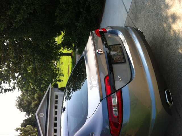

Finally got my other 2013 tail light so I installed them yesterday. Had to cut wires but they easily color code the exact same wires. I only needed to use resistors on the back up and signal wires, the two green ones on passenger and green and white on drivers sides. No codes thrown, and all works perfectly! Love the new look!!!

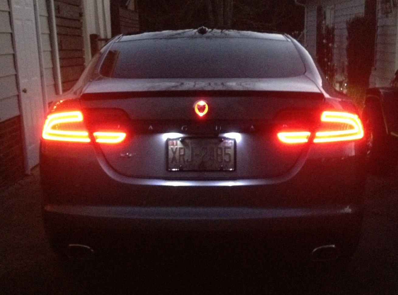

Close up.

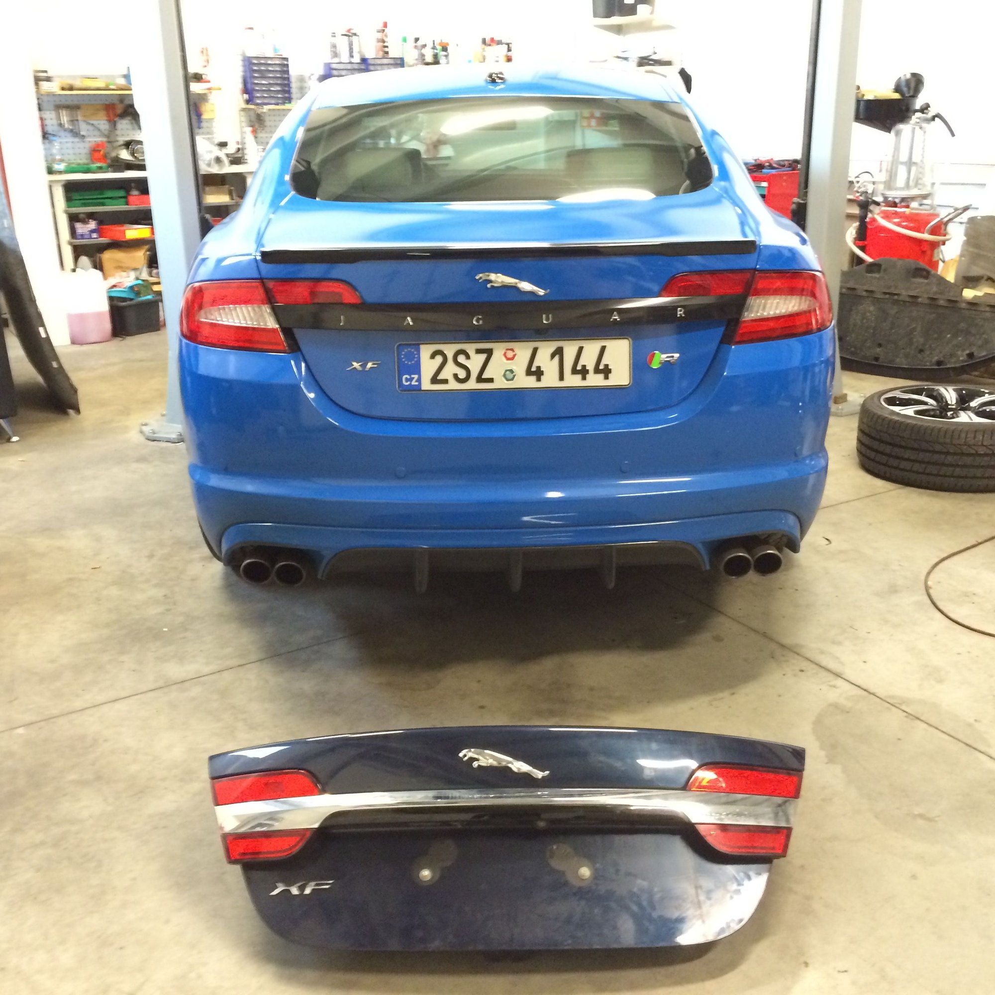

So you're changing the whole boot lid! I did it the hard way! I actually cut the new lid lights apart, with a dremel, then used silicone and sealed the opening. I drilled holes in the boot lid for the marker wires and wired them to the license plate lights. Used two part epoxy clay to attach. Just to be safe, I even sealed the edges with black silicone caulk.
