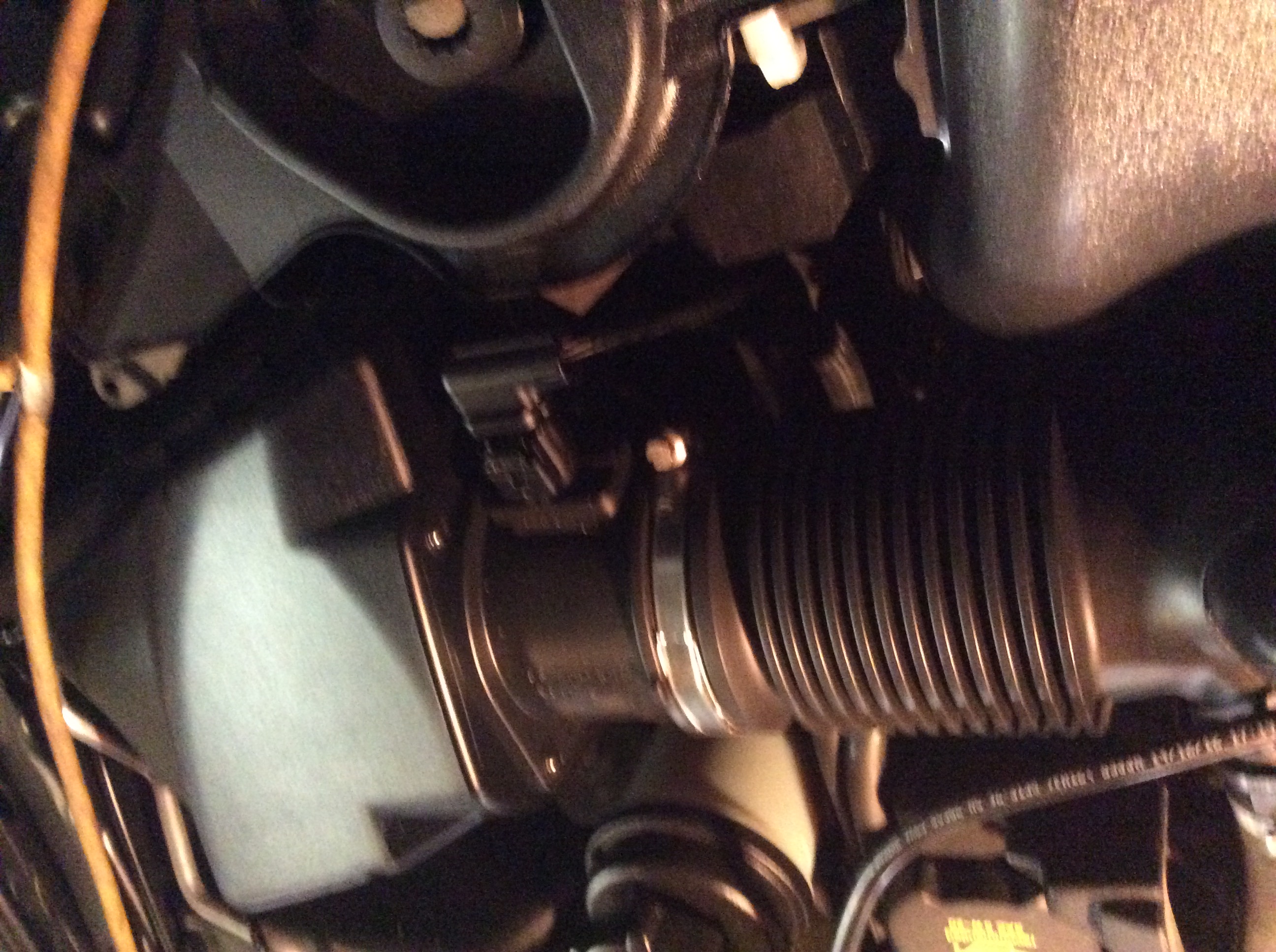

I recently traded in my 10 NA 5.0 for a 13 SC 5.0.
My 10 intake was very similar to your setup except the "y" connector into the intake is centered on the engine because it does not have the supercharger in the way.
My 13 has the "y" off-set to make way for the supercharger.
But here is where it gets different. My MAS is not removable from the intake pipe (like my 10 NA and the older SC cars). It is a 1-piece and has a 3 bolt flange that bolts to the air boxes.
I would love a pipe from the TB to the MAS pipes and keep the air boxes. I will attach a pic of my 13 SC 5.0 for you to see the MAS.

10 XF Premium
I am not sure on the compatibility of the y-pipe with the new style of sensors. Both setups do look very similar but I cannot tell for sure based off of the pictures. To start can anyone verify the new sensor tube is still approximately a 3" diameter If so it will probably be fairly close to fitting.
