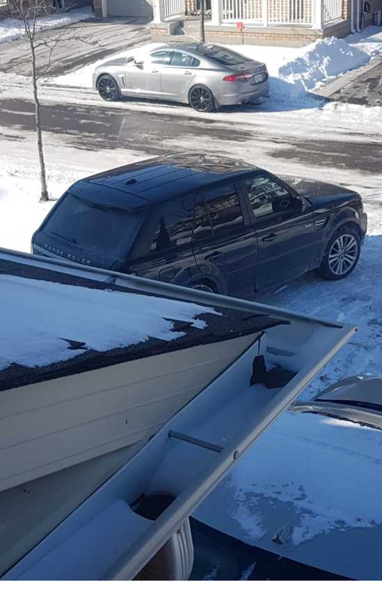

Hey, I installed a set of Jaguar Kasuga rims (From the XJ, look very similar to Caravela) With 255/35 R20 FRONT and 285/30 R20 Rear. The rims are staggered measuring 9 inch front and 10 inch rear. The front offset is identical to all (Most) Jaguar XF rims at 49 mm front and rear is 46 mm (help them stick out a tiny bit).
Here is a chart t help you get a better understanding of tire width in reference to what the wheel can accomodate.
Based on this chart, Kasuga rims can accomodate up to 285 (Max) in the rear on a 10 inch width wheel. Reason for going 255 as opposed to 265 which is max the front wheel can accomodate is due to the rolling diameter difference which would disturb or potentially damage the AWD on my 3.0l XF AWD.
No there is no rubbing or fitment issue, but a larger side wall would pose issues given my current set up. Mind you the ride is rubbish but handling is very planted, and fuel economy is atrocious.
I don't have a decent picture of my car presently, but this was taken by my sibling prior to the car going on a flat bed for a coolant related issue.
