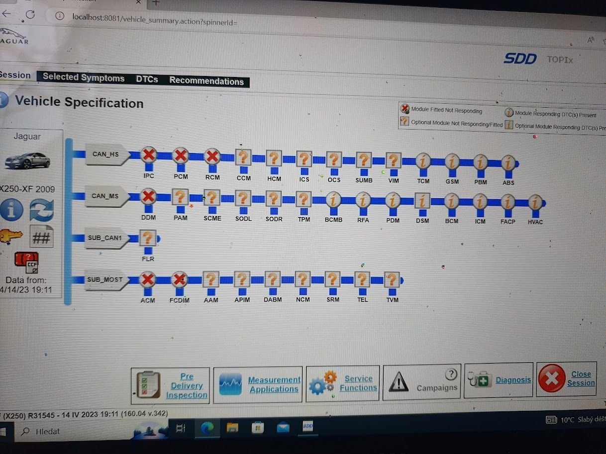

Based on what's not working, I assume the problem is in the front BCM unit. If I connect a unit from another car will it at least work somehow, or until it is reprogrammed, will it not work?? I have a borrowed SDD diagnostic and the status of the units is as follows:

We did not get those cars in the US so I can only suggest that all those red "X"'s must be cleared somehow.
Can you explain a bit what the dealer meant by the car is faulty and NOT worth repairing?
Maybe they found a bunch of expensive stuff bad?
It's great you have a working SDD and keep at it because you have a list of modules not communicating with SDD. Now you cut off the top right hand corner of the SDD screen?
Is the battery symbol green in SDD? Are you running a DC power supply attached to the car when using SDD and NOT a battery charger?
Also note that even with a properly tested/charged battery you might be ahead to temporarily try another fully charged battery? How old is yours now?

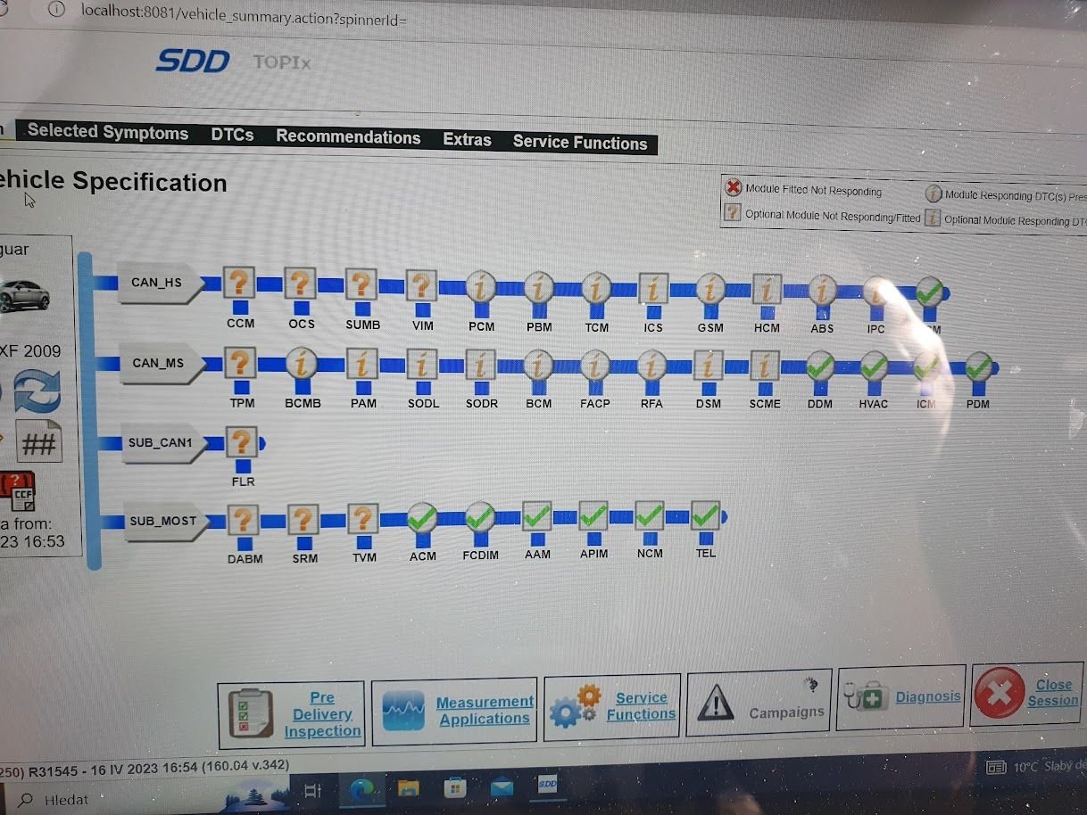

I bought the car in this condition, so I don't know its history and I don't know exactly what was found in the service. I have the car plugged into a power supply during testing and the icon in SDD is green, of course.
It can now connect to all units, probably a CAN bus problem. The errors are in the communication mainly with the instrument module, but also between other modules..

Great progress as all the red X's are gone but as Xalty says you have a bunch of modules with errors in them.
Xalty do you mean to go in and reprogram the existing modules as a if they were all new?

I didn't change any units, it gradually started to work by itself.
I'm thinking the CAN bus is the problem. Interestingly, the units at the very front of the car (lights, transmission, engine) and the units at the very back (parking assist, EPB) have the most communication errors. In SDD, the VIM (steering column lock) unit is marked as optional. But if I have a keyless car, should I have that unit or not? Also, the TPM is not reporting to me, but I'm not sure if the car is equipped with it. There are sensors on the wheels, but the wheels may not be original.
