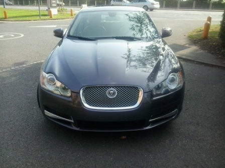

I've been lurking for a while after getting my first jaguar 6 months ago. I always coveted one having grown up within a couple of miles of Browns Lane. I've got a well cared for LHD 2008 4.2 V8 with only 70000kms on the clock. I have to say overall I'm very happy with it and surprised I haven't got any speeding tickets from the Gendarmes yet.
