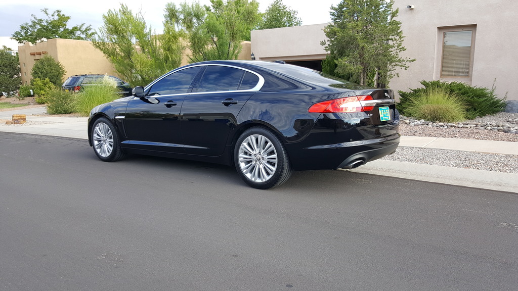

UPDATE - the TPMS set I purchased on ebay did work normally on my 2012 XF. Tire shop replaced the TPMS with the new ones shown below and I installed the wheels / tires and at no point afterwards did I get any TPMS warnings or problems. Just drove the car as normal a bit most days. Also, installed 245/45R19 Conti's all around without rubbing:

Appreciate the update - that's good to hear. I've not installed mine yet as the tyre shop wanted nearly $200 just to swap the new sensors on. So I figured I'll wait until a tyre change. For now the old ones are fine - I get that error about once every few weeks and it goes away after a while
