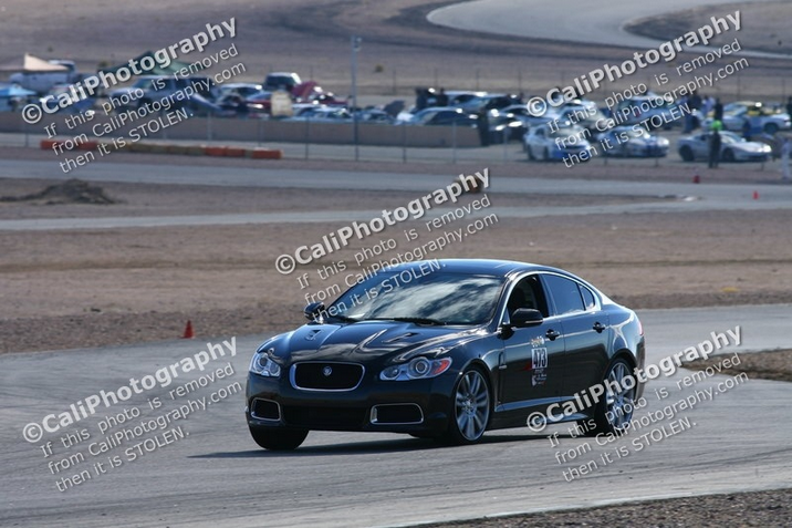

I have taken my XFR to track days. Several times in fact.
I've never adjusted much of the suspension settings and have only messed with tire pressures just a bit. While I was heavy into suspension tuning with my old Honda S2000, I feel the Jag is more entertainment rather than all out speed when it comes to track driving.
Mid-corner understeer is definitely something you'll experience with the car. This usually turns into huge oversteer on corner exit if you're generous with throttle application! As for reliability, I never experienced any E-Diff faults or DSC failures on the track even with many smokey corner exits. I have, however, experienced these issues in heavy canyon driving. Perhaps the higher speeds at the track allow for better cooling as to prevent these failures. It also helps that I usually go during the (California) winter time so ambient temperatures are in the forties.
The brakes remain strong even at the tail end of a 25 minute outing. Though the pedal travel will increase, the stopping power is not noticeably reduced in any way. It is true that the factory pads degrade rather rapidly on the track. I had to replace my relatively new set by the end of the day. The rotors held up nicely.
Trac DSC is much too intrusive for any serious track work.
In any case, it's a lot of fun to drive an XFR on the track! Just make sure you're ready to replace the entire set of tires and brake pads by day end.
