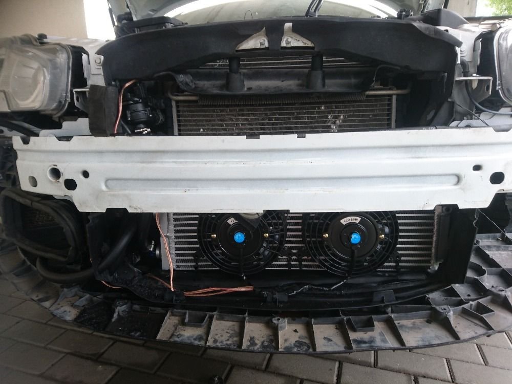

What size is that core?

ya, thats where my air for aftercooler will be coming from , lol

core size is 77cm i think, but can send specs to you, it cant be any longer, in fact if it was 5cm shorter or 2 inch , would make the houses easier to run, and higer would obstruct existig cooler more, this compromise , and will see temp changes/

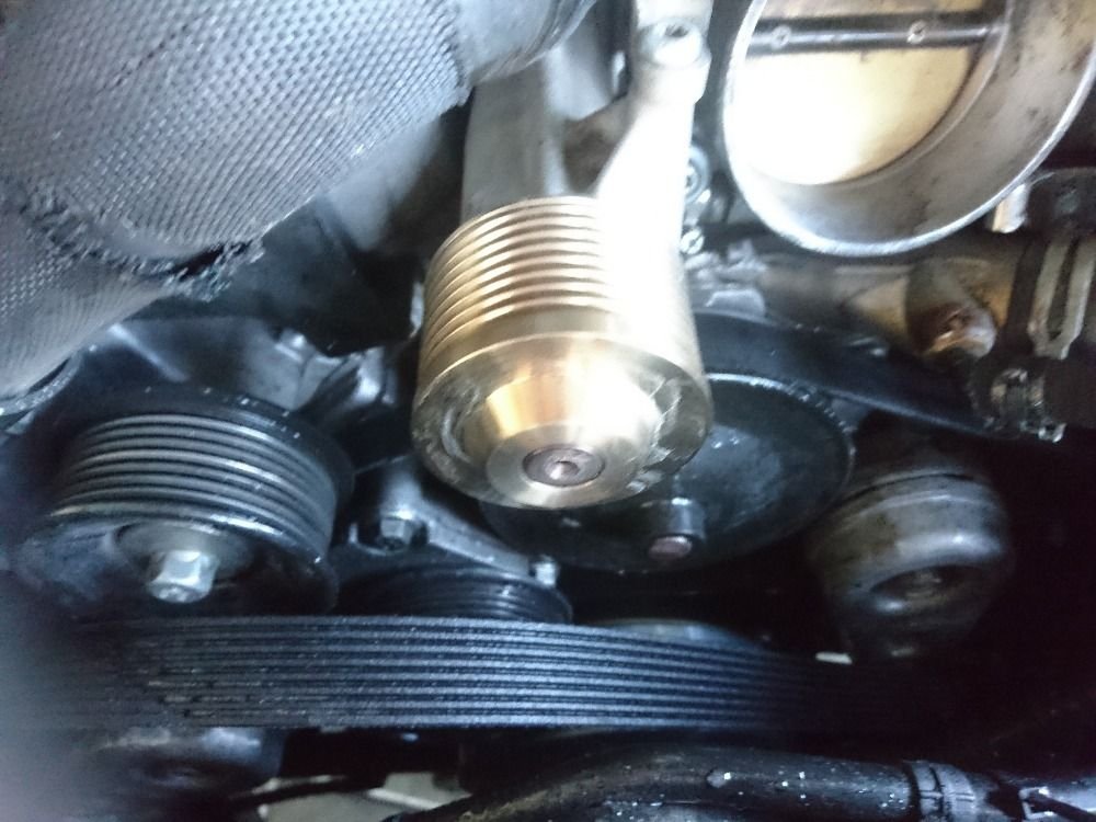

well work is Going, not allways as planed , LIKE PULLLEY REMOVAL, but done....

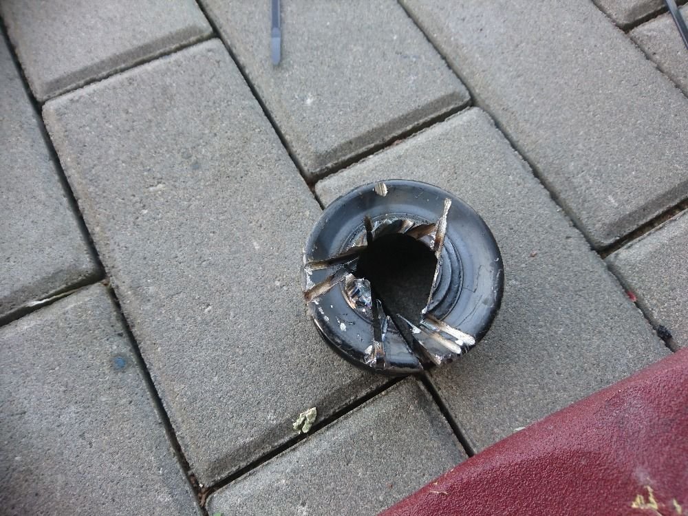

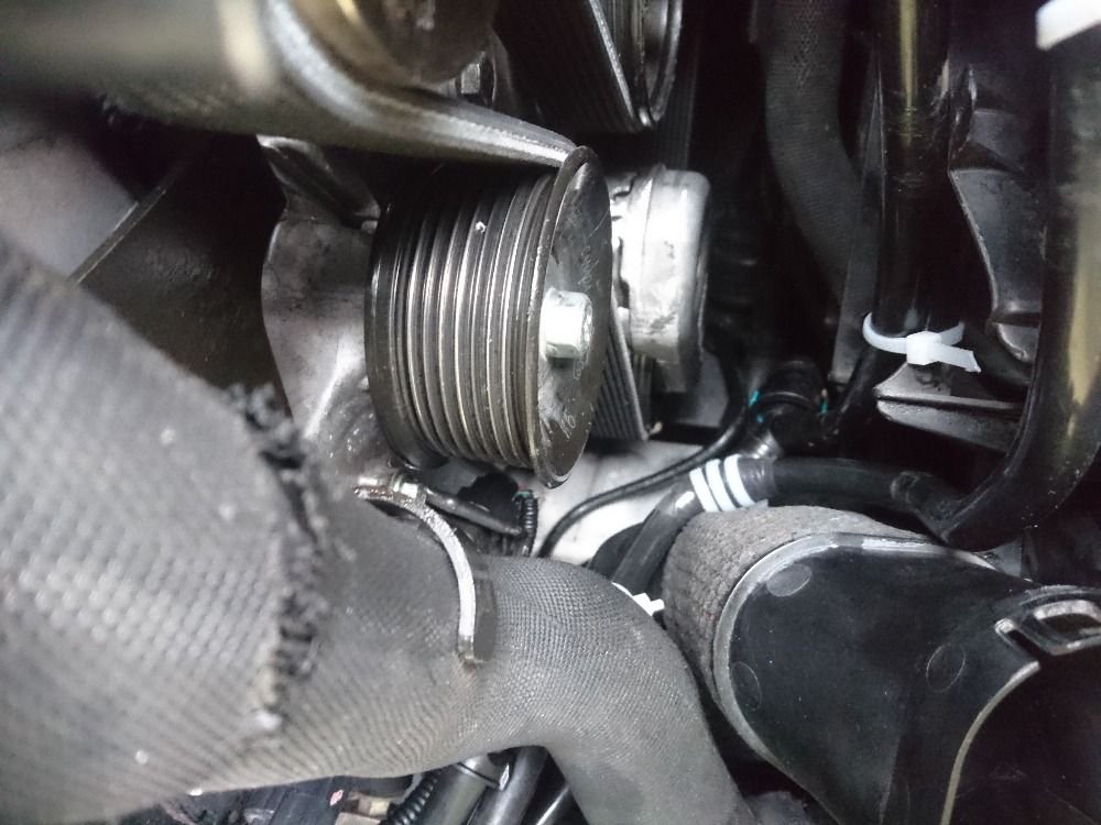

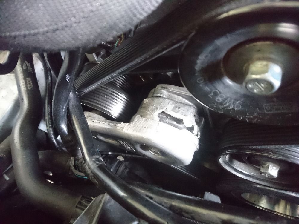

Original Belt was TOO SHORT, suplied BELT WAS TOO LONG!!! WHTF
I HAD to GRIND the Stopers on the existing tensioner to allow it to GO FURTHER, as no belt of right size can be Orderd in Czech REP.
WELL tomorow will go fer TEST.

Awesome how are you controlling the 6" fan, I cant wait to see the results.

I ran the cable to the extra cuircuilation pump and fans , to a seperate relay, which will control from a remote control, that will also control my CUT back exhoust,
but can be operated by a switch, i just see where to pun one ....

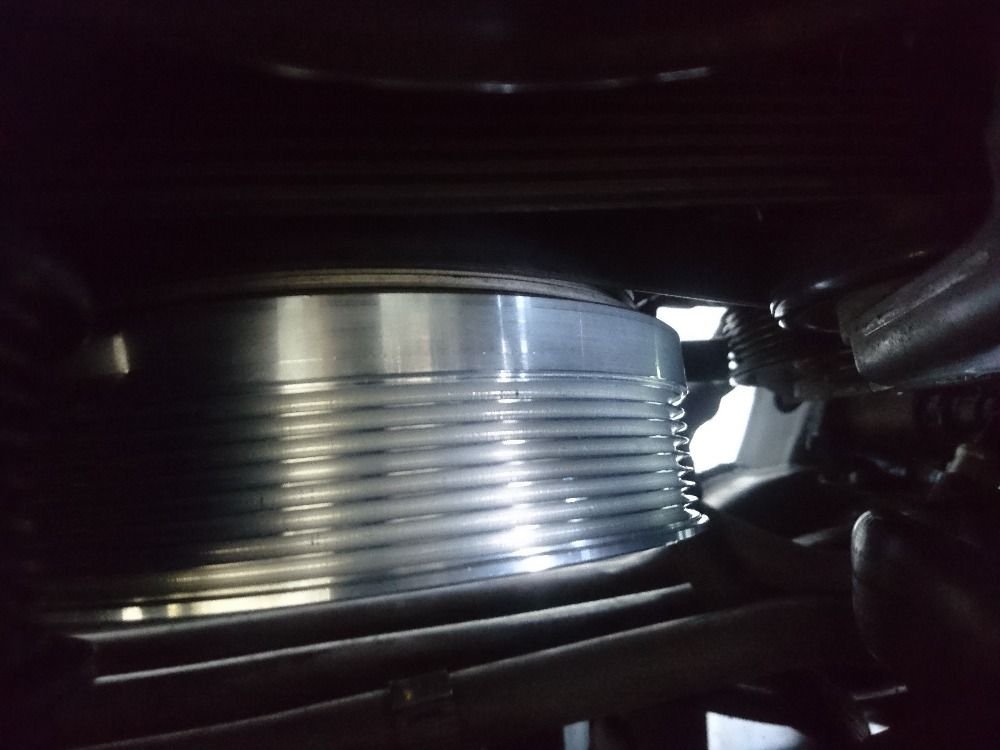

Well it wasnt , thesupercharger belt cut a litle hole in the pipe to intercooler, so was losing a litle fluid BUT MOST OF ALL, lubricatong the belt with water and G12 which is acctualy Greasy!!!!!

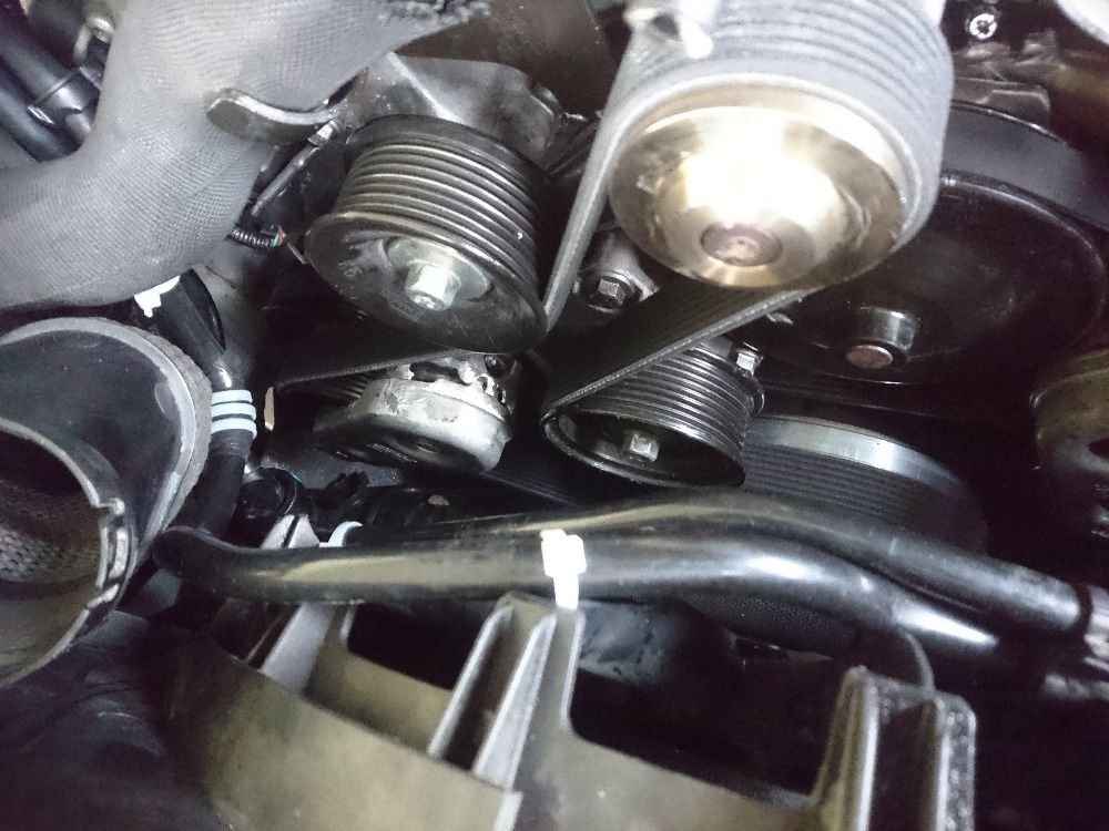

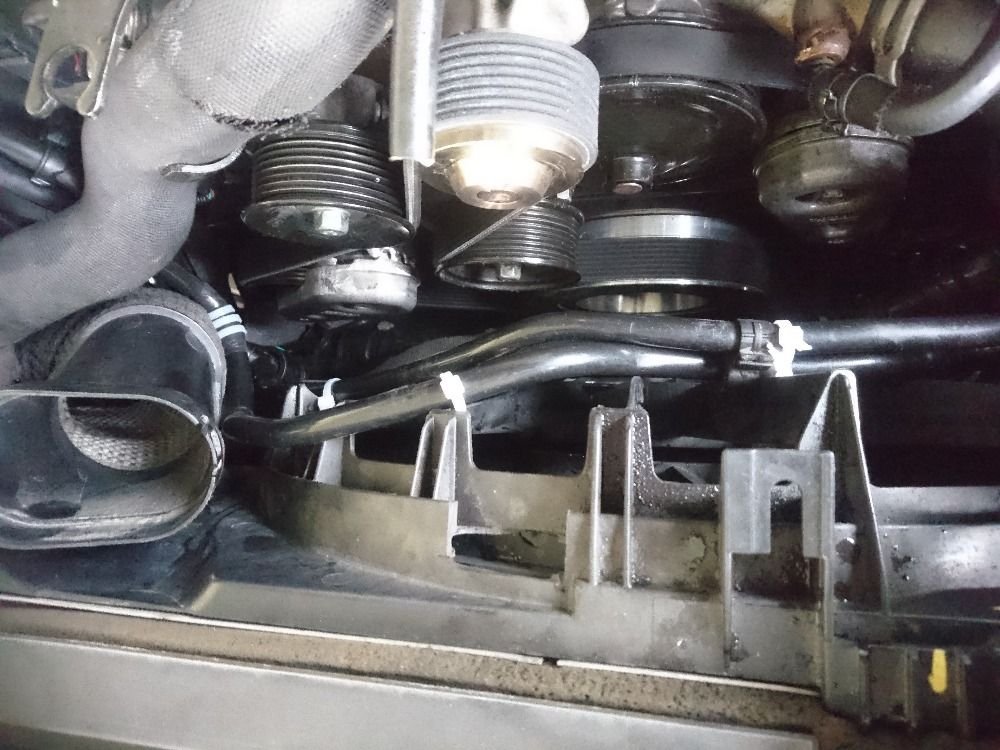

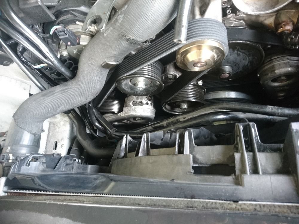

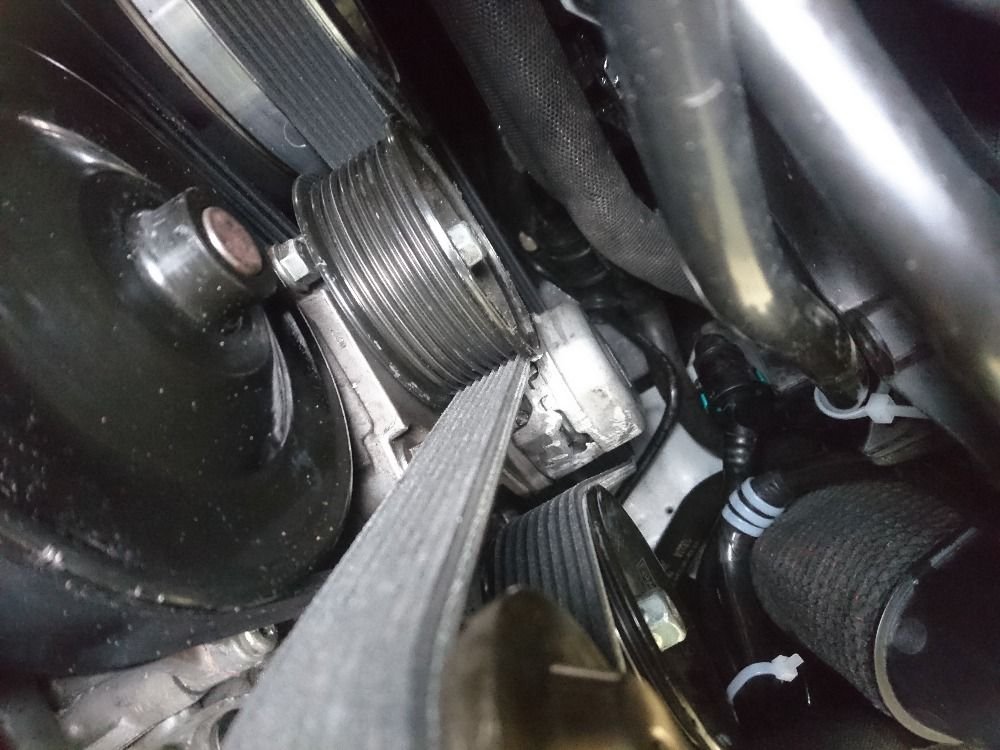

OK< fixed pipe, washed belt with detergent in shower PROPERLY, washed pulley is brake cleaner spray, and then damp cloth, rerouted the pipes,
AND THIS MIGHT BE WRONG!!!! BUT TO HELL WITH iT, I rerouted the supercharger belt, this gives it more GRIP, and is further from the houses, its close !! to the adjuster , but with the adjuster allready drilled out stopers for longer belt,
its OK<

new BELT rout

STARTED ENGINE, and ohhhhhhhh BOY, the supercharger Whine that was NEVER tehre, IS SUDENLY THERE , even on stand still just reving the ENGINE, it just revs so fast and the sound is so smoothhhhh , and superchargy , like on drift tracks ......LOL

OK, went for a drive, well what to say, i think I AM DISAPOINTED FOR NOW, yes the car is fast, but it was fast, I BELIEVE in NUMBERS, and my speed at 100m , is still the same, ....... this could be due the traction control limiting the exess power. MAYBE,
BUT dont seem to notice much higher BOOST , still 7-9 psi, ,
did notice a funny thing in the morning, while hitting 6250RPM, and the gear changing the boost for split second jumped to 11 psi, ,??? but later on no,
also noticed that around 130MPH + at close to 6000 rpm, the BOOST starts droping, ???? could the carger be maxed out, could the belt be sliping???

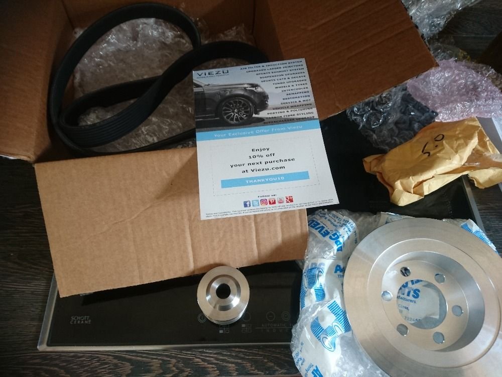

Did find out yeasterday that I have some belt sliping , when HOT, THATS WHY LOOSING BOOST, getting new belt and tensioner tomorrow hopefully and will see.
Also found I have RSV 1900 CHARGER, NOT Eaton M 112, as I though , lol ��
