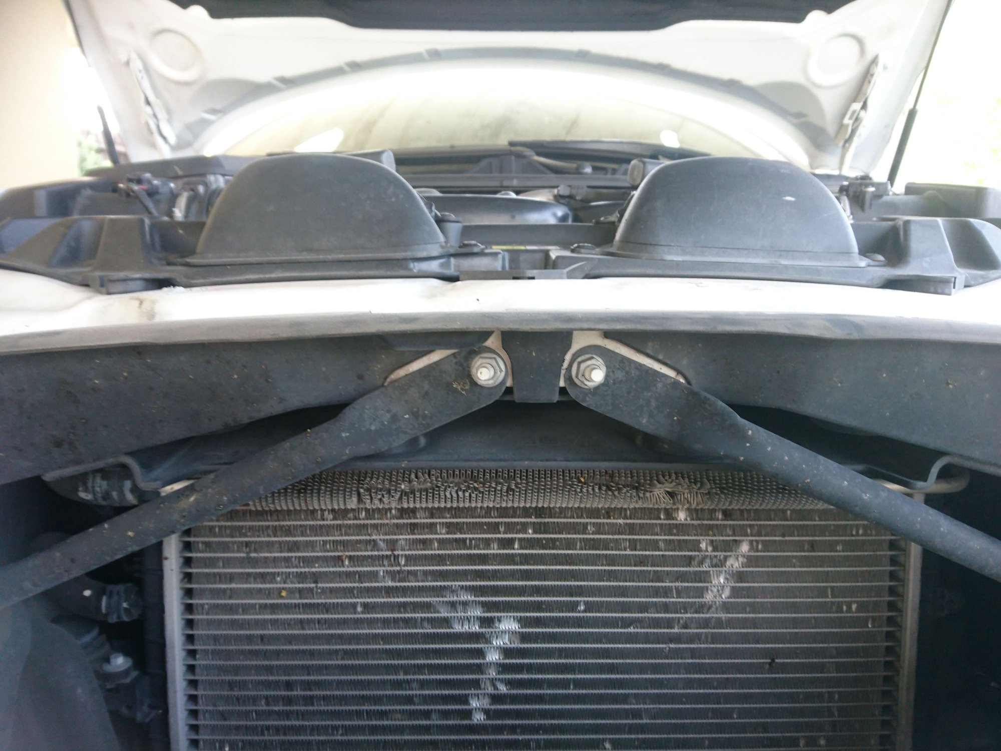

i will add an extra intecooler for the supercahrger , in front of Main radiator instead of the AC radiator, as my AC not working anyway LOL

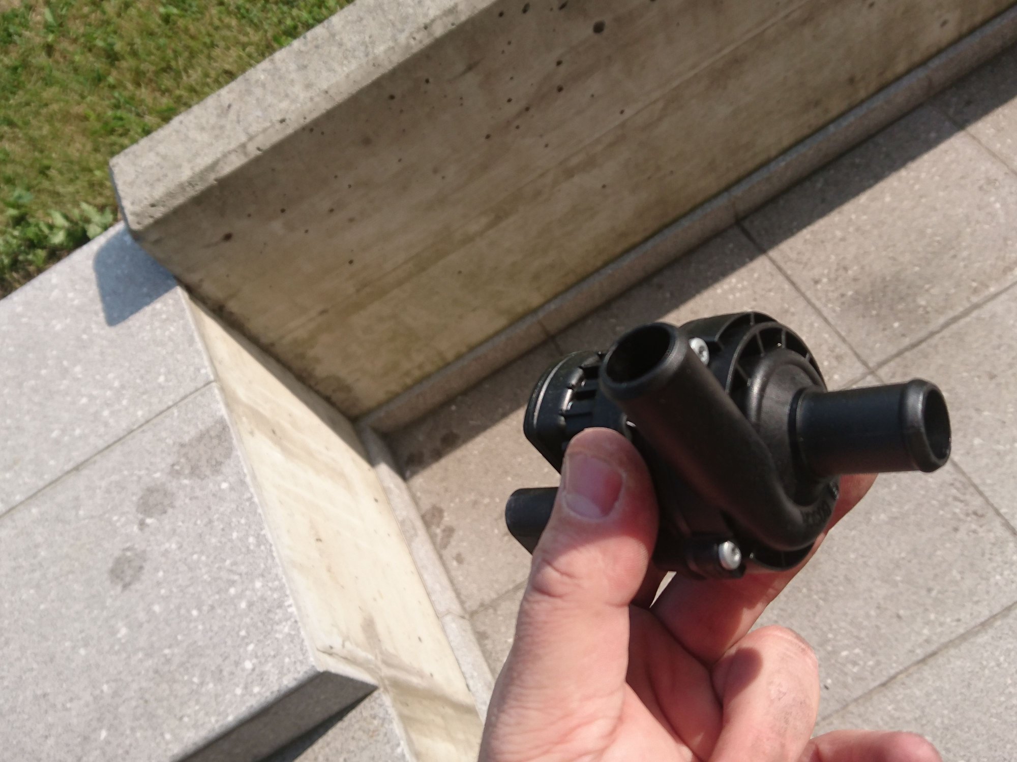

also will add a BOSH elecktric wter cuirckulation pump to the intercooling system,

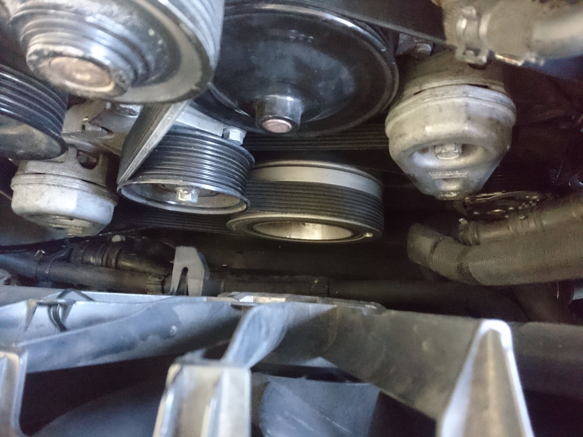

Has anyone here actually done upper and lower pulley together? I think I only found one person who did the lower pulley alone and he said the car was a complete animal. I am also doing research on the additional cooler inline, there is room for one even with the ac. you can also add 2 small fans to them that operate of a temp sensor or run with the pump.

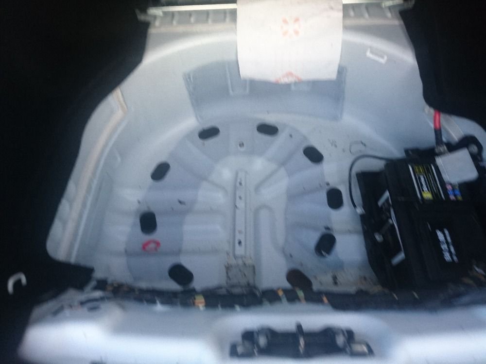

OK, started sheding the weight in the Back,, know its not the best place, but easy, lol, got rid of the boot floor and the boot base speaker, the sound still good, !! and about 20KG gone, put ina smaller battery as well,
i will post picks soon, .....

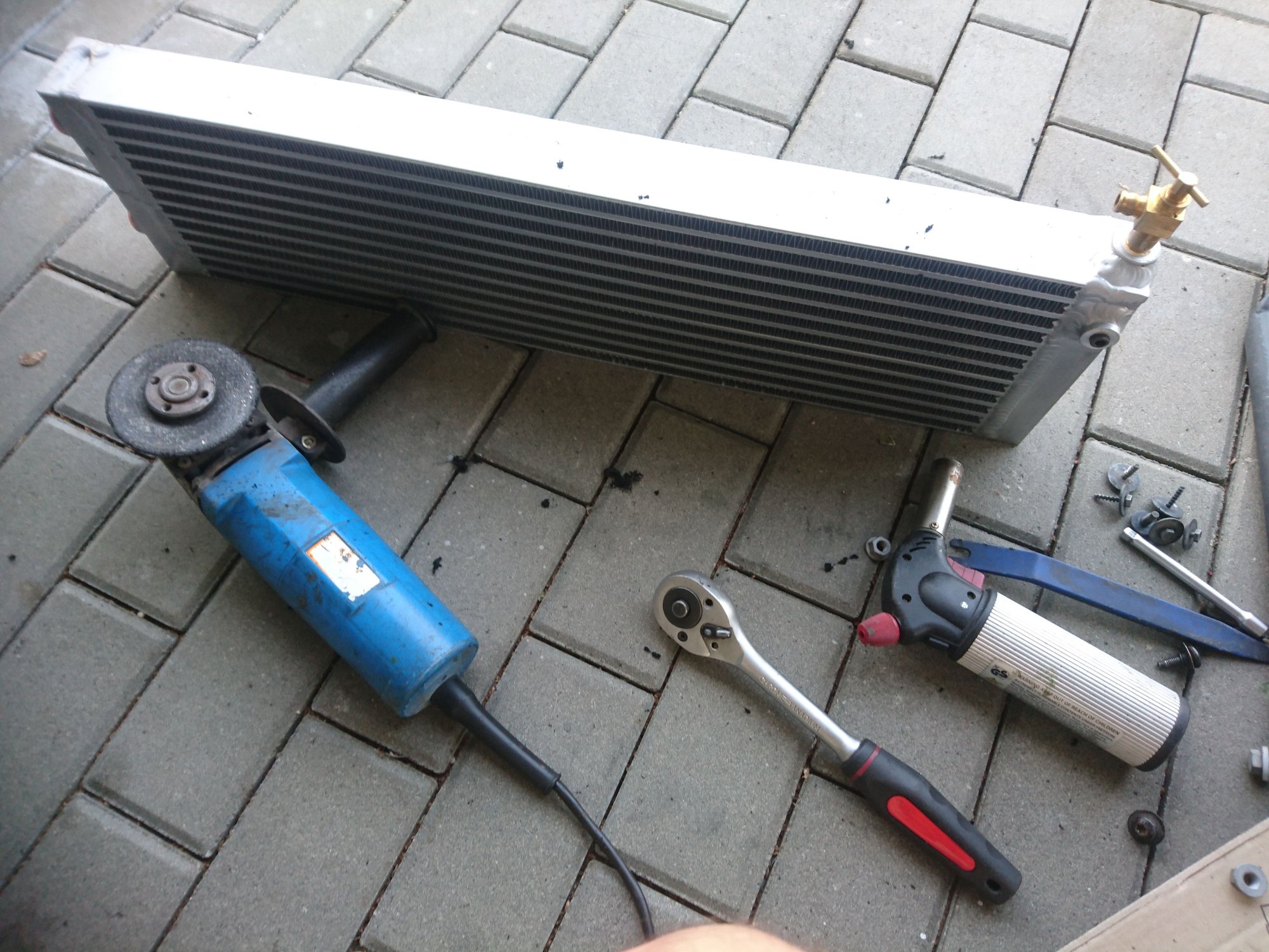

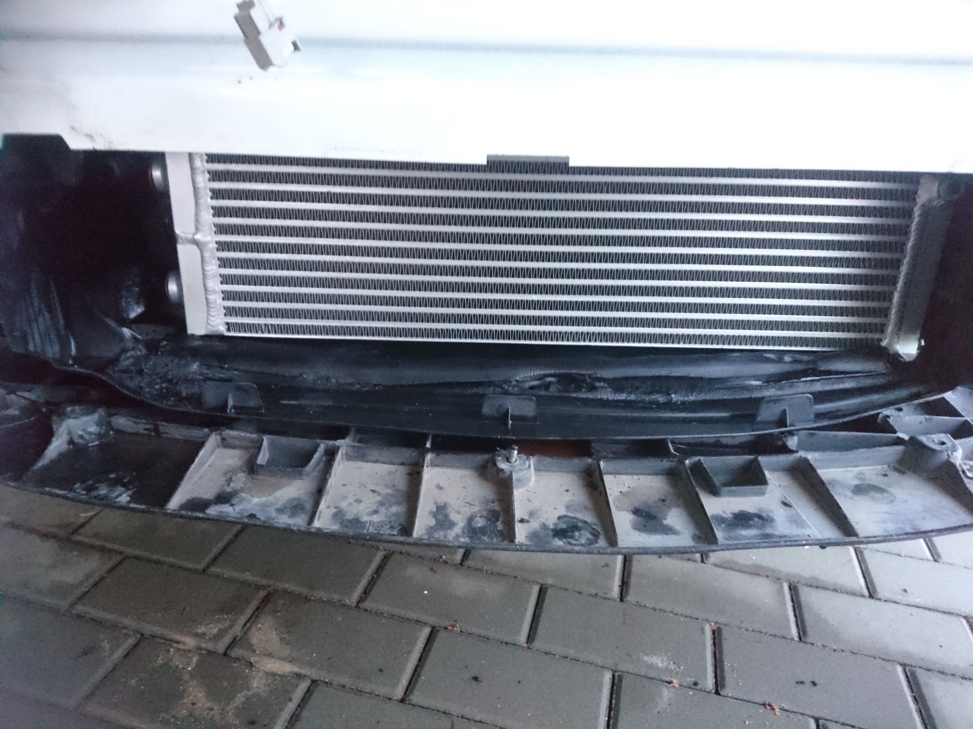

also starting to make preperations on increesing the intercooling capacity, I see no point in swithcing the original cooler for a litle better one for 1500USD, when i can just fit a universal one as addition , !! and will be more eficient and will set me back around 400USD , and 100USD for pump.
https://www.highperformanceparts.cz/...rpadlo+do+auta
something like this , I think 16L A min, should be ok,

https://www.highperformanceparts.cz/...v-115lm.122455
or this pump is 115 L /min
but might be too fast and too much curent draw

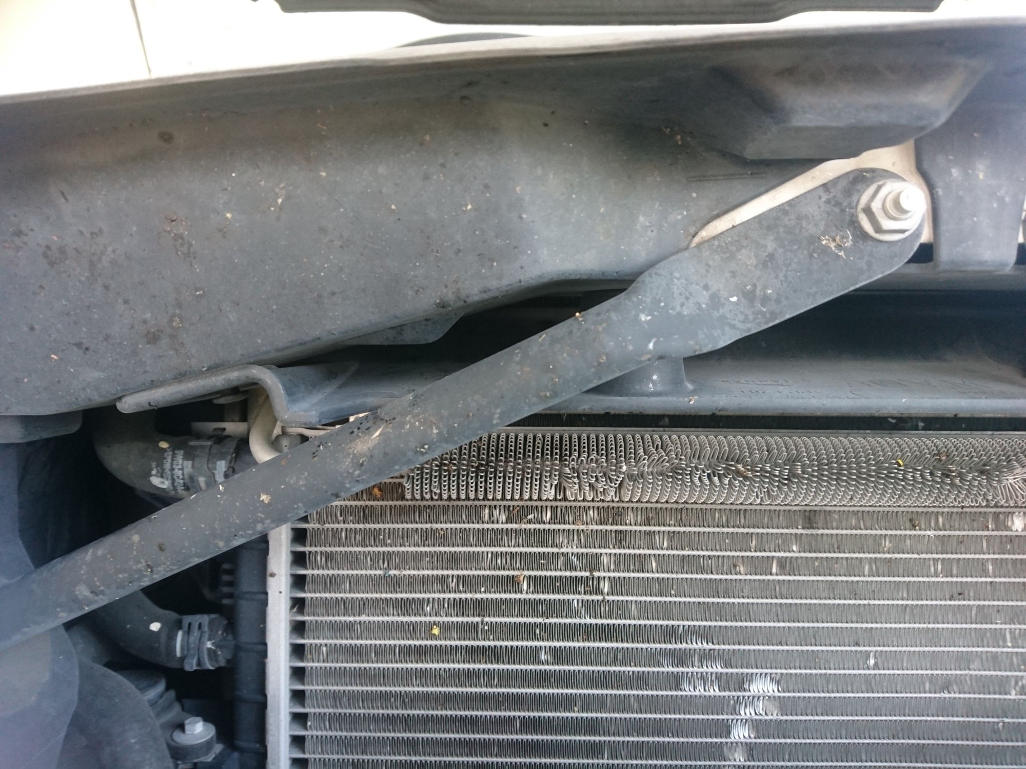

For the inline heat exchanger this is all I could find
https://www.jaguarforums.com/forum/x...-grill-197192/
https://www.jaguarforums.com/forum/x...r-loop-194915/
I pmed the author and he gave me this info on the core he picked [24"x3.5"x3.5"] "That one is about 4-6" too long. I either have to trim part of the sub frame, where the 2 eyelets are behind the front bumper, for it to fit, or get one that is not as long"
As soon as I have some time from work I will take the bumper off and measure to fit a core in the bottom or top and fabricate some brackets and go with the benz pump. I would also like to do some datalogging to see the difference in cooling before upgrading the pulleys.
I too do plan on doing both upper and lower.

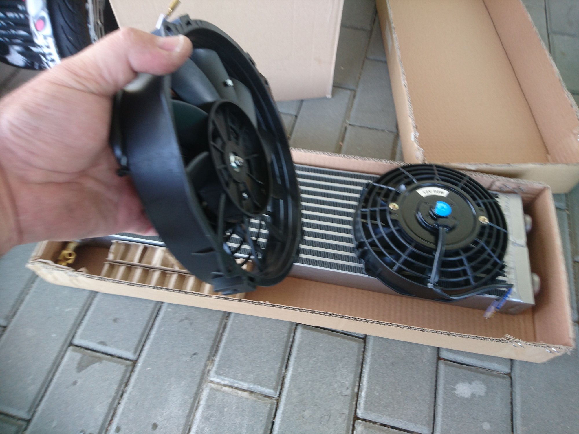

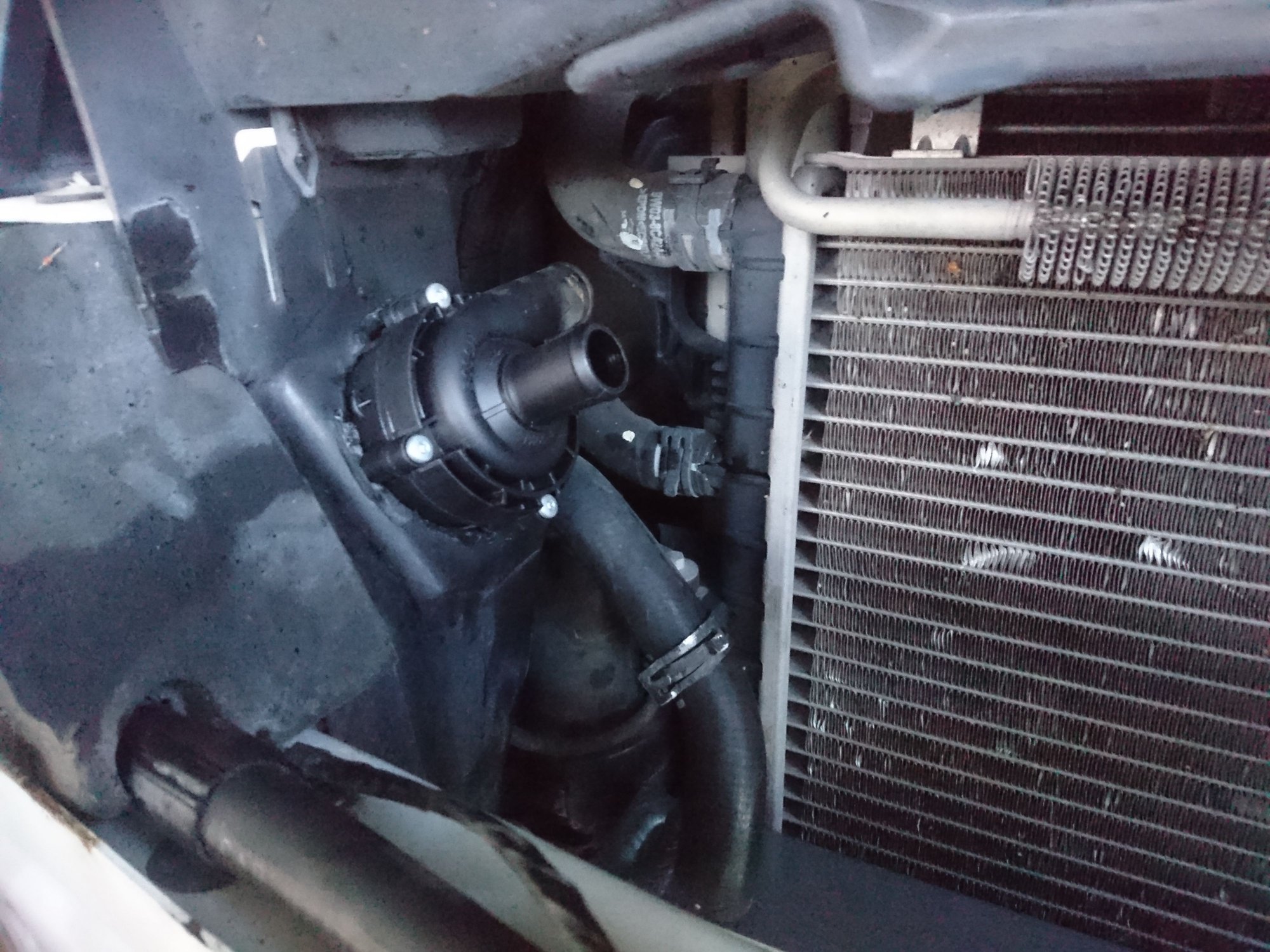

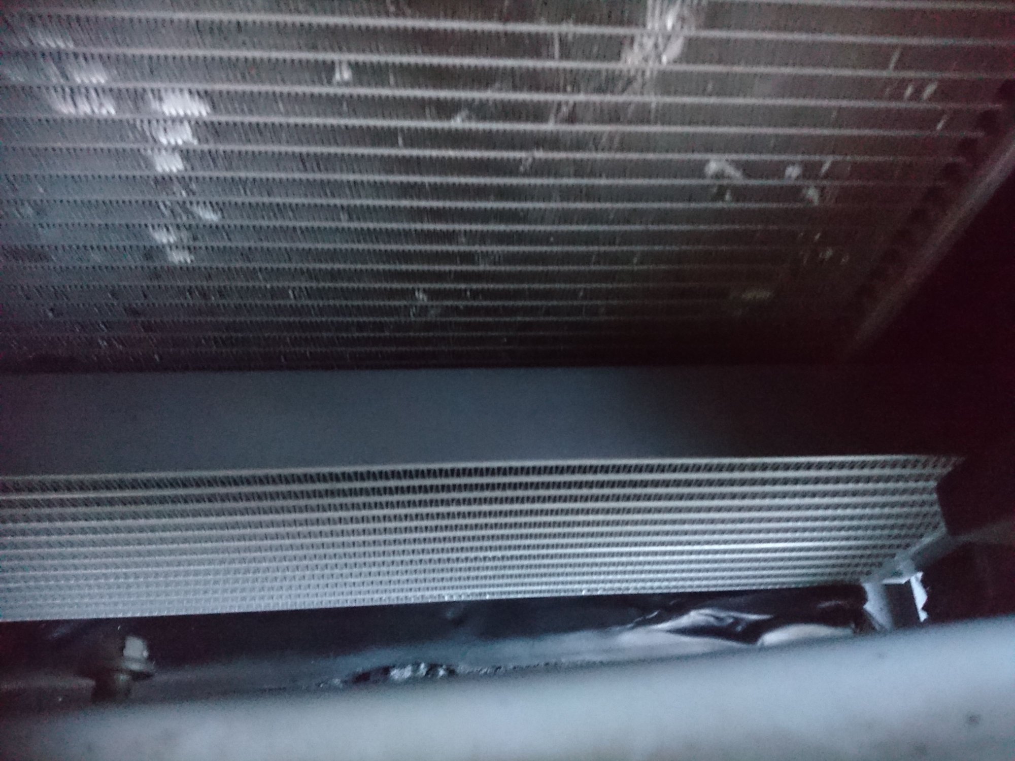

my cooler , pump, fans and hoses are on the way, will provide picks once it comes in,
just making arangments for the puleys , up and down,
i will try making sure the intercoolers are as cold as posible, this is what the meth injection does, cool the air, this way dont need to keep depending on the meth water mix,
curently running max 0.65Bar boost even at 150mph, so also thinking of redoing the intake on the forced inductionl......
will post picks of that also.
