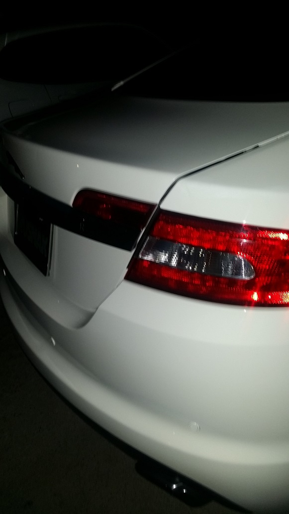

Here is the trunk after a minute of the bass hitting this is what it looks like .... someone has to have a solution to this problem even my guy who does the best work in the area said hes never seen any car ever do this ... i dont think hes installed anything on an XJ before .... should i buy a new latch? anyone have any Mcgyver tricks they can think about.... it just need a little hold i was thinking velcro but i dont know......

Old May 10, 2015 | 11:10 PM
OzXFR's Avatar
Posts: 9,036
Likes: 3,667
You might be right about Velcro, just not in the way you think!
On my old XFS the trunk (boot) lid had about 1/2'' of movement when fully shut.
It stayed properly shut, but it still 'wobbled' up and down if I pressed on it, and it rattled a bit.
I fixed this by sticking a small piece of Velcro to each of the little plastic spring loaded tabs (the ones that sit a couple of inches either side of the U shaped central latch/hook).
This completely stopped all movement and it just might be enough to stop your truck lid from flexing and popping.
But the little bits of Velcro didn't stay put I superglued them in place.
