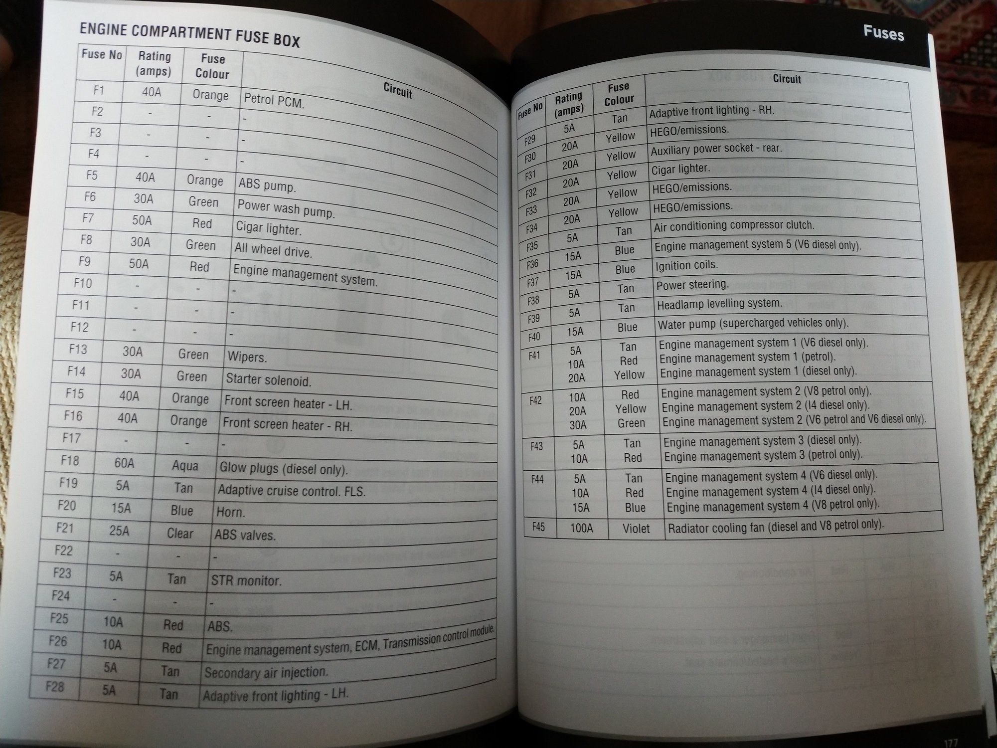

Hello,
I've been replacing the interior lights with LEDs all week (looks very good so far) and I've come to the vanity mirrors. I've read all the threads I can find, got together as much advice as possible (including: don't bother, not worth it) but I just can't stand them being a different colour... So I've had a go and think I've blown a fuse.
My manual fuse diagram matches the car but there doesn't seem to be an "interior lighting" fuse listed. Am I being stupid? Any advice on where to look would be appreciated, as I don't fancy removing every fuse to find the duff one...
2014 3.0d Sportbrake, RHD (if that makes any difference).
TIA, Josh
