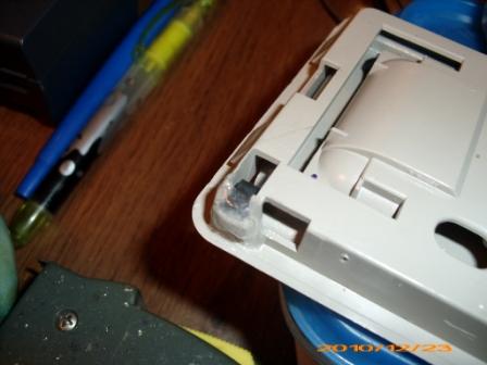

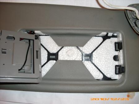

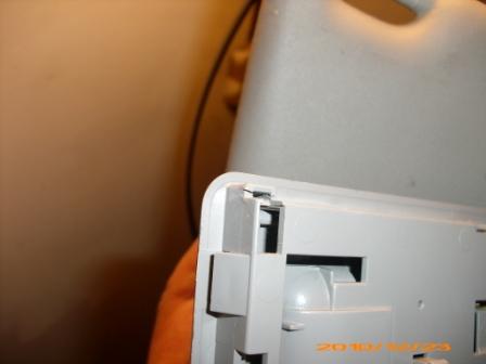

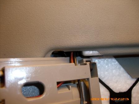

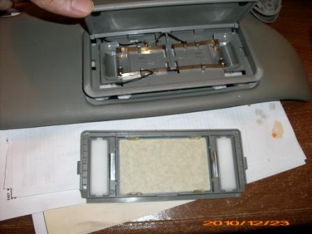

Default the same problem and fixed it.
I used Versachem's 60 sec epoxy. press out 1/2" long glue and mixed them within one minute and used a small screwdriver to drop down the glue into those two holes and then press down two u-shape clips. waited one hour for drying and then one more time mixing the epoxy glue and filled up to the top level as seen on the picture. then waited another hour and then put it into a refrigerator to freeze it for 36 minutes. when taking out, I felt it hardened much more. good result and I flop it up and down. no problem. it is done. put them back and connected those two wires with a solder gun. you don't have to uninstall the whole visor from your car. the 2 middle clips of the mirror set can be pried out without damage.
